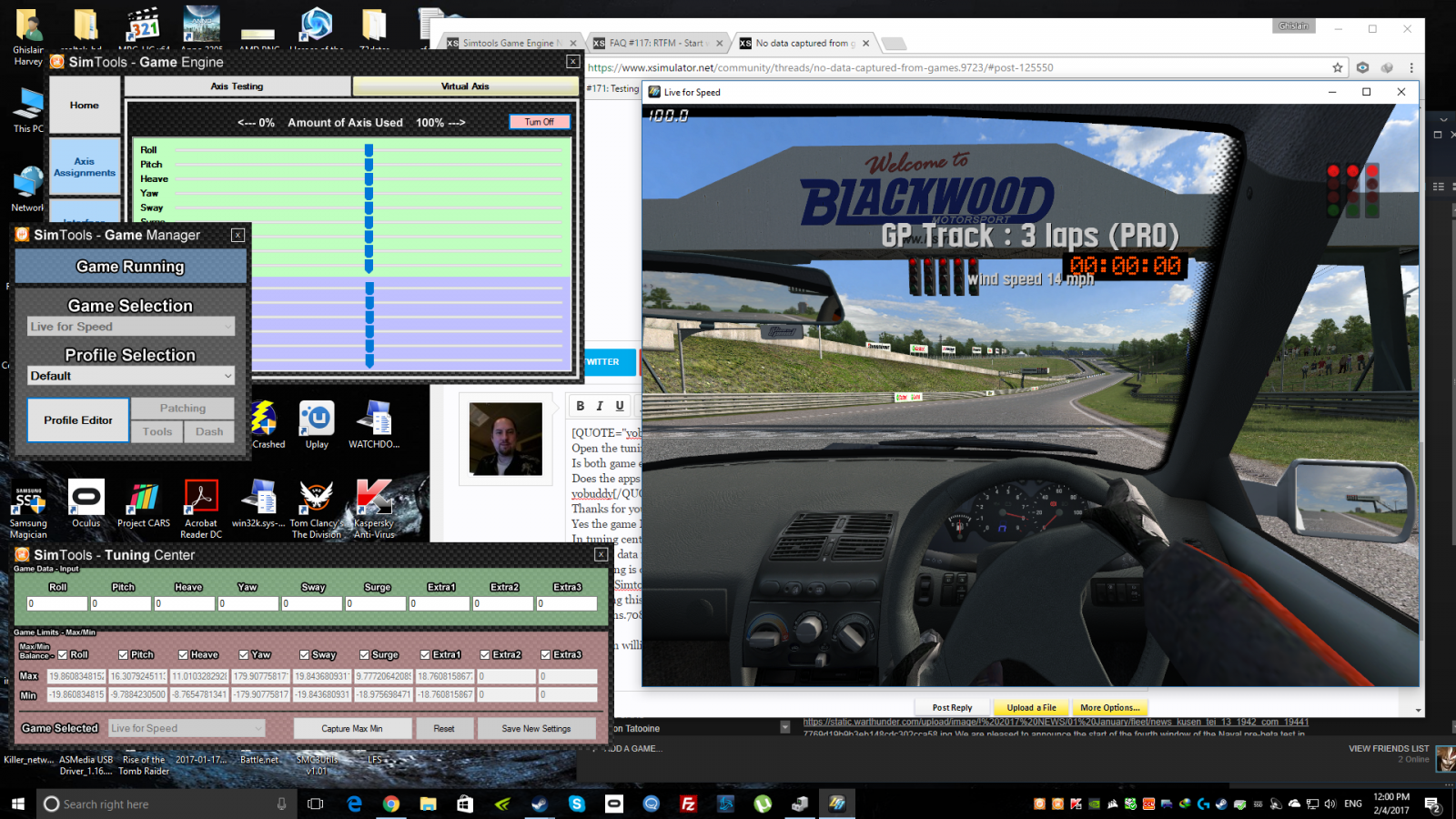

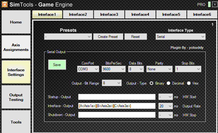

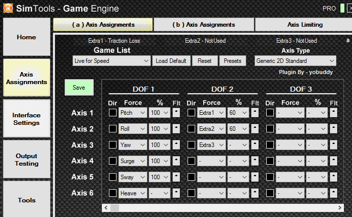

    What I'm trying to do is capturing game data from Live for Speed for testing.
    I have Simtools 2.0 Pro license.
    I have an Arduino Uno R3 with SMC3
    I dont have any motors yet, im only on the testing phase.
    I only want to see if Simstool can capture the game data and so far it doesnt work.
    How must I configure?
    See the screenshot of what I have so far.
    The game is a fresh installed and is patched with simtools.
    Thanks for your help.

    Hi @Wagnard,
    Open the tuning window in game engine to see the raw game data flowing in. (its easier to what's happening here)
    Is both game engine and manager installed on a single PC?
    Does the apps turn blue when you launch the game?

    Thanks for your reply.
    Yes the game Manager turn blue.
    In tuning center I can see the game limits being entered automatically.
    All game data in Tuning Center stay at 0.
    Everything is on the same computer.
    I did try Simtools 1.3 with the same results.
    I try using this configuration (https://www.xsimulator.net/community/threads/game-engine-exceptions.7080/#post-82208) without success.
    Note: I'm willing to give my computer control over teamviewer if necessary.

    I was able to fix it, I must run the game once Before patching.
    then quit the game, patch it and run again
    Thanks for your time
