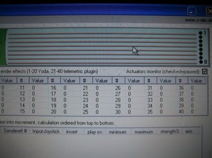

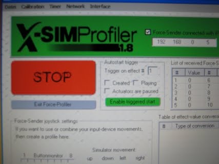

    These are the steps i have followed
    1º copy the plugin in the Rfactor/plugins
    2º start force-sender / select the Rfactor plugin / press send
    3º press start on the force profiler
    it does not matter in the effects from 21 to 40. Am I doing something wrong?
    [​IMG][​IMG]
  10. egoexpress
    egoexpress Active Member
    Dec 13, 2006
    3,839
    Germany - Frankfurt/M
    421Coins
    +7 / 1 / -0
    Yes, It is that one. It has to be set on enable!

    Hi to all
    Sorry I'm very stupid, instead of copying the xsimplugin.dll in the folder plugin rFactor, had copied Rfactorplugin.dll, a grave mistake thank you very much for the help.
    Try not to repeat these mistakes.
