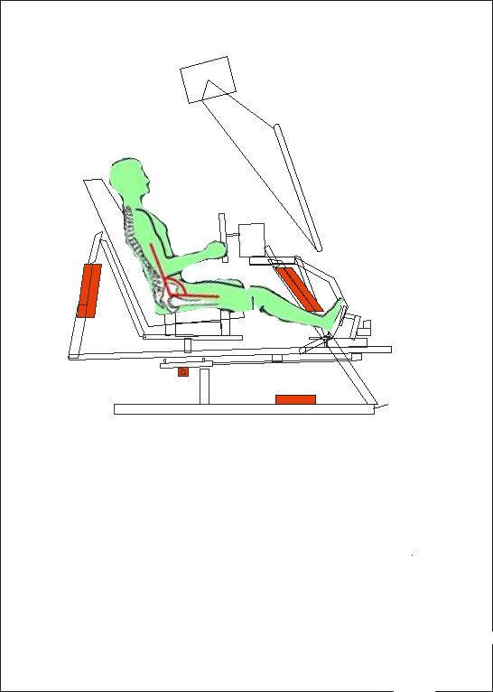

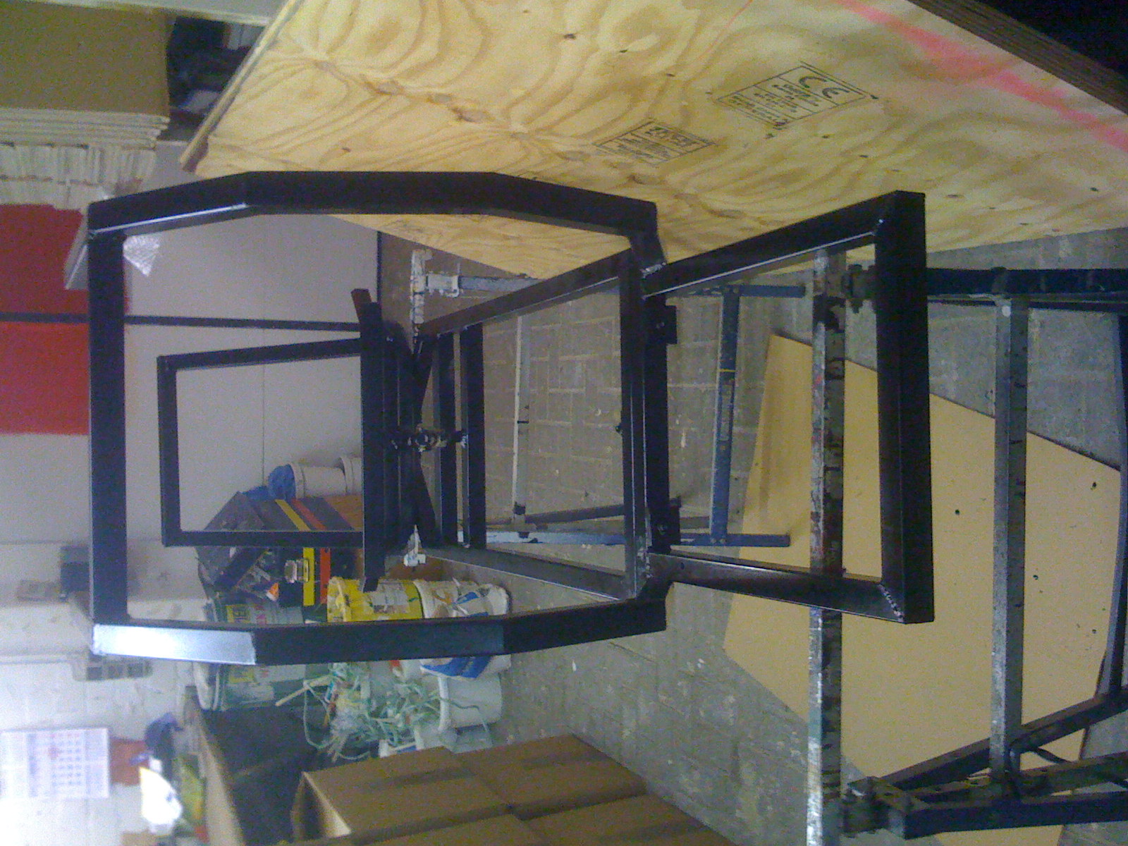

    in 2-3 week i have beend the building from my new sim.
    here i first drawing

  5. ledfoot
    ledfoot Member
    Sep 9, 2009
    369
    IT Manager
    Toronto, Canada
    21Coins
    Re: Nima's 6 DOF Simdesign
    Nice design Niels,
    It doesn't look like the screen will be attached in this diagram....

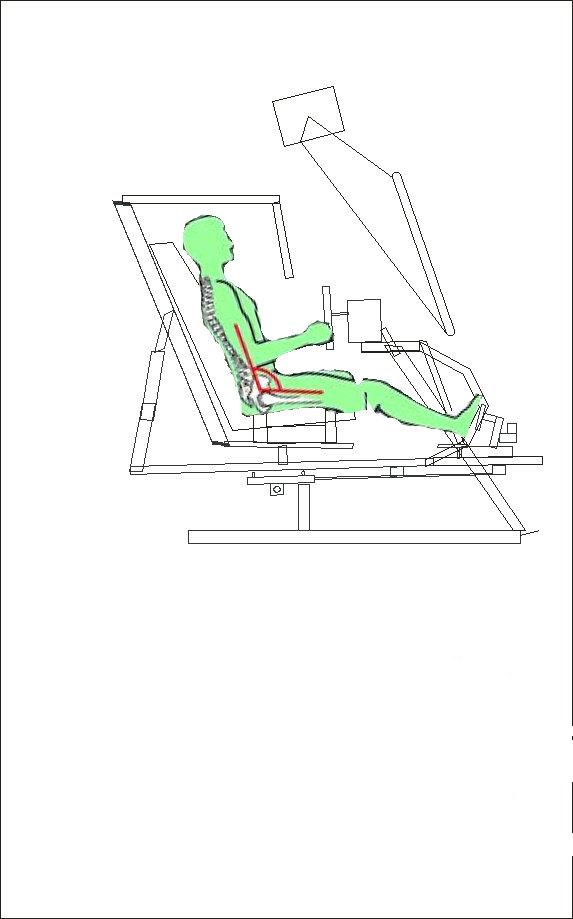

  6. Nima
    Nima Member Gold Contributor
    Nov 8, 2006
    413
    Glaser
    Bad Zwischenahn
    529Coins
    Hi
    i have make a new drawing
  7. ledfoot
    ledfoot Member
    Sep 9, 2009
    369
    IT Manager
    Toronto, Canada
    21Coins
    LOL. I think we were posting at the same time. I see it now :).
  8. bvillersjr
    bvillersjr Active Member
    Oct 11, 2008
    1,174
    Ohio, USA
    437Coins
    +22 / 1 / -0
    Brilliant!

    now my new sim are working.i have many testet and tweak.i can make many thinks better but the feeling is now with only 4 axis many better as befor.is many more realistik now,but i have see many thinks were i can make better.i have see if you only tweak the degree on the scn5 1inch you don't can drive the same profil.
    in the next time i make pictures.now i not have the best profil and the feeling is better as with my old sim.

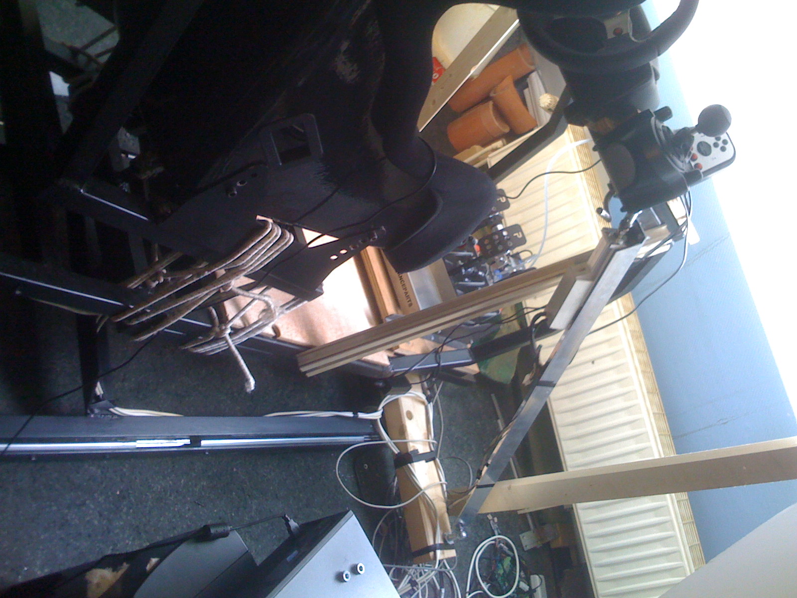

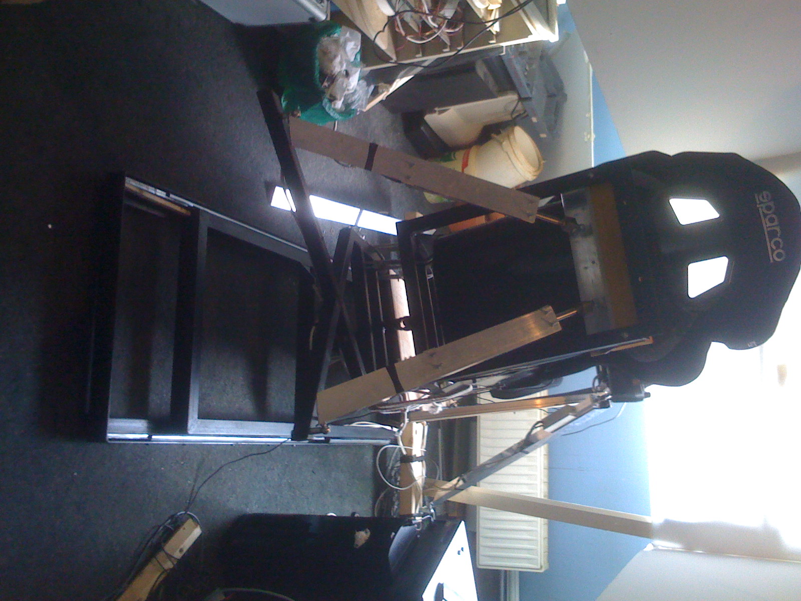

  12. Nima
    Nov 8, 2006
    413
    Glaser
    Bad Zwischenahn
    529Coins

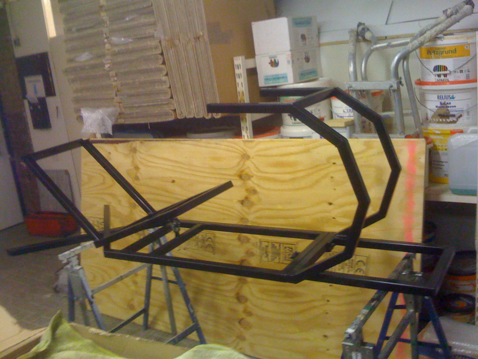

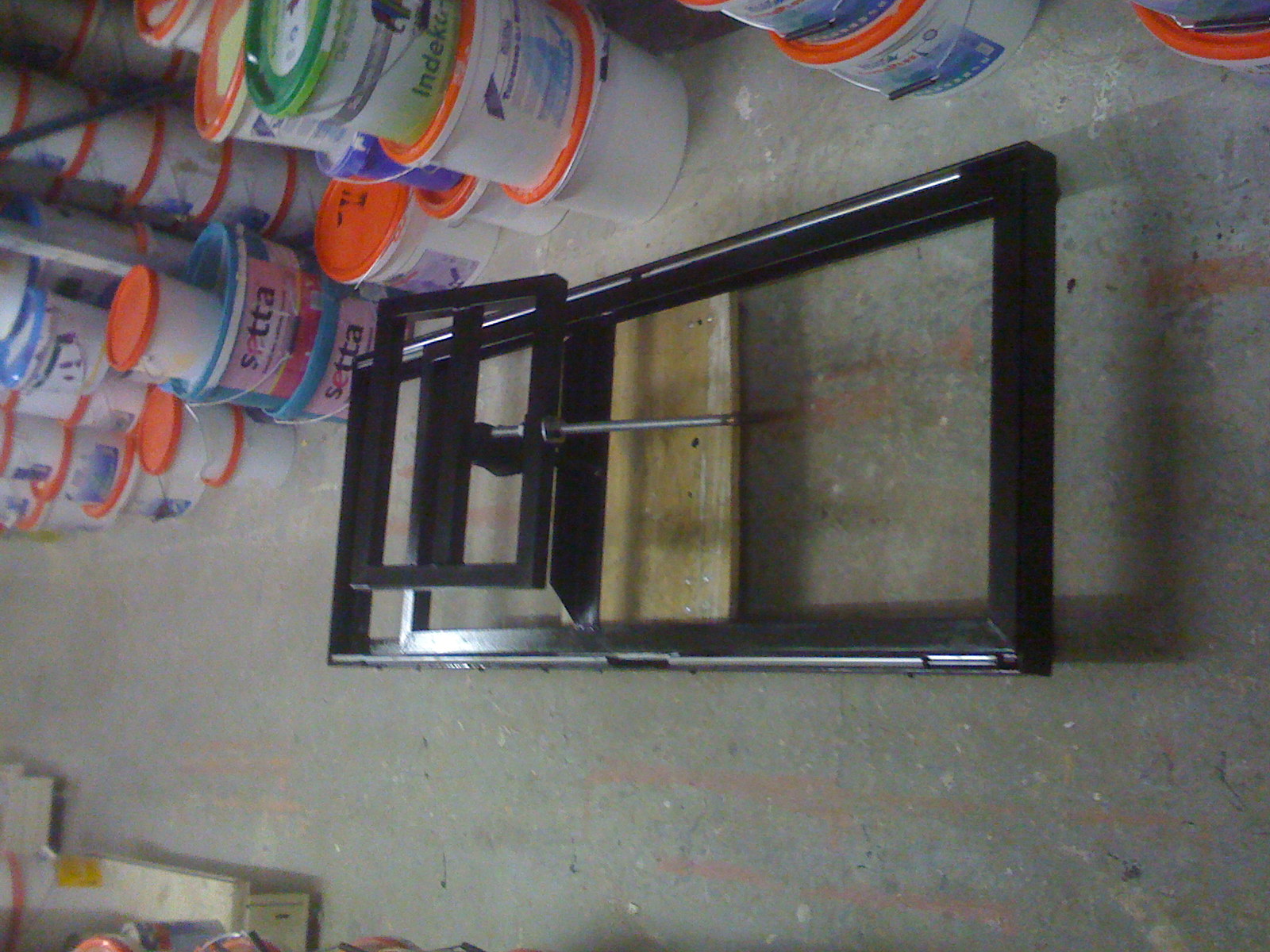

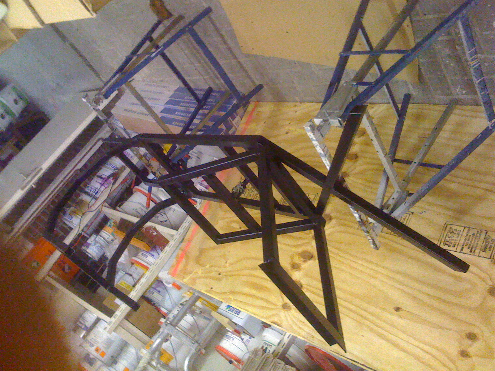

    hi
    here the first pictures.but the front sektion is to hard for the scn5.1 scn5 is broken.i make a other trade for this problem.if i have a big crash in the play the breakmoment for the scn5 is to mutch.
    befor i have many many fun with the new sim.

  15. Nima
    Nov 8, 2006
    413
    Glaser
    Bad Zwischenahn
    529Coins
    so now i have make rubberbands on my sim and have tested 2 houers on full speed
    the sim are working so nice.i love it so mutch

  19. bvillersjr
    Oct 11, 2008
    1,174
    Ohio, USA
    437Coins
    +22 / 1 / -0
    Hi Niels,
    I'm glad to hear that you are happy with your sim. How many rubber bands or bungee cords are required to make this work? I'm guessing that these are helping to make the SCN5's attain something nearer to 400mm/sec even though the load is increased?
    Also, I must say for the record, that designing a simulator that breaks actuators when you crash is bit extreme. If I broke an actuator everytime I crashed learning a new track I would be bankrupt :lol:
  20. Nima
    Nov 8, 2006
    413
    Glaser
    Bad Zwischenahn
    529Coins
    hi bernard,
    i have many rubberbands now but i want more i have order 30 m again.
    now is the crash feeling a littel lower but save.if i drive a new track i use a other
    profil.the repair have only cost 5 euro.i mean the problem is the place were are broken wars not correct befor now i don't can have the same problem on this scn5.the place were are broke is now more as 10x stronger as the pin.if you have to many work on the scn5 the pin mast broke.
