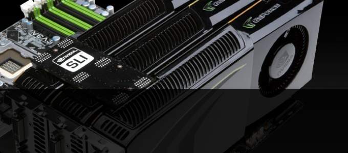

    Hi all
    I have a PC with a NVIDIA GeForce GT 640 and dual screen. NFS HP works fine on that.
    The PC for my motion platform however has a 2×GTX-560 Ti 448 SLI with tripple-screen.
    On this PC the game doesn't work, i.e. the graphics is messed up.
    I have tried turning two screens off, turning SLI off, enabling CPU only – no luck :(
    Anyone a trick to make it work?

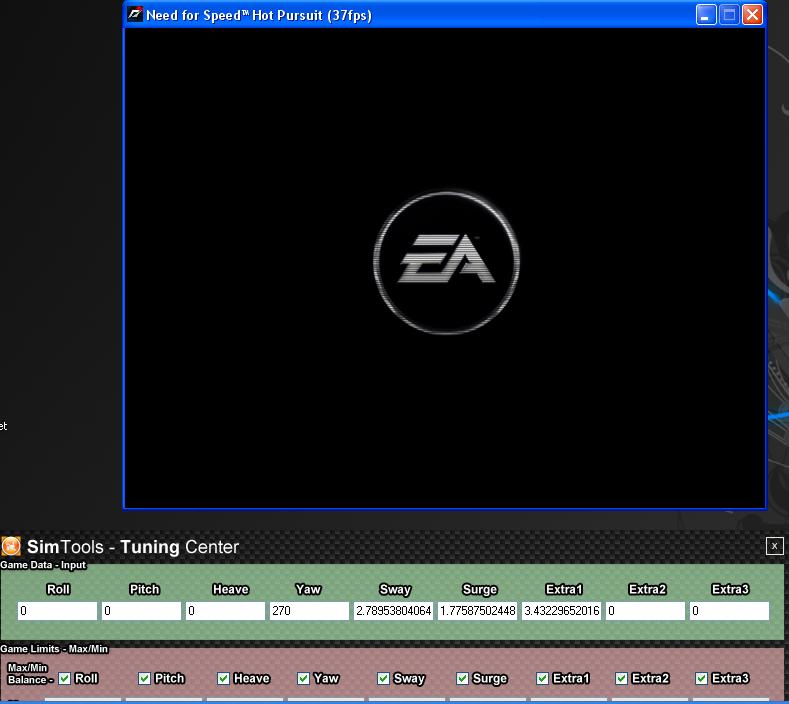

    I tested NFS Hot Pursuit on window xp. When you turn on the game I got no clear data. During the trip, the data do not change.

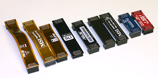

    Thanks for your help! Yes, I'm using the internal SLI bridge and I don't want to remove a graphics card to play NSF HP on the motion platform. From what I see on youtube and other forums, it is possible to run NFS:HP in triple screen mode. I'll investigate more…

    @bsft ... It is working fine with me except some low performance in my computer ... every thing is the same as you have ... check If you have axis and output settings are selected .
    It worked with me from the first time ...
    First, How can I make it run in "window mode" so I can video record it with SimTools ?
    it seems not recording the game in full screen view ... But numbers are bouncing in the SimTools ... I'm using screen video capture recording .
    Me too a C**cked version ,updated to 1.0.5.0 , plugin installed , game selected and patched , axes and output preset is selected and "SAVED" , game is running ,numbers are bouncing in the tuning center ... but my computer gives me low performance

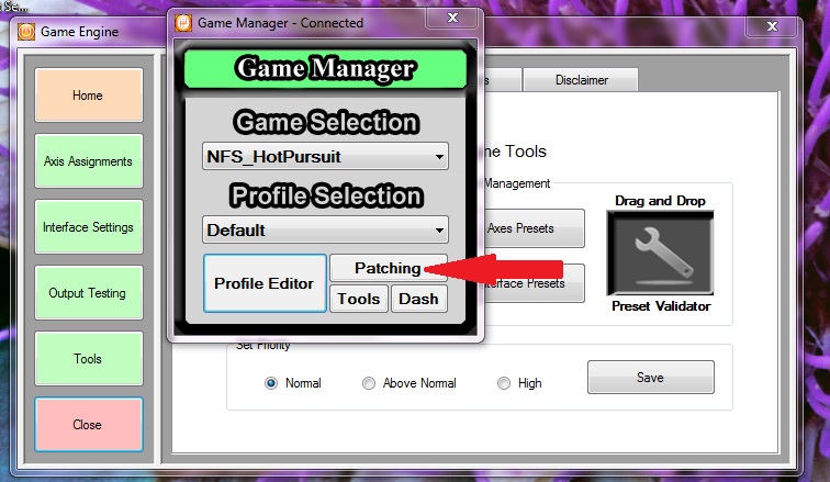

    First the game version updater is automatically assigned me the 1.0.5.0 update and did every thing by itself ...
    after that Do use GamePlugin updater program normally "Drag and drop the zip file of the game downloaded plugin ..
    Then Run Game Engine, and Run Game Manager and look for its task bar small square Icon ... double click it to open the Game Manager itself ... with the green back ground as connected to game engine >>> you know that ???
    Patching the NFS for motion select it in Game selection, and select this folder into in the Patching button ...
    C:\program files\Electronic arts\Need for speed(TM) Hot Pursuit
    where the NFS11.exe file is ...

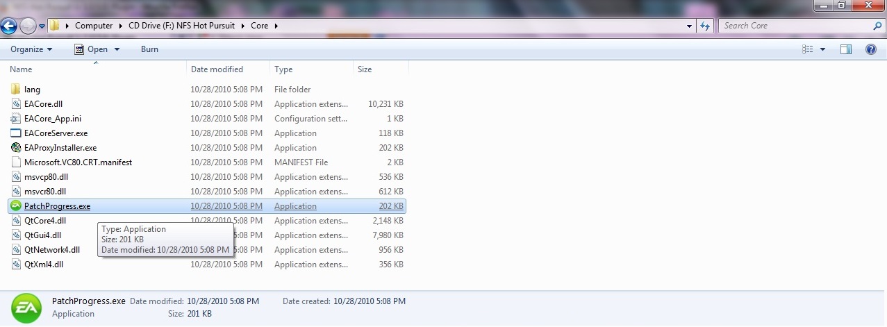

    @bsft ... Is this the file you're using ?...
    For me ... some time ago I opened the game and an update message came up, with the new version if it's OK to proceed ... I don't know where to activate it again to check for updates .
