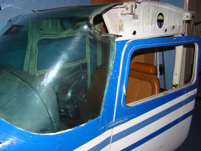

  14. kermit
    kermit Member
    Feb 12, 2010
    34
    0Coins
    Hi, herewith my little plane, also I am in contact with Indumex for frequentie inverters
    really nice people.
    greetz Henk

  16. egoexpress
    egoexpress Active Member
    Dec 13, 2006
    3,839
    Germany - Frankfurt/M
    422Coins
    +10 / 1 / -0
    Nice!
    Did you decide about 2 or 3 DOF yet? For 3 DOF you should use a spring to absorb the platform weight Imo.
    Looking forward to see some pics of your motion platform under the fuselage.
    Btw, the cockpit pic is quite small.
    regards
  17. kermit
    kermit Member
    Feb 12, 2010
    34
    0Coins
    Yes for now , it will be 2 dof maybe in the future I will go for 3 dof.
    But first I`d like to fly.
    changing things will be easy if I know the basics
    greetz
