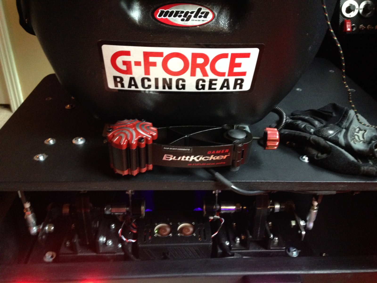

    I've finally got around to mounting the ol' Buttkicker Gamer 2 behind the seat.
    That should add nicely to the dual Dayton Audio Pucks which are mounted to the kidneys area of the seat (as well as the pedal deck).
    The BKG2 adds more low-end rumble than the pucks can produce, which is great for things such as gear change effects, collisions, sausage kerbs, etc.

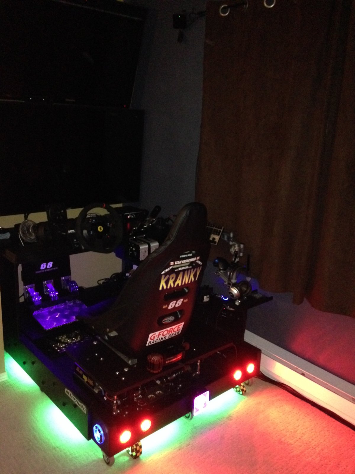

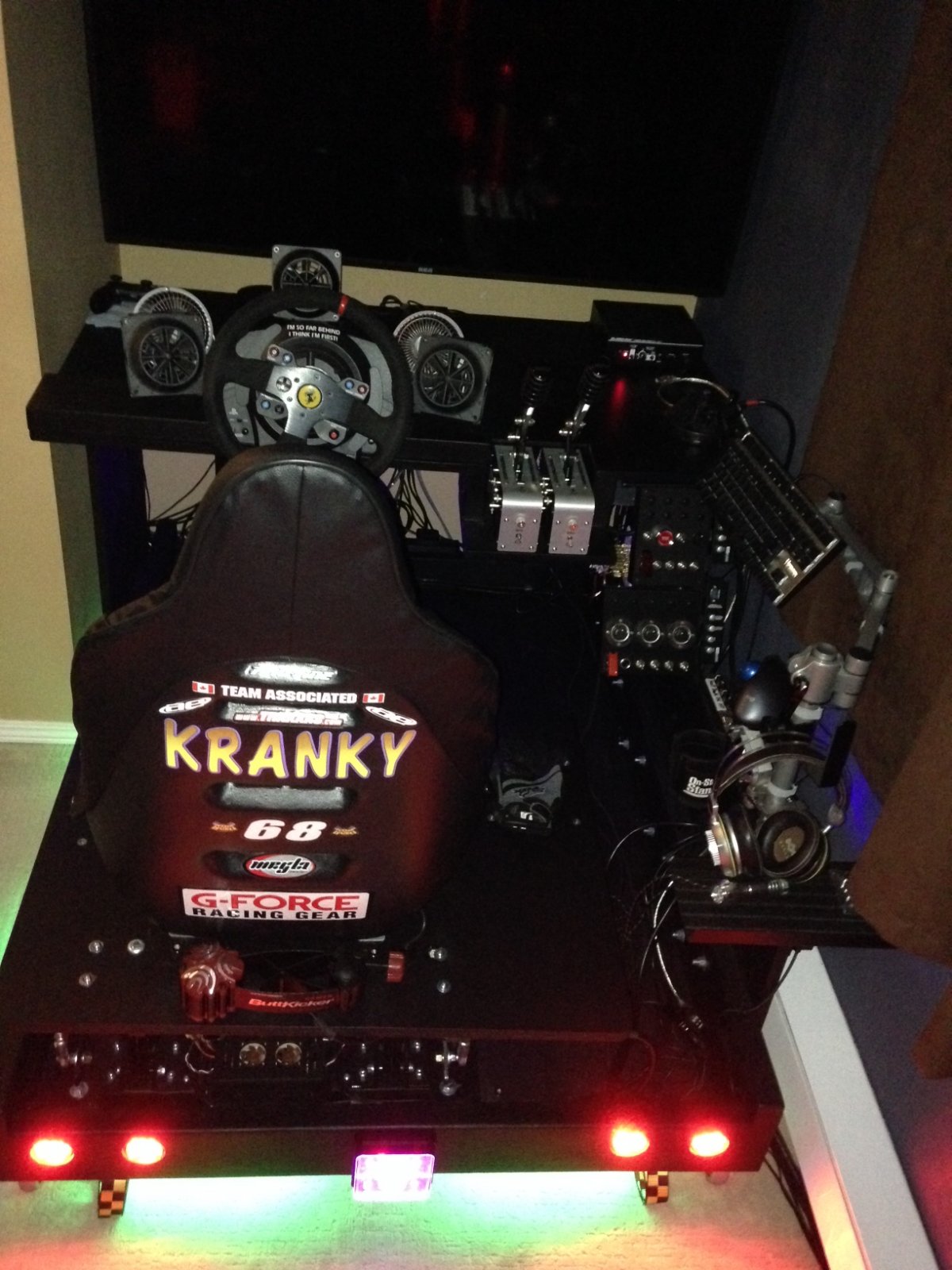

    Here's the overall rig with the DIY 2DOF platform in place, and it's now pretty much complete enough to enjoy for the coming Winter months here in Western Canada.
    I'm considering this to be the prototype phase, so come Springtime I'll have enough info on what I enjoy about it and what I'd like to see improved.
    So far I've been extremely happy with the results, and now with getting into the tuning aspect of things I can see so much more potential for the overall feel of the platform.
