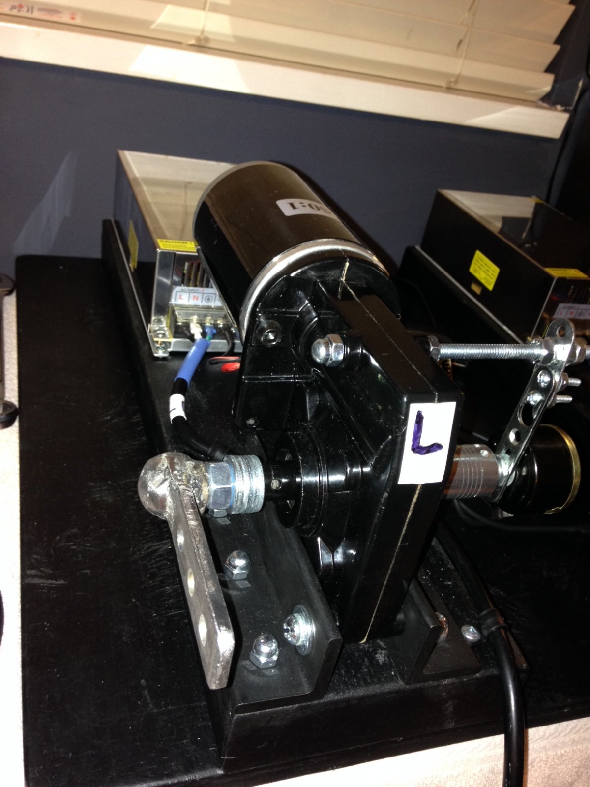

    Small update.
    Today I've spent some time downloading some game plug-ins.
    I was worried that my previous game patching from using the NLRv3 would interfere with these new ones from X-Simulator, but so far so good.
    So far I've patched around 5 or so of my favorite titles, but only now just tested Project CARS 2 (I'm a HUGE Rallycross fan....I love anything in the dirt!).
    O
    M
    F
    G
    Are you serious!?!?!?!?!?!
    This feels even BETTER than the NLRv3 did!!!!!
    And this is without any tuning, just adding the six basic DOF's in the Game Engine!
    Thank you...thank you, THANK YOU to this ENTIRE Community!!!!
    I'm literally shaking as I type this.....it's incredible!
    I can't for the life of me believe that I was capable of building this system from scratch...and I have everyone here to thank.
    No matter how insignificant you feel that your post may have been, for me at least I'm sure that it helped in more ways than one.

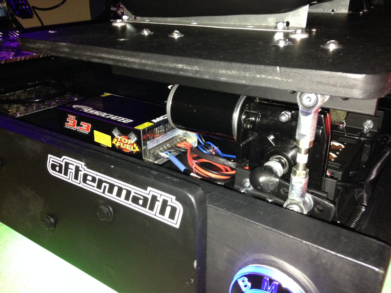

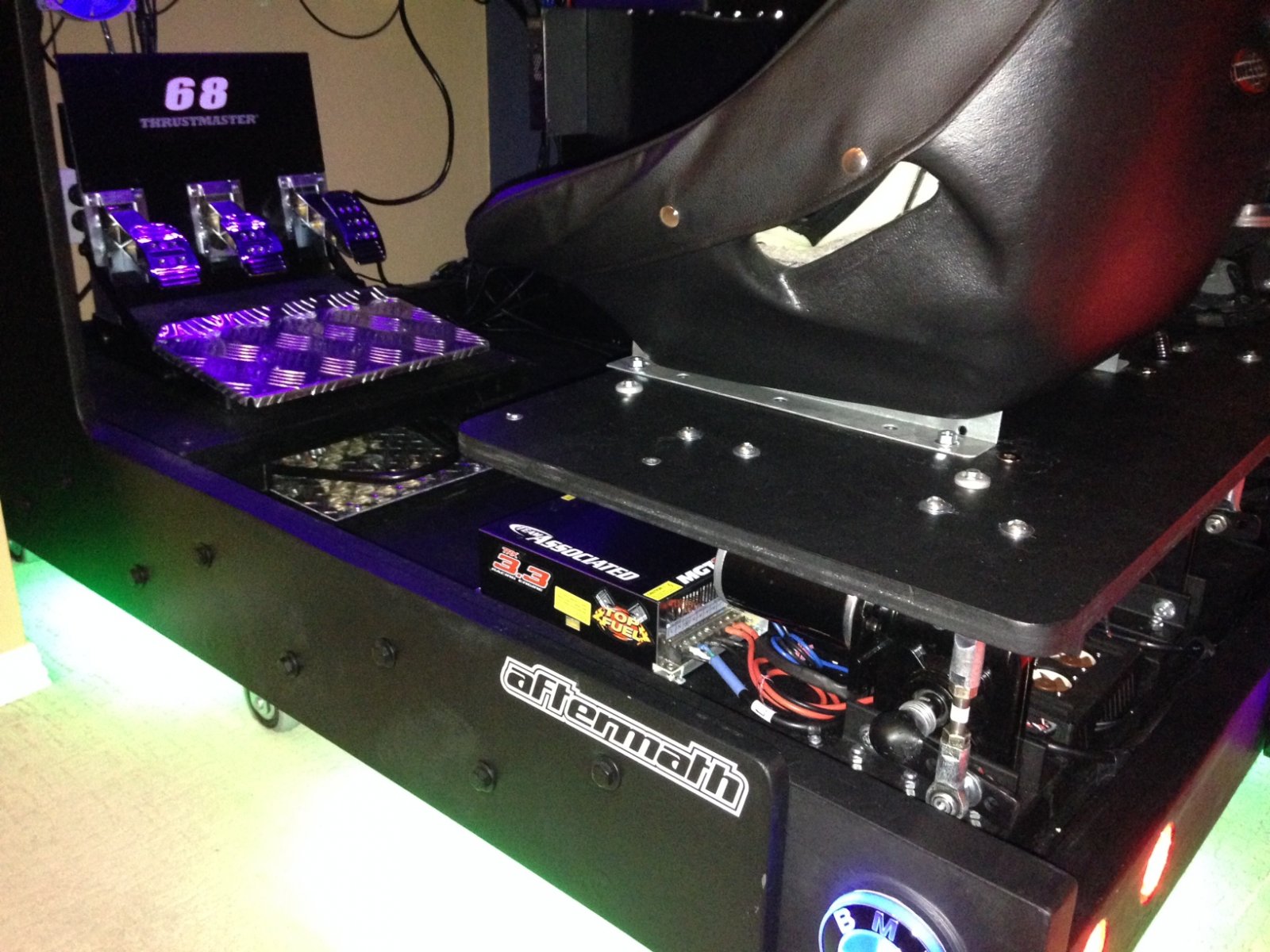

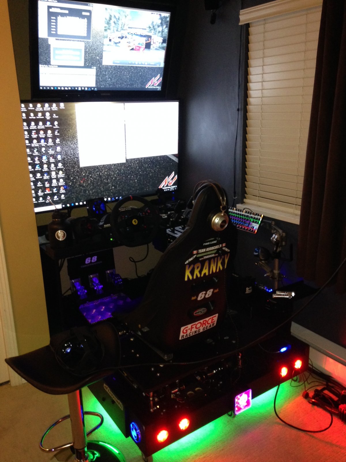

    Here are a couple of pic's of the (semi) finished rig, fully functional, but will be doing some clean up with the wiring, etc. sooner than later...that's if I can stop playing long enough to do so. ;)

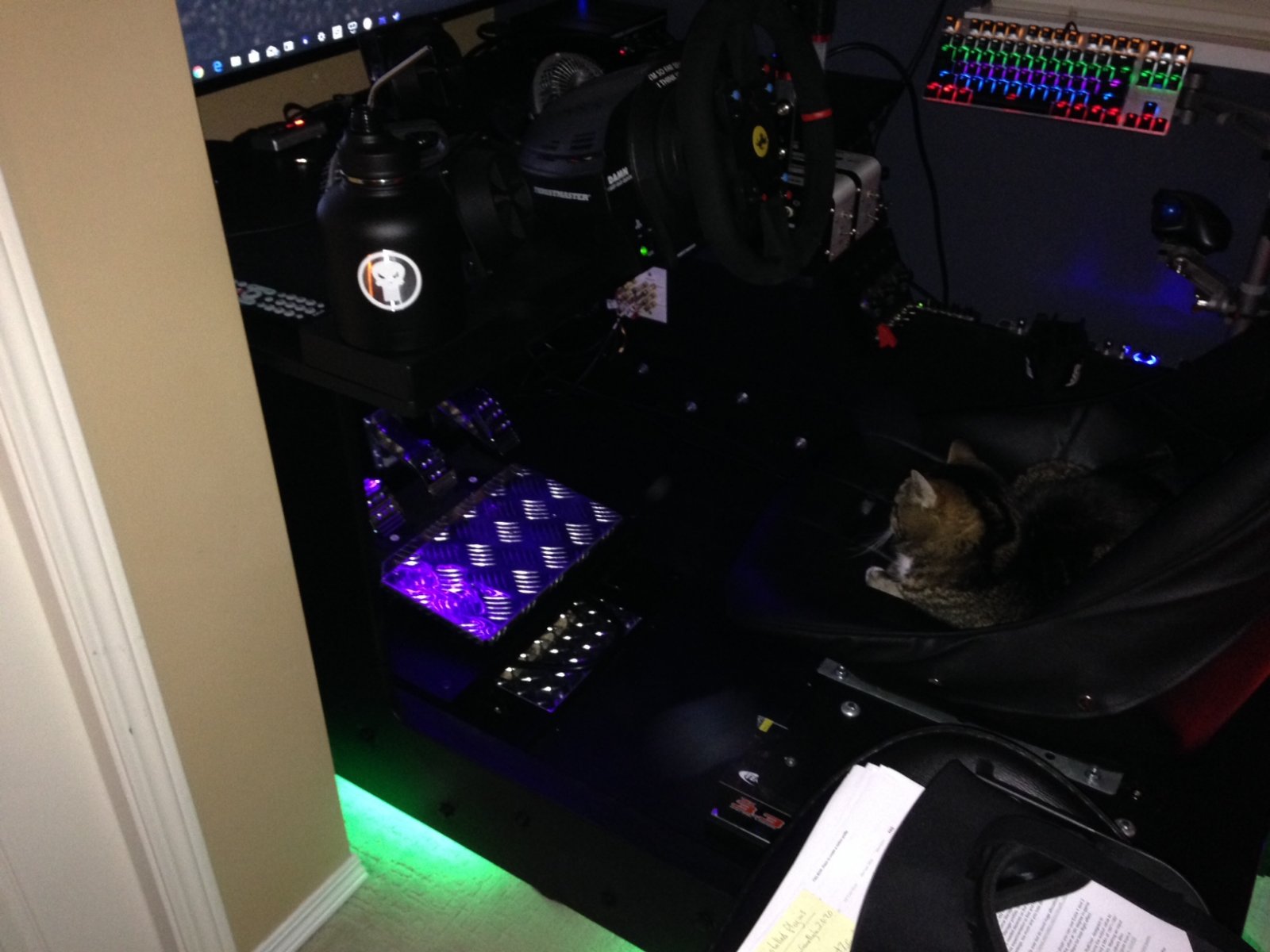

    LOL, my little buddy decided that it was a pretty comfy seat right before I was about to sit down and test some pCARS2, 'Lil Bugger!!!!
    Oh, and if you are wondering what the white tape is for on the threaded rods between the two ball joints, it's the center point so that I know I haven't maxed out one side over the other.
    Trying to avoid a Murphy's Law situation.
    Gotta go....too many sims to go play!!!! :D
    I'll BRB with the results. :popcorn

  8. Kranky Pantz
    Kranky Pantz Active Member
    Sep 9, 2018
    360
    Canada, Eh!
    1,275Coins
    +294 / 0 / -0
    Hi & Thanks!
    The motors themselves are great and appear to be doing the job, so far no complains here.
    Yes, a tiny bit of backlash, but these are new motors so it will most likely get worse over time.
    I can actually back-drive these motors by hand if I use a good amount of force.
    Sitting in the seat and leaning back with the power off I can definitely drop the rear-end down.

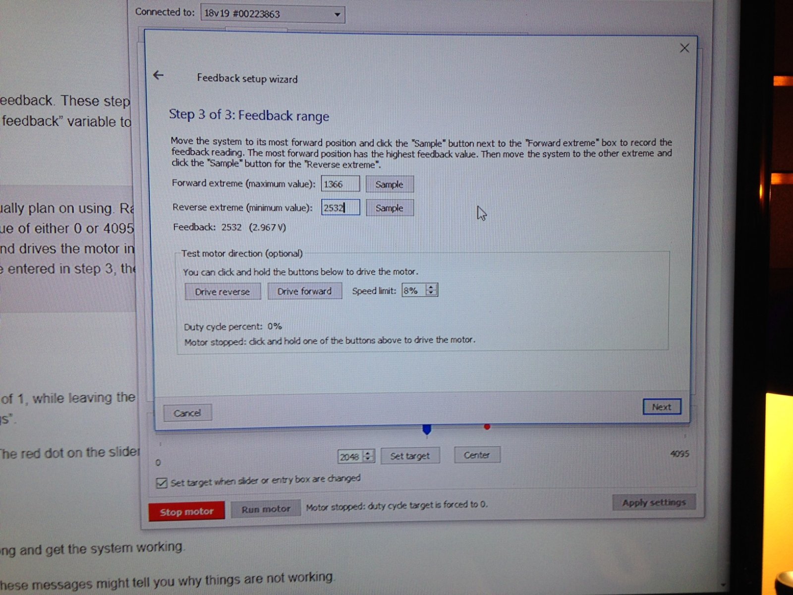

    Setting the motors to "brake" rather than "coast" in the JRK Config Utility seems to correct that issue.
    I think that also just leaving the "GameEngine"" running in the background also locks the levers in their neutral position, because if I quit out of the program before exiting the seat I can start to feel the rear-end drop.
    I'm not sure it's an advisable solution though, as it may cause some extra stress on the system when doing so.
    Perhaps someone with more experience such as noorbeast can chime in on whether or not it's safe to do so when playing non-motion games.
    The other alternative is to just make a simple kickstand or use blocks and lock the seating platform in place, which is something I may do in the future.
    One of my garbage welds on a motor-lever cracked, but it was a simple fix and I'm now back up and running.
    Funny thing is, I KNEW that one side was bad, so when it gave out I wasn't even upset.
    It only took a few minutes to remove the lever, not long to repair the weld, and only a few minutes to re-install and re-align the feedback pot using the JRK Config Utility.
    THIS is why I am glad I went the DIY route...knowing EXACTLY what the problem was, how to fix it, and the re & re of the parts involved.

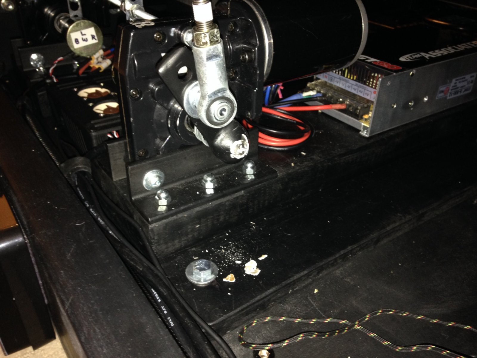

    Here was my first roadbump with the rig, a crappy cracked weld which has since been repaired.
    I'm not the least bit surprised, as it was my first weld and was crappier than a Seagull at the warf!
    I've just spent a couple of hours on the repaired Lever, and so far so good....lots of pCARS2 Rally racing, which tends to be a bit aggressive.
    Now I'm going to test Assetto Corsa Black Cat Country....the road which killed my NLRv3 Motion Platform.
    To say the least I'm somewhat fearful, yet optimistic that THIS rig can & will handle it.
    Yeah, I know that it was probably just a glitch or freak accident that the NLRv3 died on this track, but if I run a few laps and this rig survives then I'll claim a small victory, LOL!!!
    Here we go!!!
