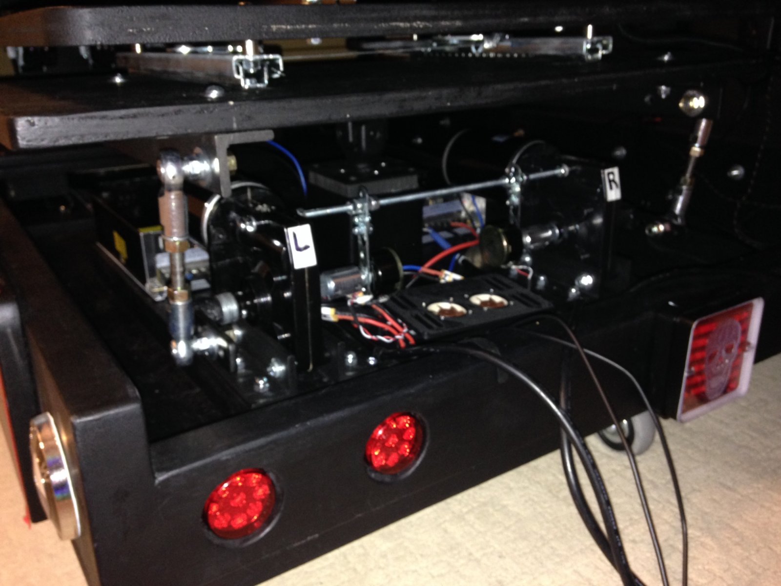

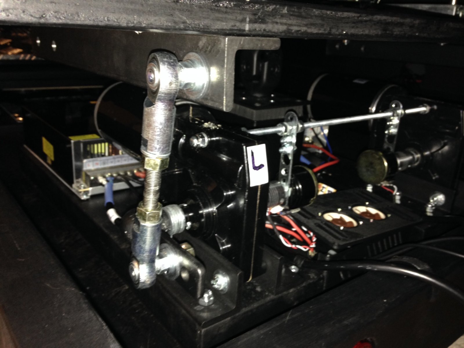

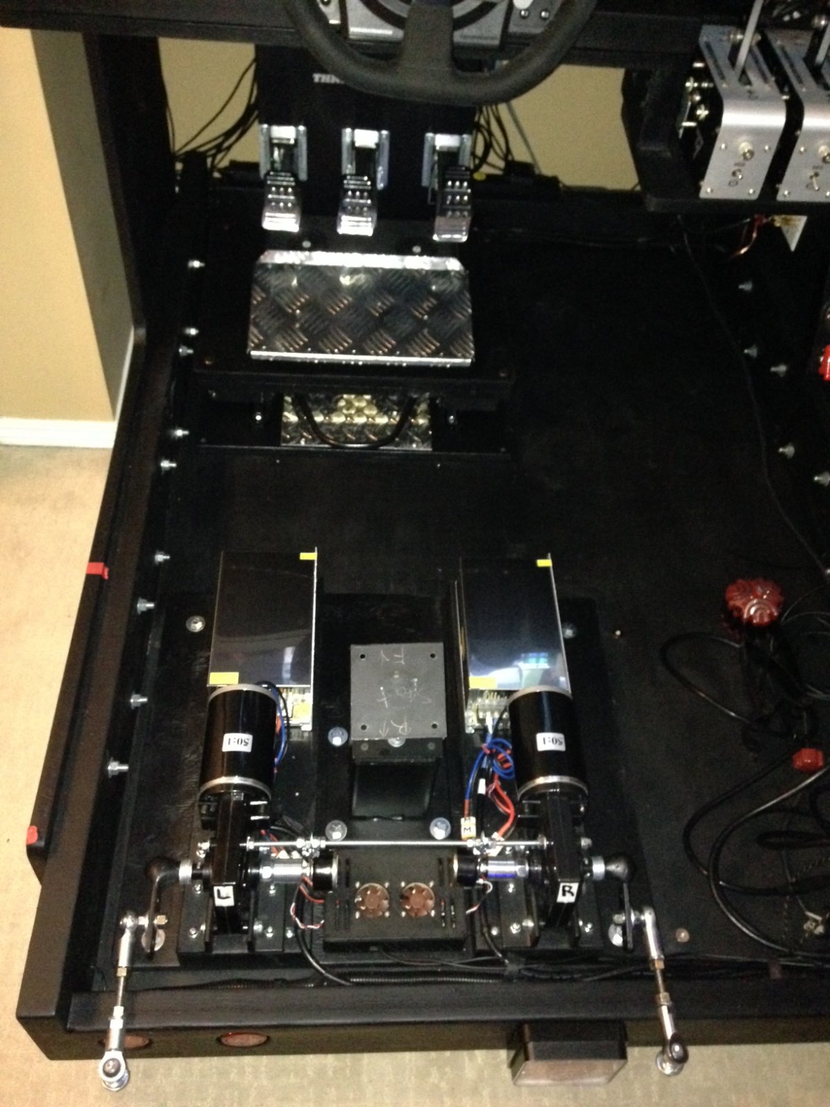

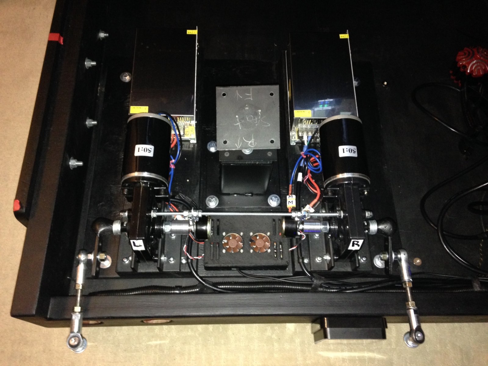

    Tonight I've temporarily attached both levers to the motors in order to do a real-world test with Live For Speed.
    Pay no attention to the driving, as I was simply trying to see the motion for different scenarios such as curbs, rumble strips, grass, sliding, etc.
    For some reason I get a feedback disconnect/motor latching error on the right-side motor (see the 1:37 mark). The motor latching part is due to the safety's in place to protect the pots, but the feedback disconnect is my main concern at the moment.
    I'm not sure why since the JRK Config settings are the same for both sides, plus I've tried two different pots as well.
    One thing I do know is that my settings were just enough to get it going, so most likely way off from what they should be for perfect functionality. With some more research and tweaking I'm confident that it'll all fall into place eventually.
    Will investigate tomorrow, after I put the electronics into their enclosure and tidy things up, etc.
    Who knows, maybe it'll magically fix itself after I do a full reset of the electronics and software;)
    Sometimes you've just gotta reboot 'n start over.
    For now, I'm just glad to see it functioning and somewhat playing nicely with SimTools + The LFS demo.
    I'm not really sure at what point my rig would qualify for a DIY license, but once it does I'll immediately do some testing on all of the more modern sims and also upgrade to the Pro license.

    It turns out that the feedback disconnect error/motor latching on the right-side was due to an optional setting I had enabled in the JRK Config program.
    Once I disabled it the problem was solved, and I can now turn lap after lap in Live For Speed without any errors or motor latching...yay!!!!!! :)
    This is the description in the JRK manual for that optional setting:
    "The “Detect disconnect with power pin (AUX)” option, which is only available when the “Feedback mode” is set to “Analog voltage”, causes the Jrk to drive the AUX pin low once per PID period after measuring FBA. If the voltage on the FBA pin does not drop by at least a factor of two while AUX is low, then the Jrk reports a “Feedback disconnect” error (if that error is enabled). The AUX pin drives high at other times."
    So with that issue out of the way today I am disassembling the axles and drilling the holes for their locking pins, then painting them.
    After reassembling them I'll be positioning the seat-post and connecting the ball-joints & rods to the motor levers & seat platform.
    Then away we go!!!!! :thumbs

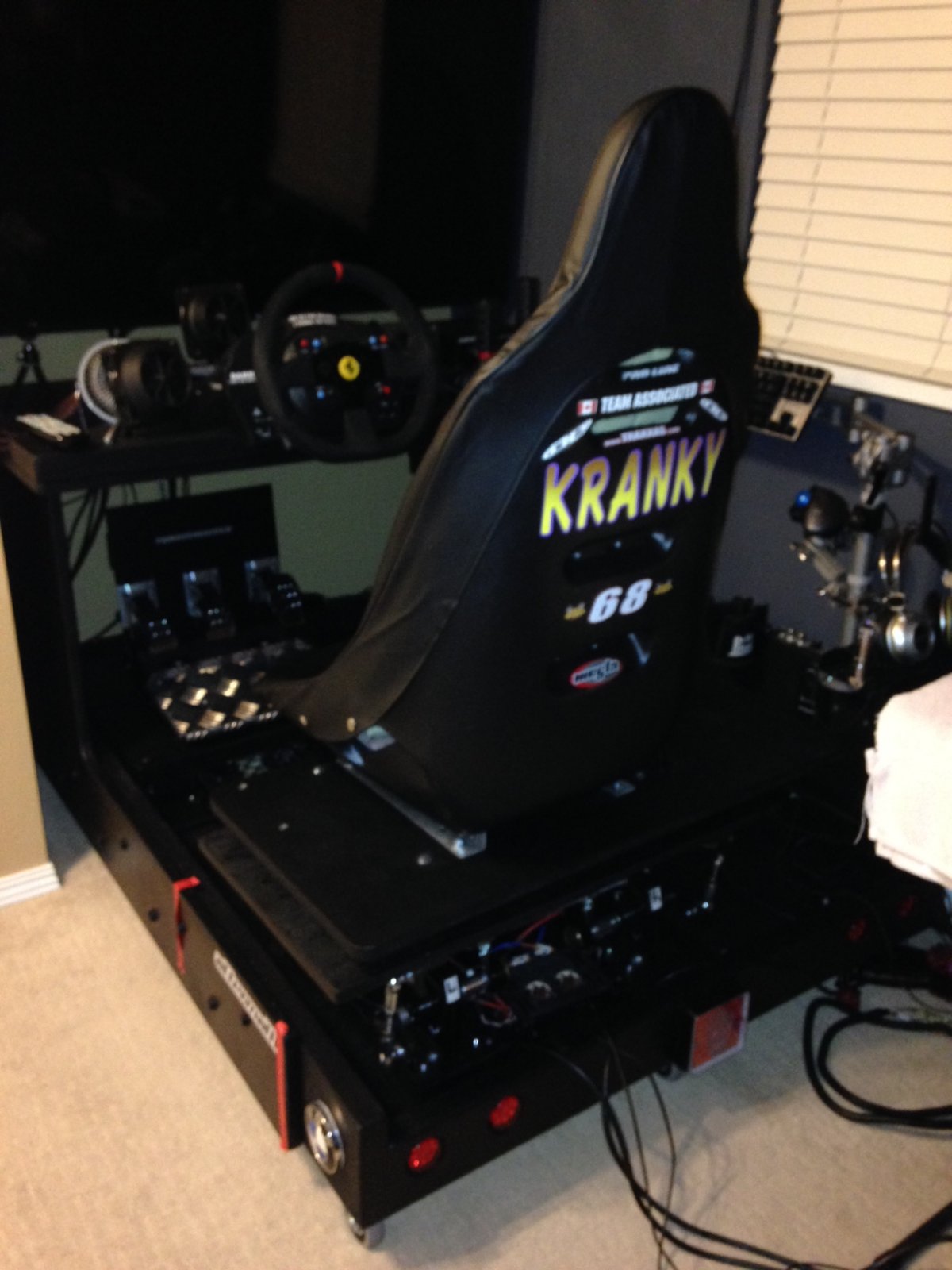

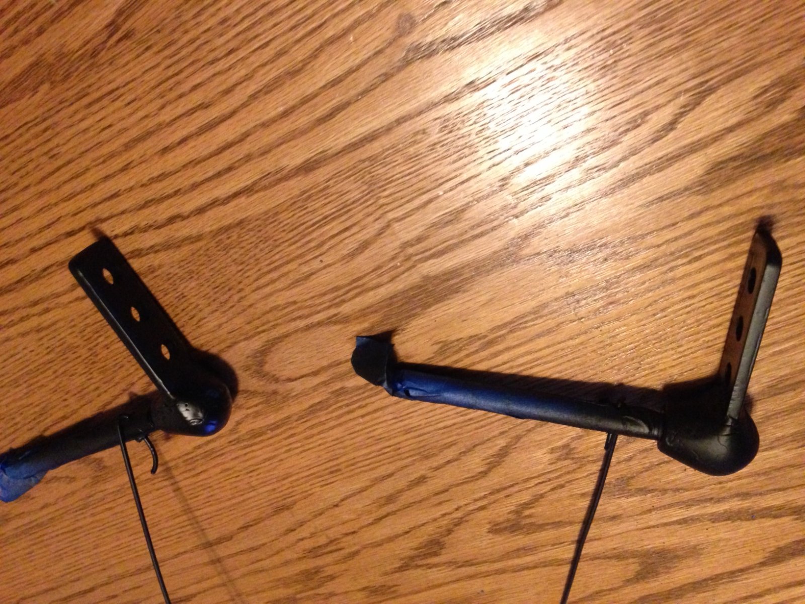

    Today I'm doing some general clean-up of the motion platform such as painting the levers/arms, and prepping to mount the seat pedestal & connecting rods.
    I'd like to thank the X-Sim Team for granting me a DIY licence, and for the extremely quick turnaround in doing so. :cheers
    Testing with Live For Speed made me realize that I should have been playing it more than I had been prior to this project.
    Including that profile for testing was a brilliant idea from the X-Sim Team, Bravo! :thumbs
    I can't wait to see my rig in motion with all of the other racing & flight sims currently in my games library!!!

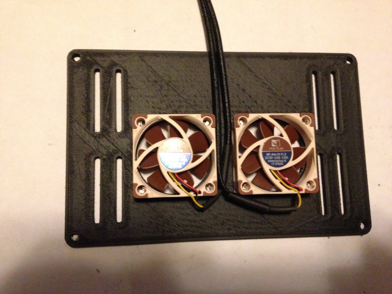

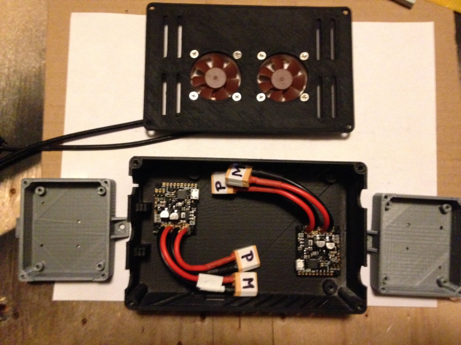

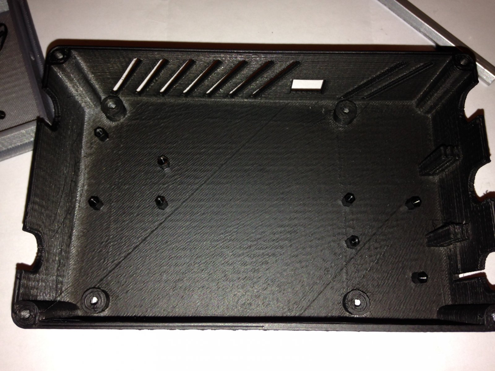

    Here's the new 3D printed box for the electronics, which is a lot more suitable than using the dual setup I had originally planned (the two silver boxes on either side of the new larger black one).
    It has side vents for allowing warm air to escape, and the top mounted fans should bring in cooler air.
    The PCB stand-offs are nylon ones which are used for building RC Racing Quadcopters.
    Luckily I have a box of various length ones on hand and found the perfect height for these mini PCB's.
    These Noctua fans are absolutely dead silent, rare for smaller fans which usually make a high-pitched whine.
    Dual 40mm fans for some added cooling.
    Still waiting for the paint to dry on the axles/levers before attaching them to the motors.
    Man....the anticipation of assembling this is....well....like watching paint dry. ;)
    In the meantime I'll start drawing up that list outlining the parts + costs.

    watchumacallit
    I've been a bit delayed on that parts/cost list due to making progress on my build, it's almost done!
    Did a test fit of it in the rig last night, and everything went very well.
    I'll be eliminating the seat-slider portion in order to reduce the overall seat height by 2", and may later use it on the steering wheel deck in order to be able to adjust the wheel for & aft.
    I should be able to actually sit in it and use it tonight!
    Now that I know the complete parts list I'll be getting that together during my down time today.
    Hopefully I've provided enough pic's to serve as a build diary/assembly manual for anyone wishing to go with this style of 2dof motion platform.

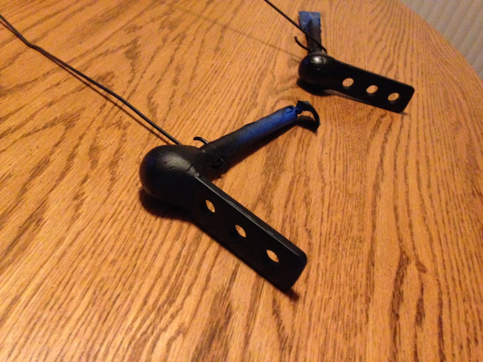

    Here are the painted axles + levers, now dry and installed on the motors.
    They are 12mm bolts, 14cm (5 1/2") in length, nuts welded on either side of the lever, and then finished off with automotive putty to to cover & seal the nuts (for purely cosmetic reasons).
