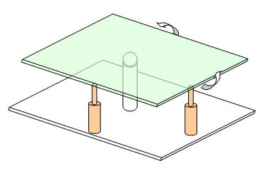

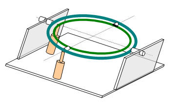

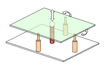

    First what is the best system for car simulation? 2 DOF or 3 DOF? ( i know there is 6 dof too but i want to start not to difficult)
    and then 2 dof like this:
    (i have also see something like above, but with a 3 axle . see http://www.jimspage.co.nz/pictures.htm
    , is it than 3 dof?, and is this better?)
    or 2 dof like this:
    or 3 dof like this:
    or 3 dof like this:
    I think the last one... ?

    Hi Arjan,
    Welcome, sorry that nobody replied back until now. We are busy building our simulators... 8)
    For car simulation its better to use 2DOF that is more simple to build.
    You can build something simple like this:
    tronic-s-full-motion-car-racing-simulator-using-x-sim-t471.html
    And my site with full instructions:
    http://ptyxiouxos.net/greekbotics/user_ ... ulator.htm
    OR build a SimforceGT type simulator:
    ego-s-simforcegt-with-dc-actuators-t547.html
    For electronics you can use those I mention on the above site, or build the new better ones that I describe here (DIY):
    tronic-s-amc-motor-motion-controller-with-pwm-servo-output-t559.html
    tronic-s-diy-dual-mosfet-h-bridge-t820.html
    For software you should use x-sim software located here:
    installer-x-sim-beta-1-6-9-t787.html
    The x-sim software is free!
    As you can see its all here, just a little search is needed! :thbup:

  5. tronicgr
    tronicgr
    Hi Arjan,
    Its your choice!
    Some prefer the SimforceGT type as its more simple. But it can be used only with car simulation games! Its advantages is that it can be used with projector screen as the screen in front of the driver stands still. And the footprint of the construction is a lot smaller, actually two DC motor actuator behind the seat!
    On the other hand the joyrider type can be also easily converted and used as Flight simulator! :fly: When I originally made this motorized joyrider sim I was using it only for flight simulation until I tried the x-sim software and realized the possibilities with car simulation! And the immersion, in my opinion, is much better since everything are following the cockpits motion (screen, steering wheel, pedals). BTW, I used simple car windscreen wiper motors to move it... Did you seen the videos?
    Regards, Thanos

  9. tronicgr
    tronicgr
    The SimforceGt does smaller angle motion and it doesn't affected too much from the stationary screen... It mostly simulates the stress on the hand muscles (when holding the wheel) during acceleration... It tricks the mind using body stimulus that combined with synchronized optical stimulus gives you the desired immersion.
    And its true that with the screen moving along the motion path the immersion its way better! And it gets even better if you fully enclose the cockpit to block all the external reference visual cues! I wish I had the courage to try enclose my joyrider cockpit too this way...
    Regards, Thanos
