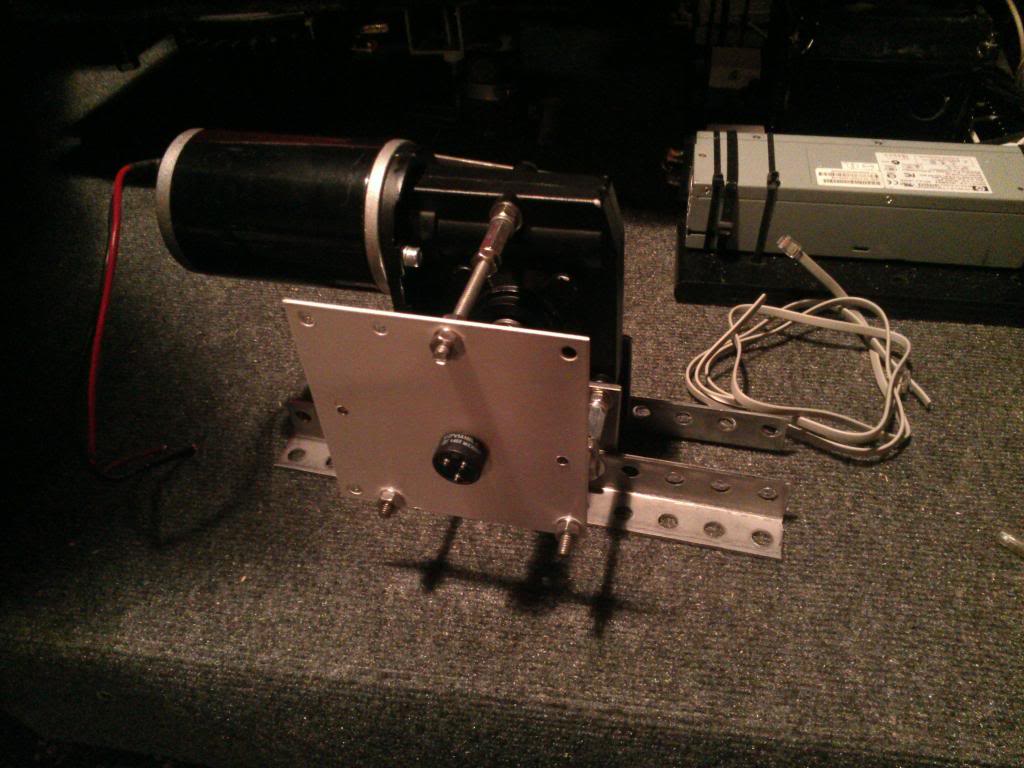

    Pots mounted
    All wiring is done, just waiting for jrk's and heatsinks to arrive.

  12. RacingMat
    2,234
    21,094Coins
    Good work indeed!
    but the motor mount look too weak in my opinion: they will move under stress
    so you will loose accuracy or may lead to break failure
    keep going buddy!

    Yes the angle is a bit thinner than i would like, but its about 12" long and I have four more lengths that will go underneath the 3/4" plywood and bolt up to the top ones. So Im actually doubling up on those mounts with the plywood in between. I think it should eliminate any flexing.
  14. bsft
    Maybe with 2 pieces on angle it may just hold well, despite it being thinner.
    Give it a run and repair if it breaks.
  15. eaorobbie
    20,506Coins
    +1,687 / 23 / -2
    Another little note , I use a thin gauge ali on the pot mount , allows for any movement off centre the shaft may have , allows the pot to follow the shaft perfectly, if too solid and you have one shaft 0.5mm off centre , pot will not last long , will eventually bind the bush and pot collar together. A slightly flexible mount is needed. Specially for the fine tolerances that are in the Hall effect pot. A couple of people have had them fail because of this.

    Thanks,Robbie. I think I will change to something more flexable as I know I have some wobble in the pots. Better safe than sorry.
  17. eaorobbie
    20,506Coins
    +1,687 / 23 / -2
    Either that or gear drive the pot is best or even pulley's is another option, but I use the centre of the shaft theses days , just simpler.
    I actually use slightly different way then most.
    I oversize the hole in the bolt end so the shaft sits in there freely, about 1mm over. Now I drill through the bolt and pot shaft and hold in place with a 2.5mm R clip.
    This too allows for anything that might be out in the manufacturing process of motors and Simulator.
    Makes it a little tricky to set its first position before drilling and pining but the Jrks make this a lot easier.
    Set my lever to middle, open the Jrk Utility and turn pot until it reads 50% then drill the hole through to pin it all together.
    Bit harder on the Ard setups but believe prilads and rufus little app that goes with their code might allow the same setting up, if not use a multimeter to get a 2.5v reading to know the pot is on centre to the centre position of the lever.
    I do this so that I know I have the same range up and down , even though once setup , I don't use the full range.

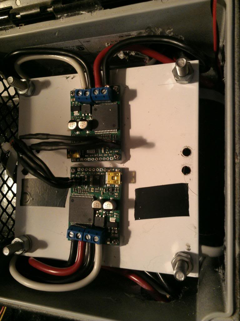

    Jrk's finished. These things are smaller than I thought. Was kind of a pain in the ass.
    Heatsinks should be here any day now.
  20. bsft
    small size but big on power
