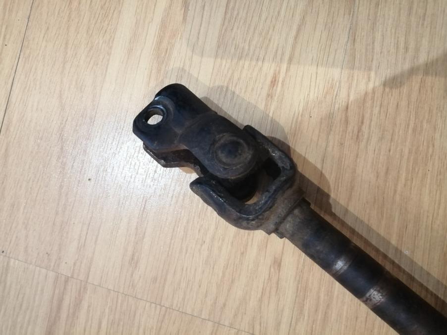

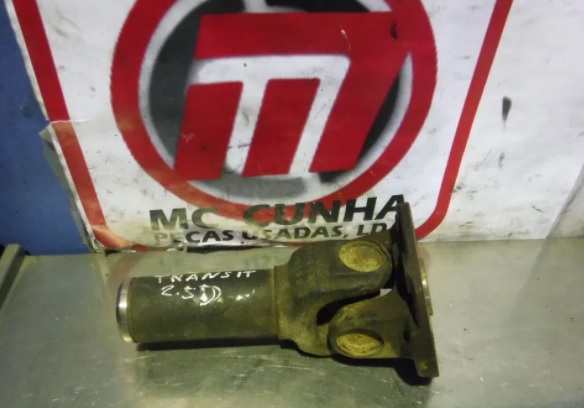

  19. Mike Melga
    Mike Melga Member
    Jun 22, 2020
    87
    IT
    Portugal
    663Coins
    +25 / 1 / -0
    A friend of mine gave me a used steering (I guess) joint he had laying there.
    The first picture is the one I have.
    It is only 4cm wide. Would it be enough to support the seat? Or should I buy a big one?
    The second one is from a Ford Transit and I can buy it for around 30€.
  20. Rens
    Rens Member
    Aug 21, 2020
    79
    517Coins
    +29 / 0 / -0
    Personally I would go for the second one.
