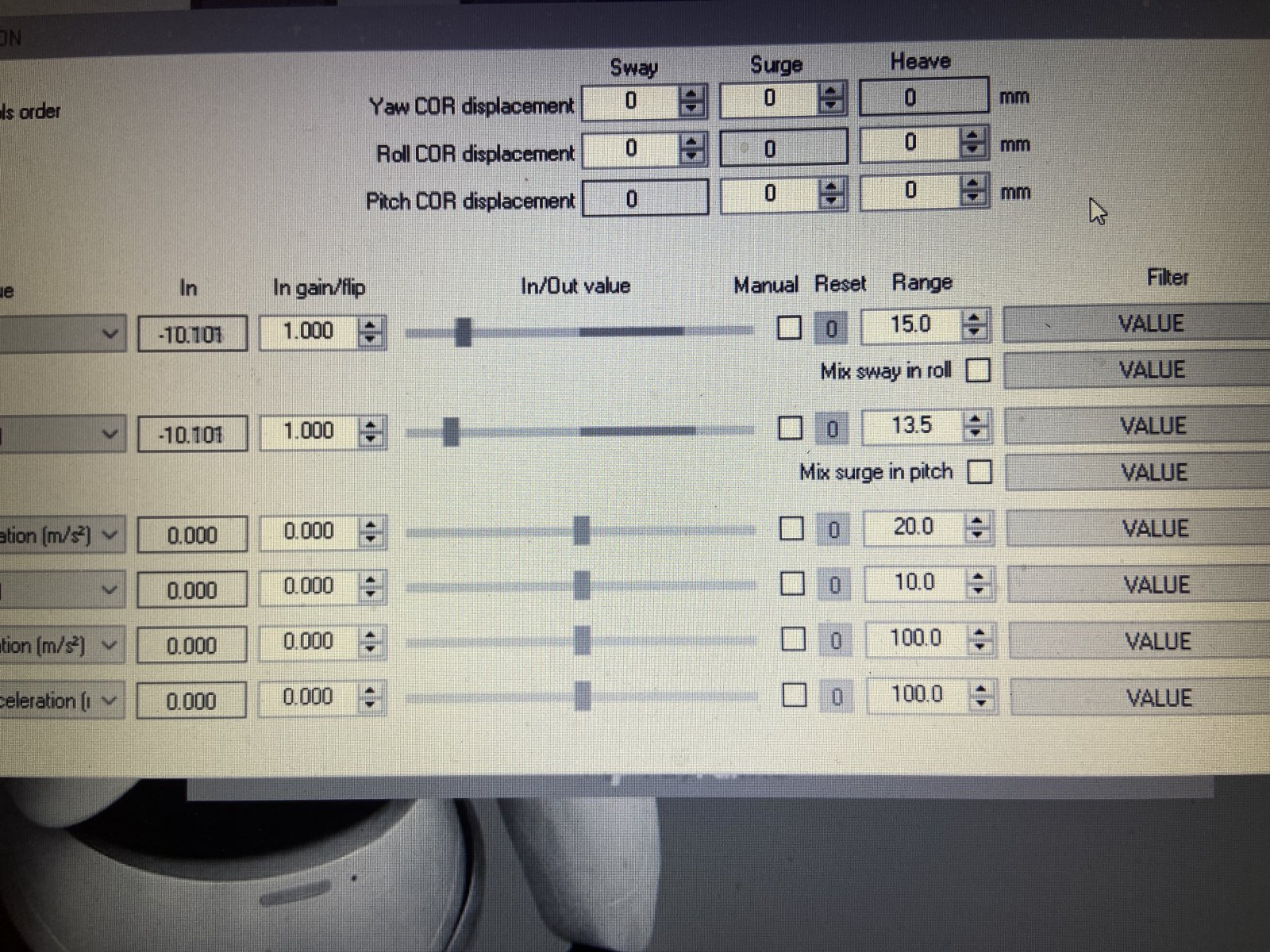

    so I am able to connect...but when I try to move the slider, the motor is very rough....
    I have 2 of them hooked up and I actually can move both but one moves more rough than the other...They are both not smooth...both drivers are set for 3200 steps.....am I missing something in the setup ?

    Hi @theDAMguru :
    For a smooth run of the motors you should use filters in flypt mover. For the absolute beginning and testing with the slider you can simply use emalp 200 for example. The lp in emalp means, the lower frequencys can pass to your sim. The high frequencys that sometimes can feel rough (specially with the slider) , are filtered out.
    Learning the usage of filters is quite important an you will find a lot of information here about filters. I can highly recommend the posts from @Dirty for this topic!
