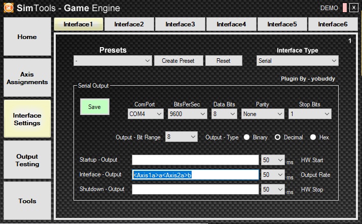

    I've been busy chipping away at this project - I should have posted more!
    I ended up buying a cheap NodeMCU ESP8266 ($10) and 2x SG90 RC servos ($5 each) from eBay and I've been messing around with Arduino programming.
    @noorbeast, I know you said I didn't need to write my own sketch but I kinda wanted to learn it myself :)
    I found example code for:
    1. Serial IO
    2. Wifi
    3. Servo control
    4. UDP server
    I did learn a lot from this post though, kudos to @BlazinH:
    https://www.xsimulator.net/community/threads/data-from-simtool-to-arduino.8459/#post-105546
    Then I mashed them together and eventually came up with two variations of a sketch for this job:
    1. Using a serial connection (the one I'll likely use)
    2. Using a wifi connection with UDP (for fun)
    I configured SimTools to output like this:

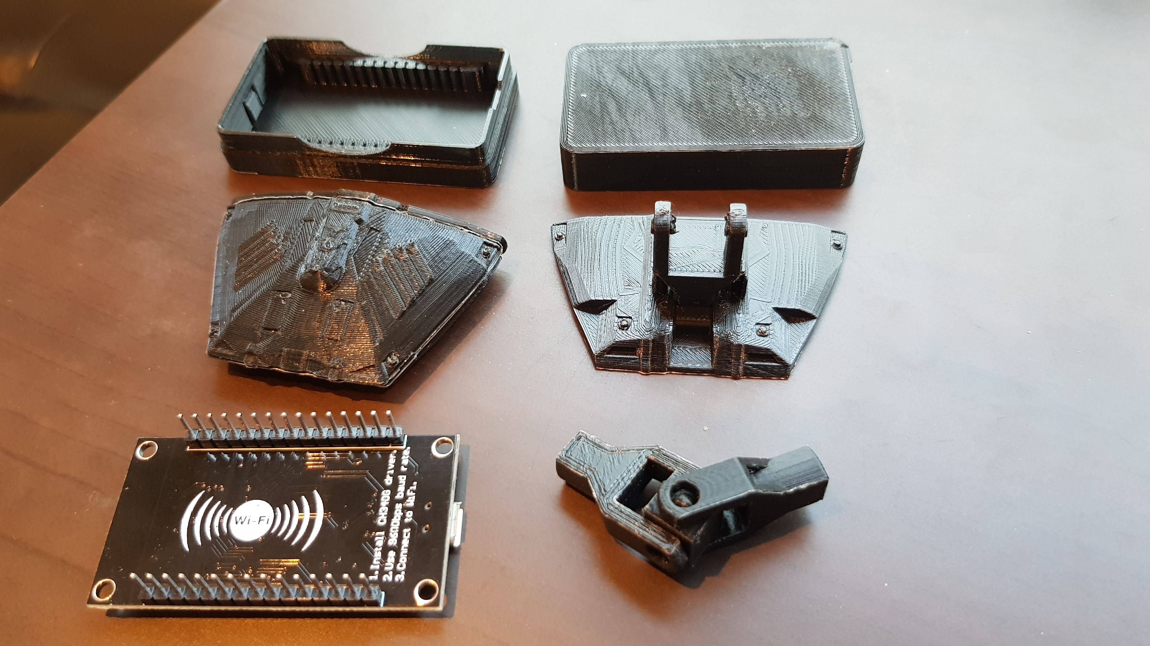

    3D Printing
    After that I started looking on Thingiverse and found models for:
    1. A case for the Arduino
    2. A universal joint
    3. A ship from Elite Dangerous (Sidewinder, starter ship)
    In the slicing software I was able to merge one half of the universal joint into the bottom of the sidewinder which will give me a good pivot point for the universal joint.
    Printed them out, temporarily blutacked them together and they look great!
    The next step is to make a small modification to the model so I can attach some rods to the back of the ship.
    I've been playing around with Fusion 360 and have started (and finished) another project (modifying Oculus Rift Sensor Mounts) with that since so I'm definitely getting more confident with it!
