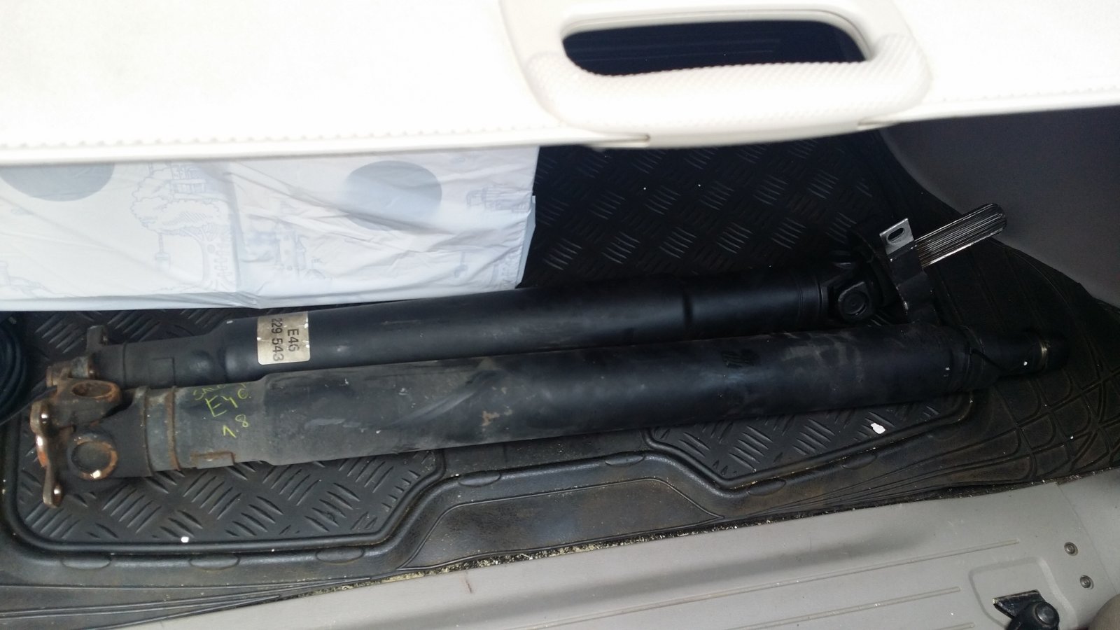

    I'm hoping that it won't be too heavy, otherwise it's start the frame all over again
    I have picked up these though
    Meaning I have two chances, hopefully not too bad for a tenner, just hoping they will be good enough
    would I be ok just putting a plate on the one side that doesn't have the mount or best to do extra? And a potential silly question but how long should I do the pivot, I know it needs to atleast clear the motors

    Yeah the one at the bottom of the picture is the boy you want, bargain at a tena:thumbs
    A plate at the bottom is all you need just cut it at the length of your choice and weld a plate with 4 holes and ya good to go.
    Length of shaft is up to you I would set it at a height that's comfortable to climb in and out, remember it easier to make it shorter than longer lol

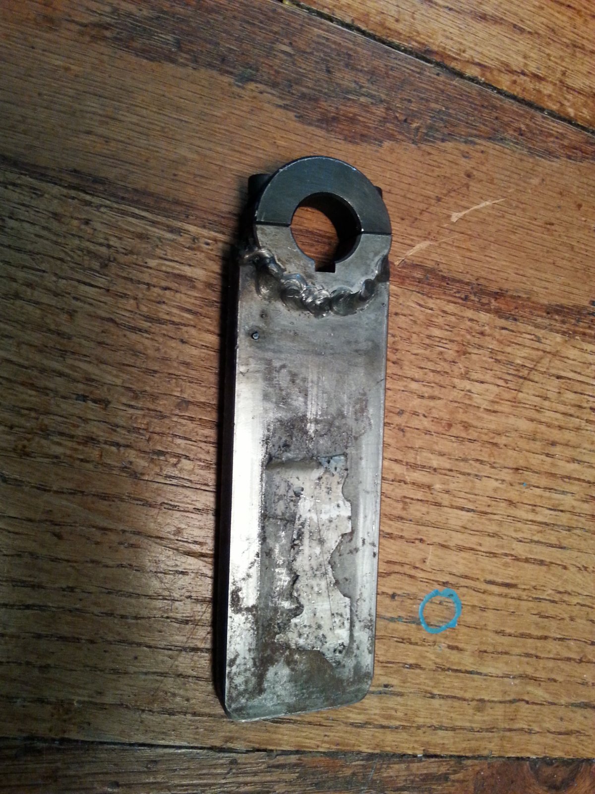

    The motors are 12V DC 80rpm 60:1. is there anything in particular to use as levers?

    here is what i used. i ordered the keyway coupler from ebay. then welded a section of flatbar.

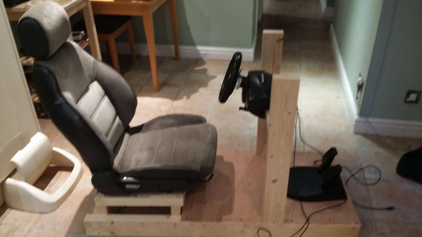

    I shall keep it in mind :) I am now at the stage to look at doing the motion platform part now I reckon :)
    We gave it a test drive last night (although awaiting a G27 to replace the cheap one I have ) and it seems to work well as a seat...
    Which to add to a question, does anyone use their motion platform for non motion gaming and if so do you add some supports or anything ?

    I can't remember who but someone used hinged wooden blocks under the motor leavers when their sim was not powered.
    With ratios over 50:1 you can sit in a sim unpowered and it will hold. Mine doubles as my office chair using a 60:1.
