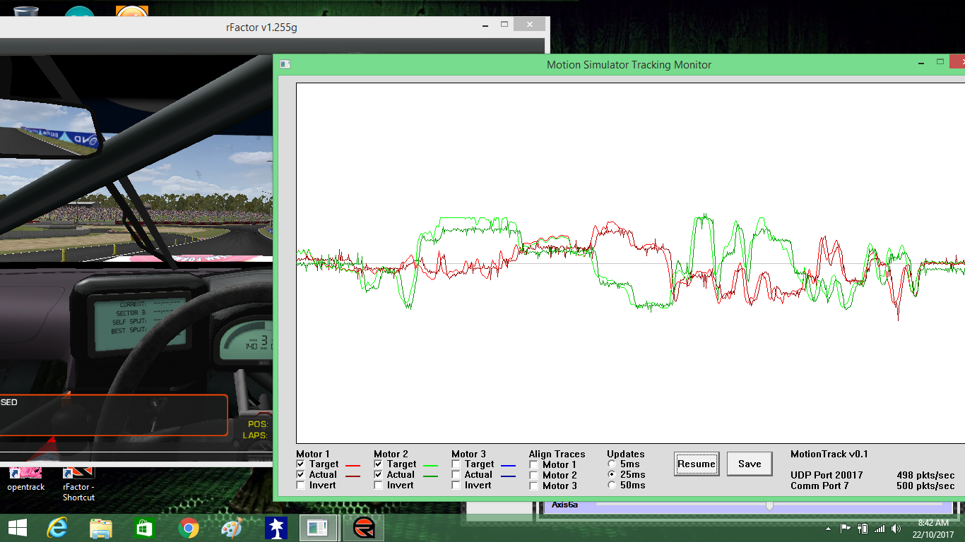

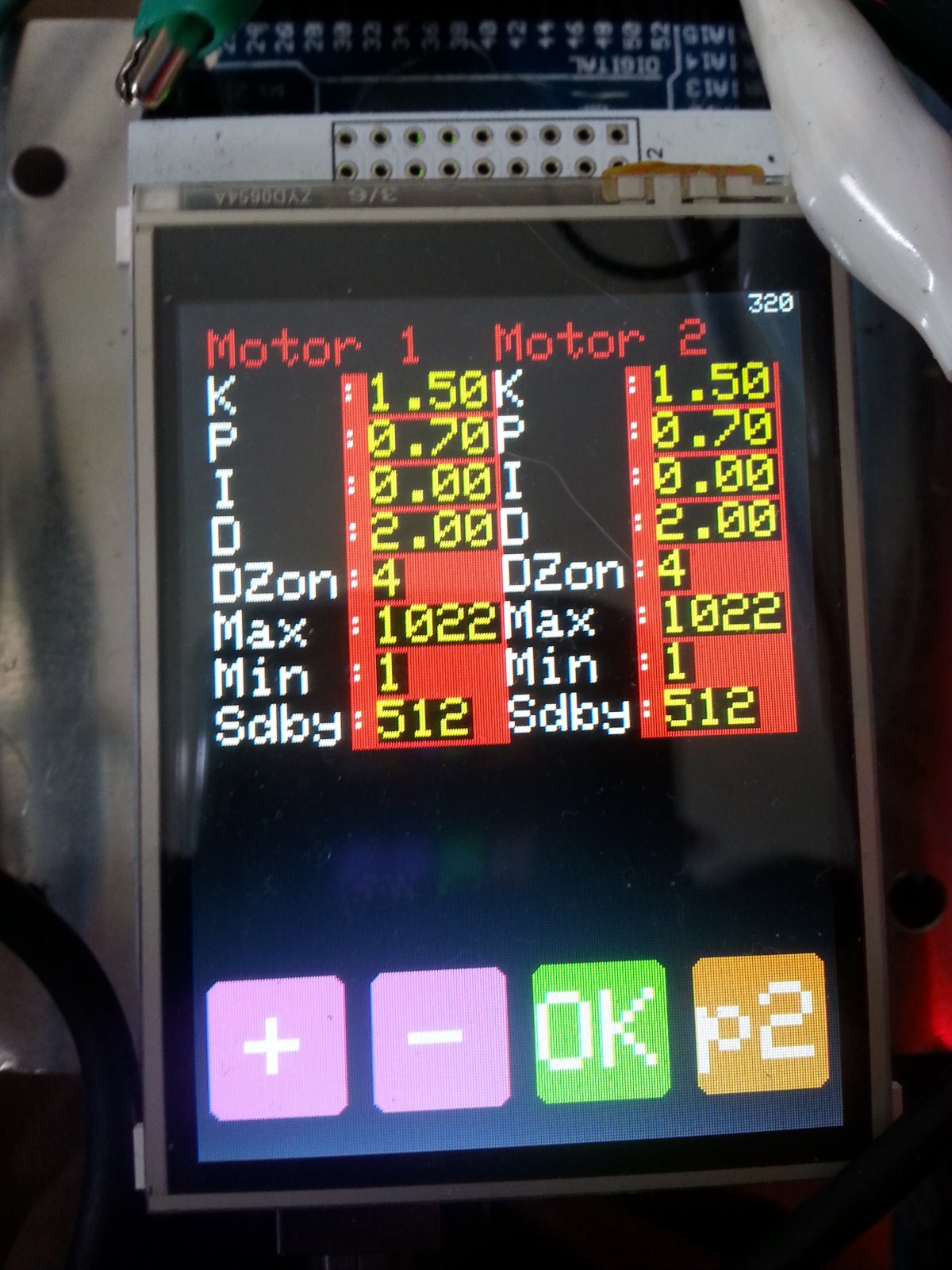

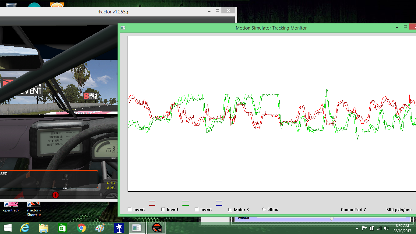

    just wanted to say a big thanks to @vthinsel for the code with tft, makes changing pid settings on the fly very easy and together with @RufusDufus simple scope made setting the whole rig up fairly simple. Here are my final pid settings, some shots of the scope and a test video, I think it is all working very nicely.
    If I should be posting some of this somewhere else or you want me to start a new thread with my build let me know.
    P.S. the bad driving in the video cos I was using the laptop and keyboard to drive.
