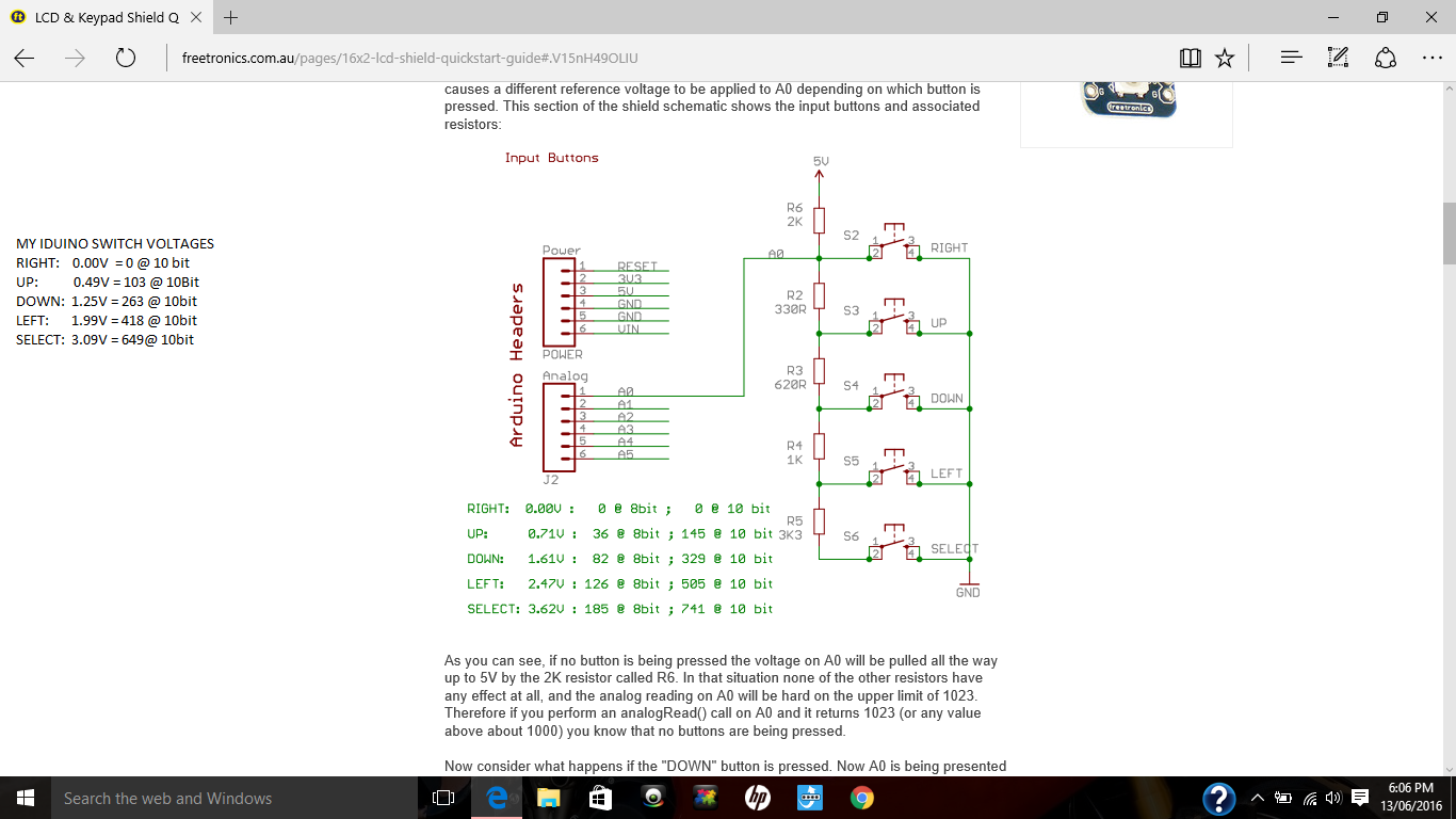

    hi @vthinsel I recently bought an Arduino mega and an LCD shield and downloaded your sketch for the Arduino.
    I was having a lot of trouble getting anything to work, the LCD would light up and I could scroll through a few of the settings but I was not able to access any or change any of the settings, eg: K,P, I, D or min, max settings etc.
    The LCD shield I bought looked like any others but didn't come with any specs. After trying some example codes where you press the buttons and it should show up on the LCD what button was pressed I was getting "LEFT" when "SELECT" button was pushed and "DOWN" when "LEFT" button was pressed.
    The down, up and right buttons were ok.
    I found on FREETRONICS website a page where it stated what the voltages should be at the AO pin when each button is pressed and the corresponding digital input for their LCD shield.
    I have attached a pic of a screenshot from freetronics with my voltages and what I set my corresponding inputs to in your sketch.
    I still have some testing to do but for now I can at least access all the settings and change them now.
    Thought this might help if anyone else has similar issues with another shield.
    P.S. My settings that I have used are the ones on the left of the pic in black writing
  13. vthinsel
    vthinsel Well-Known Member
    Feb 20, 2015
    439
    FRANCE
    6,058Coins
    +570 / 2 / -0
    Arduino, 4DOF
    I'm happy you were able to solve the problem. If I remember, I included in the code some other values to try to match different type of keypad resistors. The voltage dividers may be different from vendor to vendor, needing some code updates.
    As you have an arduino mega, I suggest you go for the more sexy TFT design :p

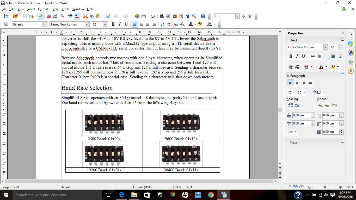

    hi @vthinsel just wondering if you or anyone else has used this code with a sabretooth 2x25. I already had the 2x25 which is why I am using it, anyway I am having no luck in getting the code to work. I have the dip switches set as per the picture to set the baud rate at 38400. At the moment I am just using a volt meter to check the output from the sabretooth and just trying on motor one at this stage. The voltage stays at around -10 volts no matter what position the pot is or if I try axis testing through sim tools it still stays the same.
    There doesn't appear to be a problem with the sabretooth or the mega as I can getting everything working with @Wanegain code. I would prefer to use your code as it incorporates the lcd/tft option which would be really useful.
    Would really appreciate any advice or tips you or any other members could give.
    Cheers
  20. graz
    graz New Member
    Aug 19, 2014
    25
    mechanic
    melbourne australia
    - 28Coins
    +21 / 0 / -0
    P.S. I have also tried using other baud rates, with it set at 9600 the voltage coming out of the sabertooth drops to approx. -3.5 volts but still doesn't change with pot or sim tools testing
