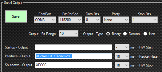

    PS: in the .ino file there is a startup code:
    XL~a01~CXR~a02~C
    In the video there is no code - so what shall I use?

    I use XL<Axis1>CXR<Axis2>C in the interface settings
    Next code will have correct info about that
