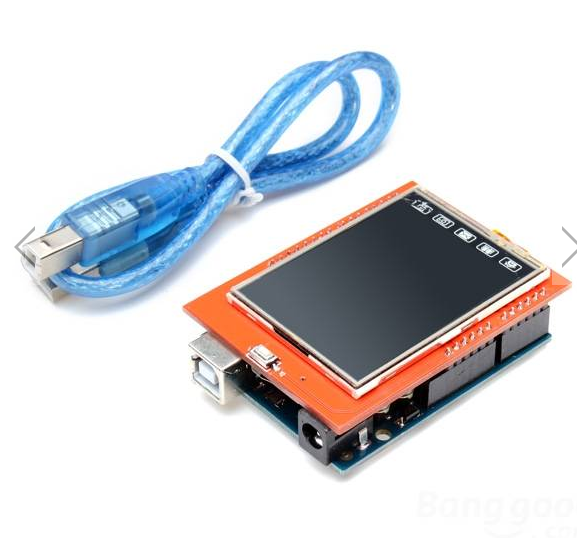

    Hello !!
    So I have decided to start a new thread beside the 2DOF seat mover thread I initiated in order to discuss the software setup. The idea was to use an arduino with a sabertooth module which is a setup that is more and more used. I used the great code from wanegain as a basis and I started to discuss with him (the PM thread is 8 pages long now... and still growing everyday :D )
    We decided to improve the current setup with a LCD device to monitor/debug the runtime environment, but then we added support for the sabertooth 2*32, and later on we added support for Arduino Mega. All that with a single code, whatever the sabertooth module / arduino board you select. The LCD has a menu driven interface to configure the various parameters.
    I tested on a UNO and a MEGA, both with sabertooth 2*32A (set to 115200 with MEGA and set to 38400 for UNO). The loop takes 0-1ms on MEGA and 2-3ms on UNO. Should work out-of-the-box also on Sabertooth 2*25A
    Main advantages of Arduino MEGA 2560:
    • 4 Serial UART, allowing 115200bps end-to-end (one used by USB, leaving 3 full COM ports for your design). This means we can achieve sub 1ms latency between SimEngine output and sabertooth input
    • LCD/Keypad Shield compatible
    • Lots of available pins (both digital and analog) to add a TM1638 dashboard for example :D
    • 256Kb flash / 8Kb SRAM / 5K EEPROM (versus 32/2/1 for a UNO)
    Main advantages of Sabertooth 2*32
    • USB port to configure/monitor
    • 115200 Serial packet mode (with CRC)
    • same price as 2*25 !!!
    • Intelligent user mode to implement specific behavior
    • Can absorb regenerative current using resistors
    Many many other features .....
    The "platinum" setup is of course with an Arduino Mega 2560 and a sabertooth 2*32 but others should behave well also
    The LCD will allow you to
    • edit all PID parameters for each DC motor
    • edit your pot min/max/deadzone values
    • edit your global deadzone
    • change the sabertooth type
    • Set standby values for each motor
    • Change number of reads done on pots (average system)
    • Reset EEPROM to default values (recommended for first time load)
    • Show in realtime the value sent by SimEngine, the PID value calculated and the pot value (as well as loop time)
    All parameters are written to EEPROM so they are persistent of course.
    The LCD/Keypad management requires some cycles (which takes 10ms roughly), so in normal condition it should be turned off. There is a switch to install to make the LCD silent (it will also shut down the backlight).
    An additional feature has also been added : a standby position can be forced by an additional switch. This will allow you to put you sim in a known position whatever happens
    Enough writing, here is a demo !

    EDIT: version 3.13 online. This will be the last version with LCD support. Next one will be for TFT+touchscreen. I may update bugs in this version, but no more features will be added.
    EDIT: version 3.15 online. This is the TFT+touchscreen version. Should you choose this version, get also the XPID_SimTools_3.15_libraries.zip file otherwise you just need the XPID_Arduino_libraries.zip file
    EDIT: version 3.20 online and on github for further updates https://github.com/vthinsel/XPID. Use libraries in file XPID_SimTools_3.15_libraries.zip
