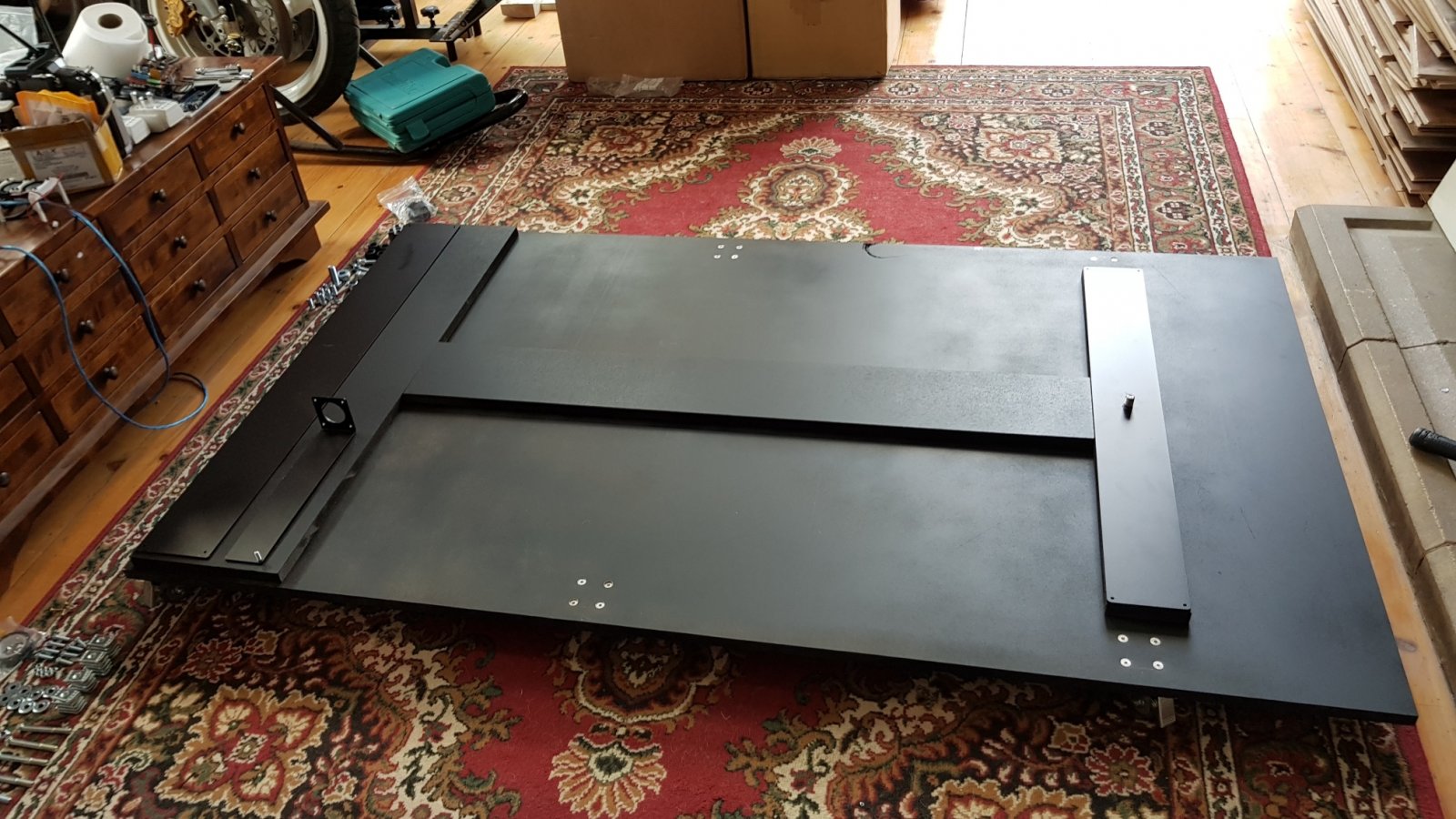

    Yes I received and built my T1000 5DOF, I am very pleased although I would highly recommend building the unit on an 18mm MDF base platform on wheels (mine is 100cm x 170cm but the 5DOF is longer than the 3DOF so you will likely need something more like (100cm x 120cm (to 150cm depending on if you want somewhere to mount the driver units).

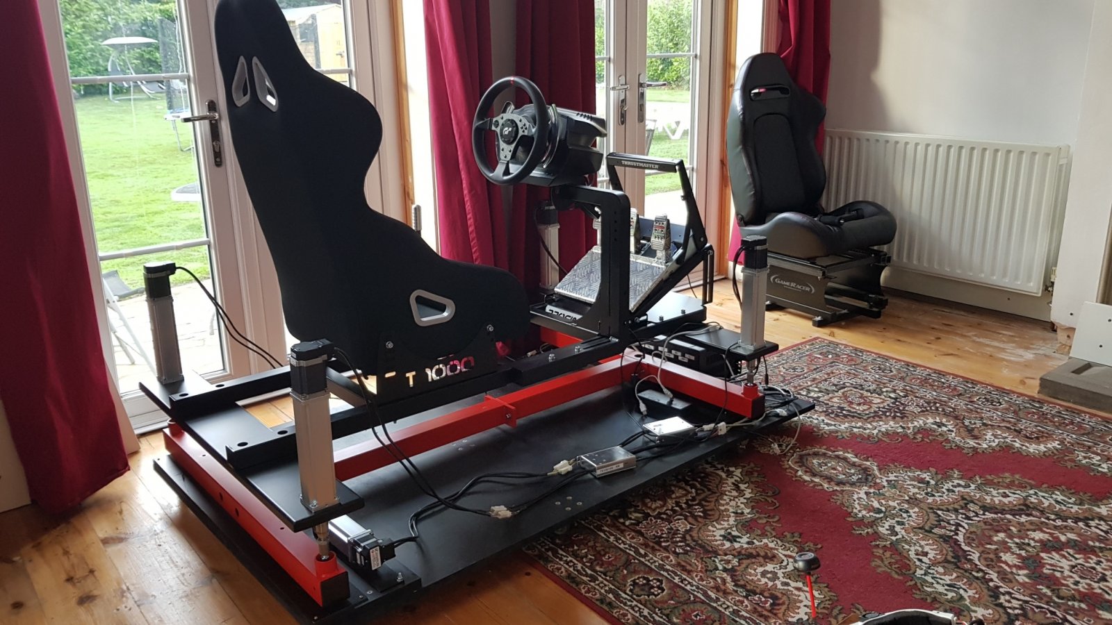

    Here is the finished unit:
    I will be extending the servo driver wires so that I can mount all the electronics (apart from the main box which I will likely house within a small data box along with my transducer amp) to the front of the platform and hide all the cables.
    And here are the end caps that help finish, the big ones are 65mm x 65mm and the smaller ones are 45mm x 45mm

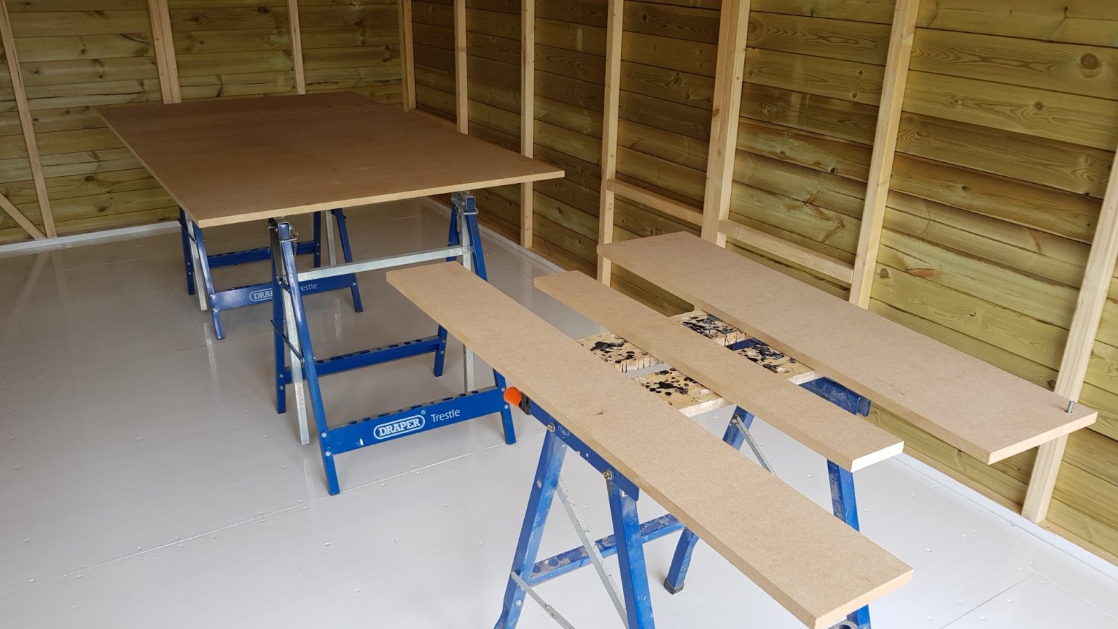

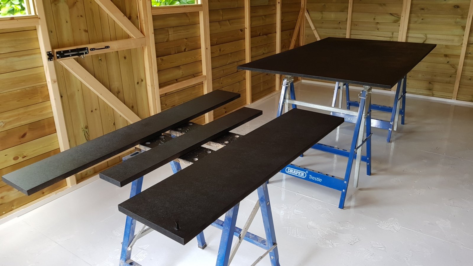

    Here are some pictures of the base build:
    The parts came unpainted so I sprayed them matt black:
    Ended up like this:

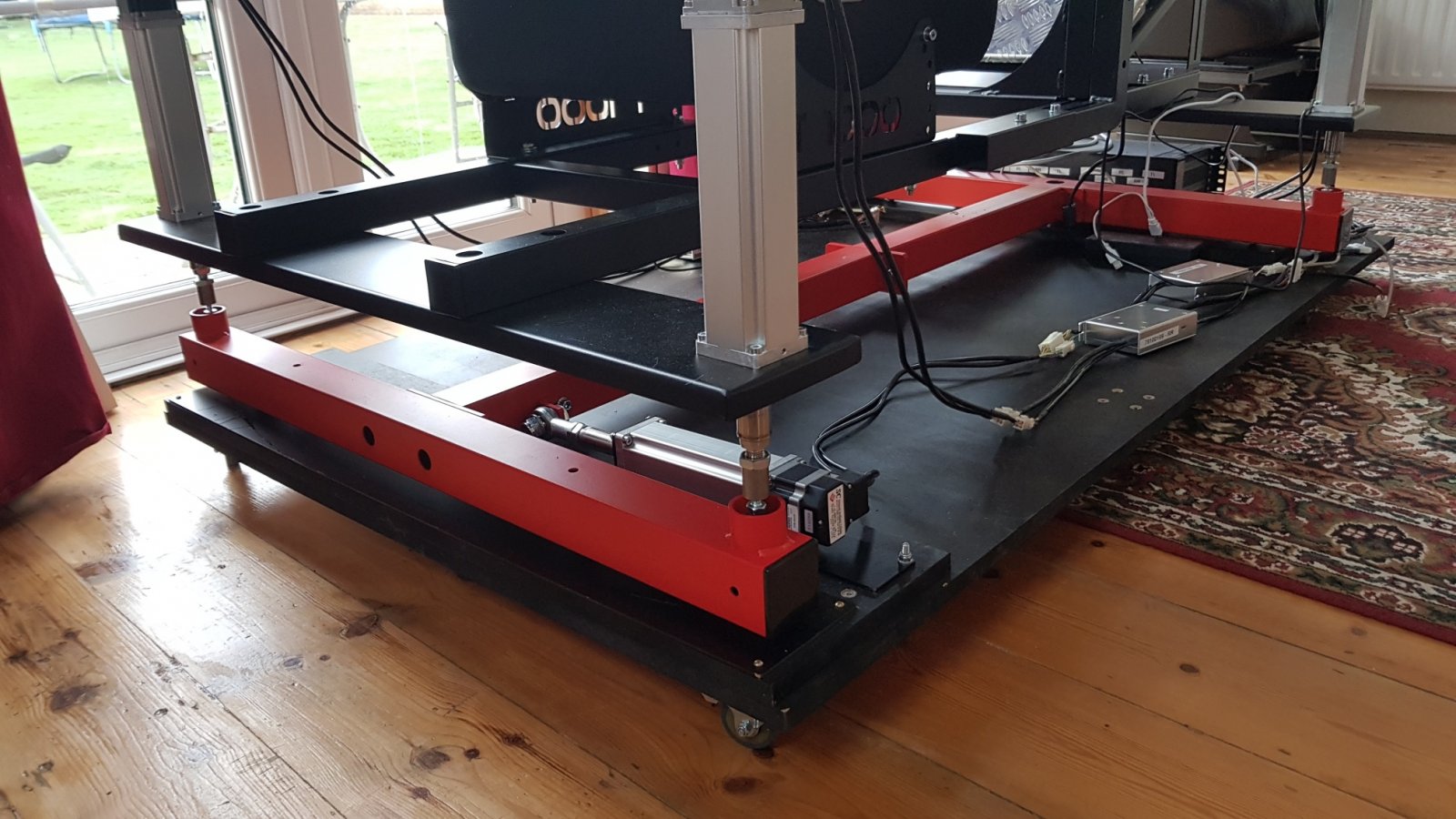

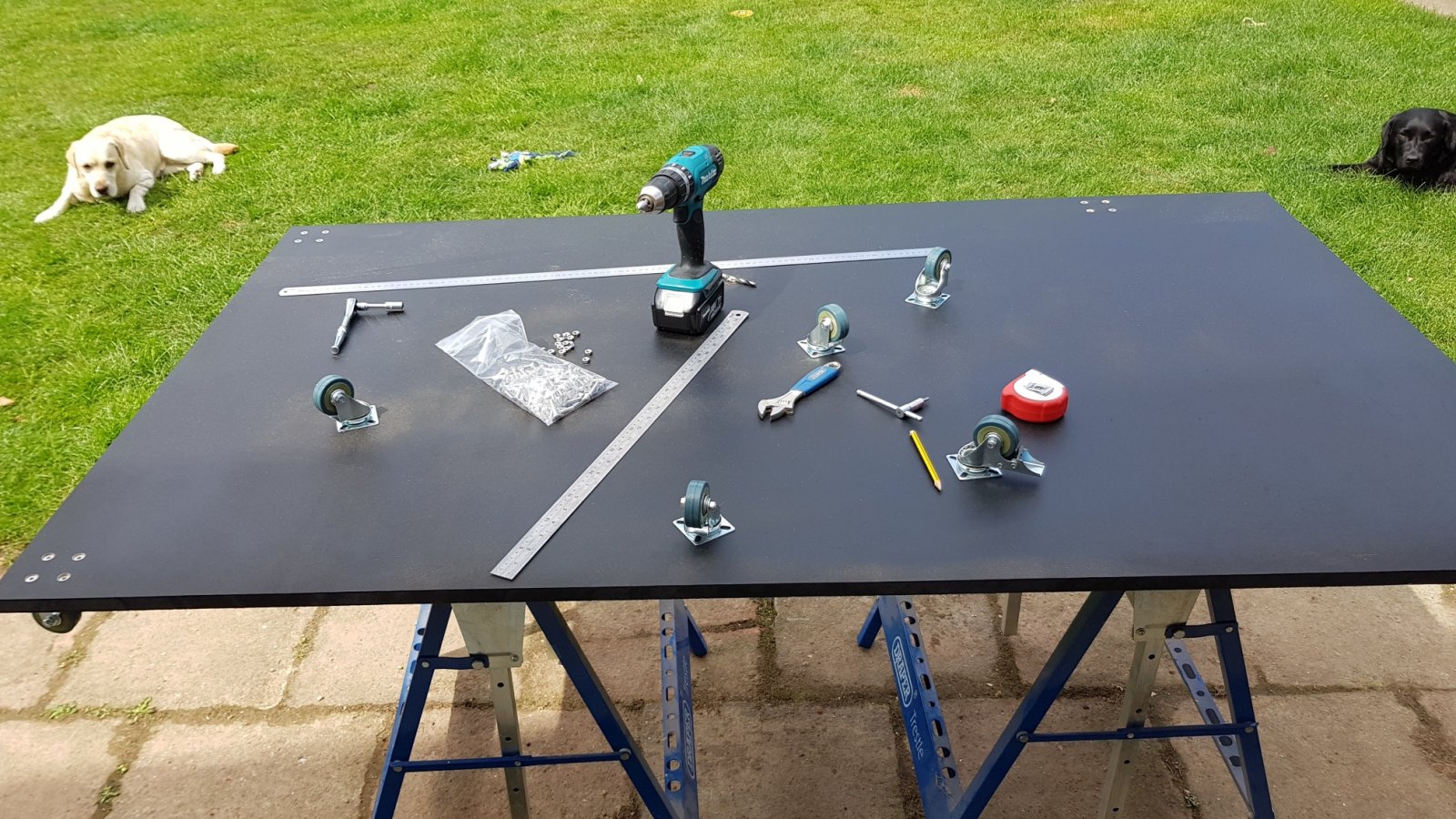

    Fitted some wheels using countersunk stainless steel bolts:
    Although it is not shown below in the end I bolted the two parallel MDF pieces directly to the base again using countersunk bolts and I also removed the centre bar as it really was not strong enough to maintain any sort of structural integrity:
