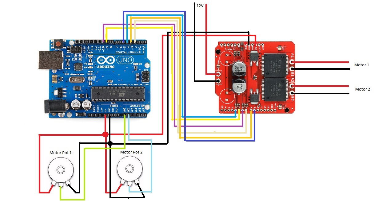

    Here is the way i have wired it up

    @Bruce he is using the MM for one motor that's why he is testing it like that.

    Ok cool thank you for clearing that up, i am thinking my MM are just cheap crap ones

    Looks correct to me. If you are turning the pot by hand the motor will turn in one direction when the green line is above the blue line and the other way when the green line is below the blue line on SMC chart.

    Yes Rufus, everything is fine until i connect the motors then it is very jumpy, and notchy.

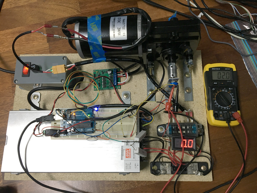

    Got the motor today (Excellent shipping service MD!), but not the MM's. I just need to rig up a feedback pot and all should be good to go. Damn that motor is beast! It's a shame I can't squeeze them into my rig or else it really would become an ejection seat.
    I've looked at SMC3 and it is directly compatible to my existing setup so I should be able to get stuck into testing over the weekend.

    No problems at all starting up SMC3. Excellent software Rufus!
    @Bruce
    After a bit of testing I think I've got some values for you that you may be able to work with. I've used a different controller board but the values should be close. The tuning is not perfect but okay for this purpose. I am using an Elechouse 50A motor controller board. I will connect the MM when I get it and compare results. The pots I am using are Bourns cermet 10K steel shaft pots from Element14. http://au.rs-online.com/web/p/potentiometers/7377650/
    I hope this gets you up and running. If not and you are still having problems then we will have to wait for the MM boards to test. (I will be throwing them on this test rig to verify the quality of them anyway!)
    P.S. I've just discovered that PWM Min Max values are binary = 255, not percent. So you could up the PWMmax a fair bit to give the motor a heap more power.
    P.P.S. I've just read that the VNH3SP30-E only takes up to 10KHz PWM frequency, So you may need to drop the Fpwm back to 10KHz or less for better power performance.

    I was able to do some tests with the MM boards I recieved. They test okay. More noisier than the elechouse boards. Gains very different though. This was a ball park setup. I hope the board you recieved fixed the problem.
