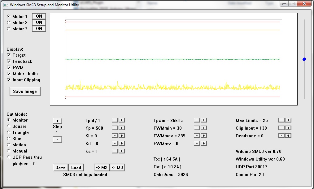

    I am about to upload a couple of videos, Couple things i notice i set the SMC3 utility software to sine, and i notice the green line is very jaggy? it is not smooth at all even when i first tune the program on the green line is fluctuating really badly. I am not sure if it is just still quality pots that is causing my issue, but 1 thing i can 100% say if there is no play in the shafts to the pots.
    The Left motor is even worse, I thought my Arduino might be faulty so i put the code in a brand new unit then tested that with the same result, Then i thought it might be low power to the motors, so i am using a car battery and then a 40 amp charger on that, no voltage issues now.
    I am wondering if my motor shield may be faulty as sometimes it just drops out and i need to depower it to get it to go again, also you can see on the utility software that then green lines drops out and does not follow the blue one all the time then it starts again? Dont know what that is about?

    what pots are you using. the green line should not have a lot of interference. this could be a number of things. bad grounding or bleed thru from the 12v side, poor quality or worn pots (use hall sensors). try turning up the deadzone. anything over 5 in the deadzone and you need new pots. also fpid should be set to 1. turn reverse down to about 50. add some kd maybe 5 to start.

    I reckon there is a fault with the moto monster board i am using, just done a test by hand and the line no matter how fast i move it without the motors powered up the line is smooth and responds straight away. Therefore i am ruling out any issues with the pots or the set up of the pots, as soon as i connect the motors back up and set the utilities program to sine and let it follow motors follow it i notice the motor control is very jerky in its movements. Both motors are brand new and if i hook 12 volts they run fine forwards and backwards by reversing polarity. (Smooth as)
    On the moto monster board i notice that the direction indicator light for the motors flickers and does not stay constant when the motors are running, giving the jerky movements, but when the motors are not running (powered up) i notice the light is constant all the time for either direction.
    It is almost like as soon as the board is required to drive power to the motors it goes haywire. These boards are just cheap ones of ebay that i found here in Australia. I don't know a supplier for the proper boards over here otherwise i would buy a good quality one.
