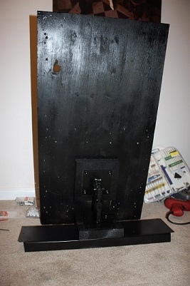

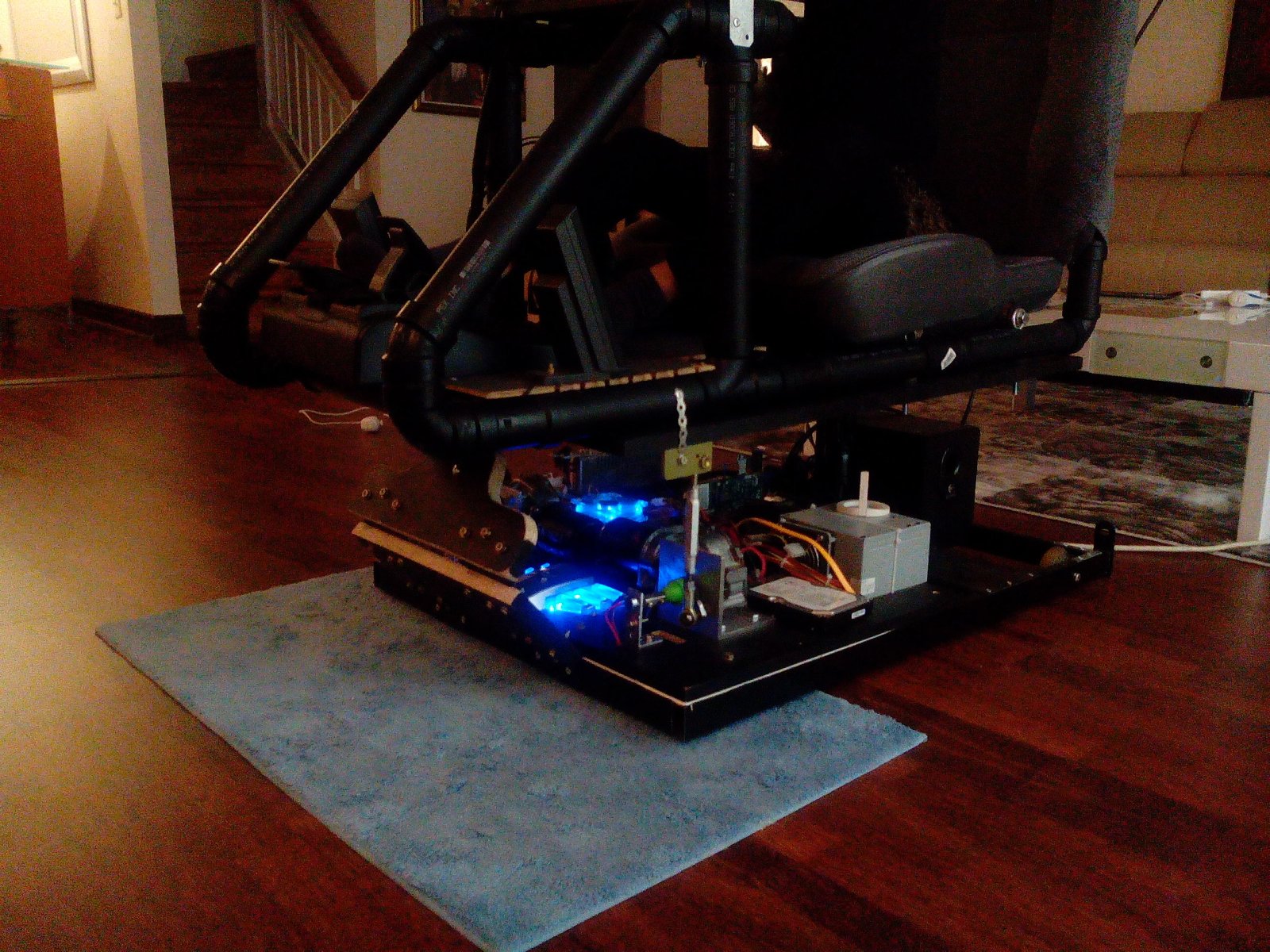

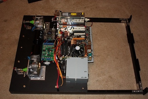

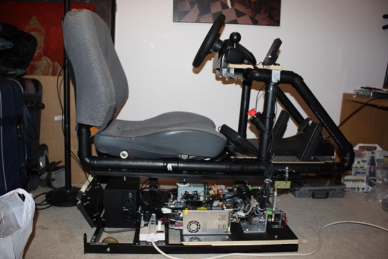

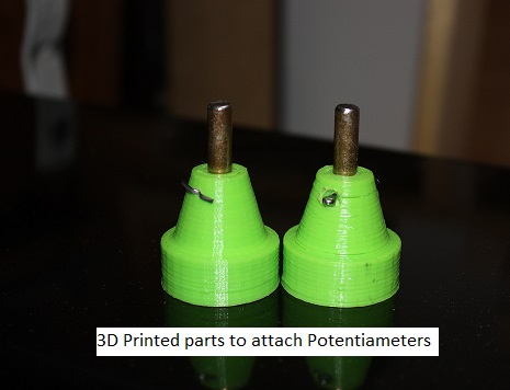

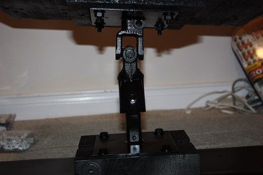

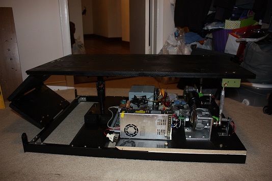

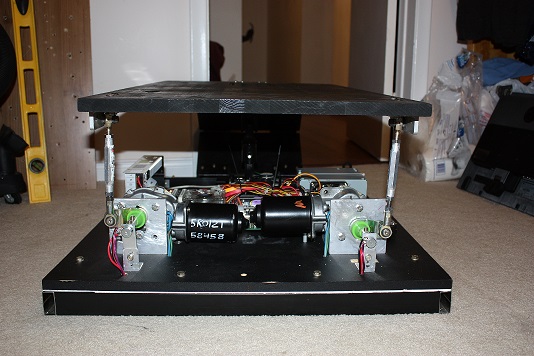

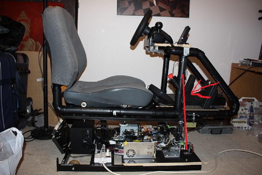

    Hello All,
    I've finally completed my built and here are some of my latest pictures.
    Special thanks to eaorobbie, Yobuddy & bsft for helping me throughout the built.
    Cyberxu

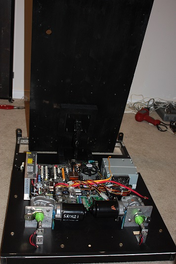

  2. bsft
    Good stuff man, another PVC build. I take it you found the PVC light and fairly easy to put together.
    Should move ok with wipers.
    If you find it struggles a bit, space the motors out a bit and move the connections higher up on the frame.
    Piece of cake.

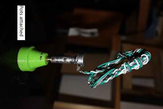

    Great job @cyberxu :thumbs
    Can you add some written details like what the motor specs are, what pots you used and so on?

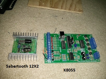

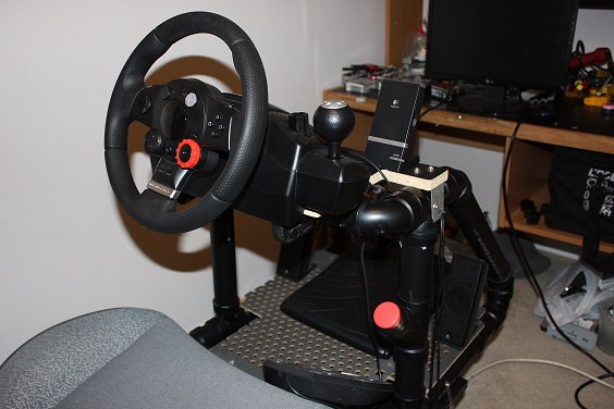

    Hi noorbeast,
    The wiper motors I used are honda odyssey which I pickup from junk yards for $25.00 CAD each.
    Seat is from honda civic also from junk yards for $30.00.
    Electronic are k8055 (US$45.00), sabertooth 2x12v (US$85.00) and an old duo core PC ($0.00) which I found in my basement. Lol....I also gone through a lot of 10k potential meter which are cheap $1.00 each.
    I think I most expensive part I spent is the steering wheel... $90.00 CAD (refurbished).
    Pvc piping from home depot ($60.00) and plus hardware as well.
    Cyberxu
  8. cyberxu
    cyberxu Member
    Nov 22, 2012
    64
    AME Planner
    Ontario, Canada
    516Coins
    +31 / 0 / -0
    2DOF, 3DOF, DC motor, Arduino
    Pvc build is so easy and light weight, I love it. I have to move my stabilizer hinges from the back to front where my motors located. It gives me more solid feel.
    21,592
    151,215Coins
    Nice one @cyberxu.
    Have you considered mounting the connecting point higher on the frame as @bsft suggested? That would help a great deal as well and take a lot of strain off the motors.
