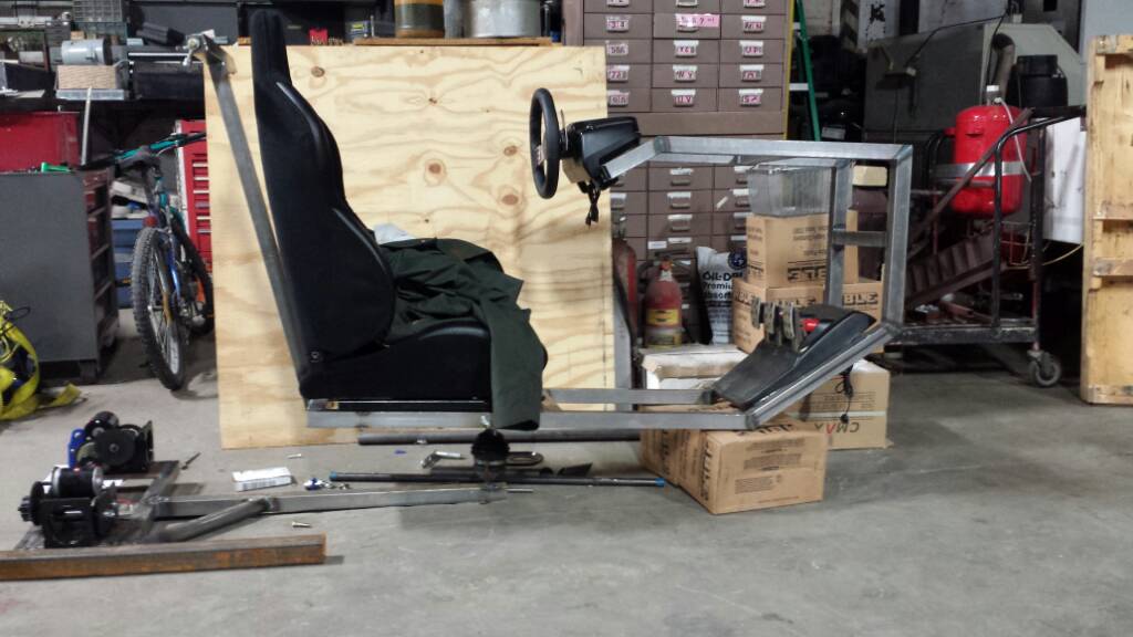

    yes, like in this pic of my seat mover, but same for full frame. The higher above centre of gravity, the better.

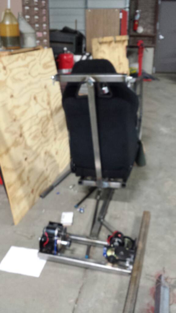

    What do you guys think?
    Sent from my SAMSUNG-SGH-I337 using Tapatalk
  7. bsft
    yep looks good. The winch motors should do some damage.

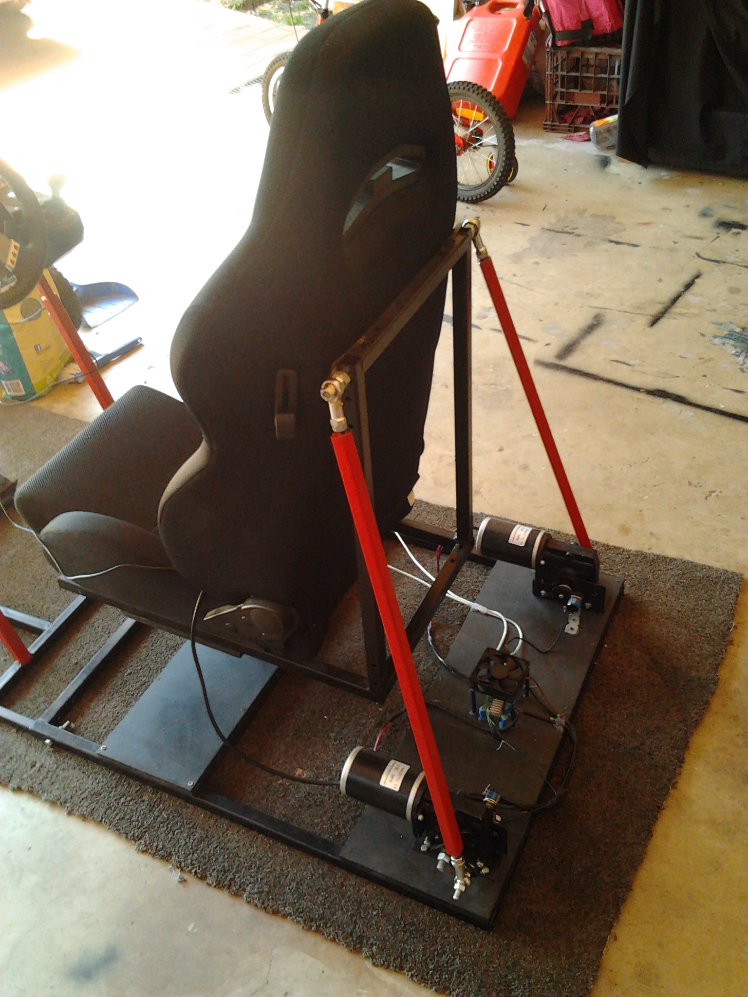

  9. eaorobbie
    20,488Coins
    +1,687 / 23 / -2
    ? do you plan to place monitors on to this frame too.
    if yes then the pivot may not be in the optimum location, ie you need to take the top frame, place everything on it that will be on the sim and place a pipe or something you can rock on, and get in and have some one move it back and forth until the balance position is found, then (just what i do put a mark about 10mm(1/4") forward of the balance point, I found by slightly loading the winches will removed any possible backlash in the gearing that may or not develop, which it didnt, as ,my frame was very light, 25x25x1.6 box section construction and no monitors.

    I'm not planning to have the monitors on this frame... still don't trust the winch motors
  11. bsft
    you dont trust the winch motors? why? They throw Historiker around no problem.
