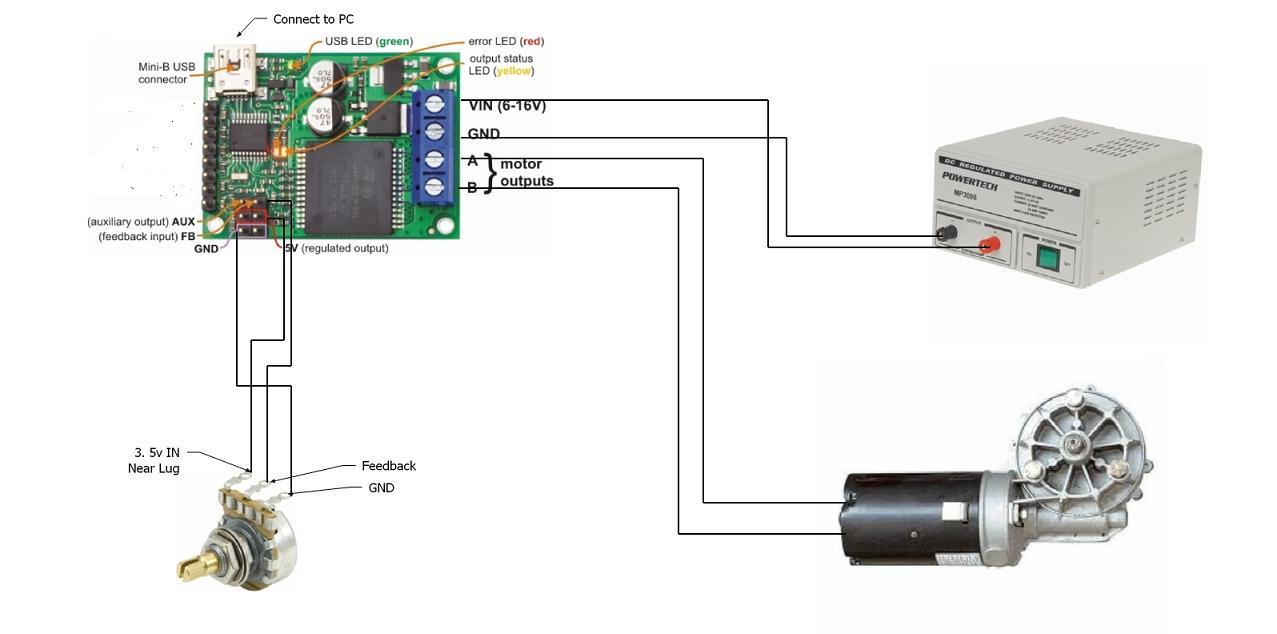

    And those go to the jrks? Do you know of a diagram
    Sent from my SAMSUNG-SGH-I337 using Tapatalk
  10. bsft
    Obviously connect pots to the motor lever somehow , I use gears and a multiturn

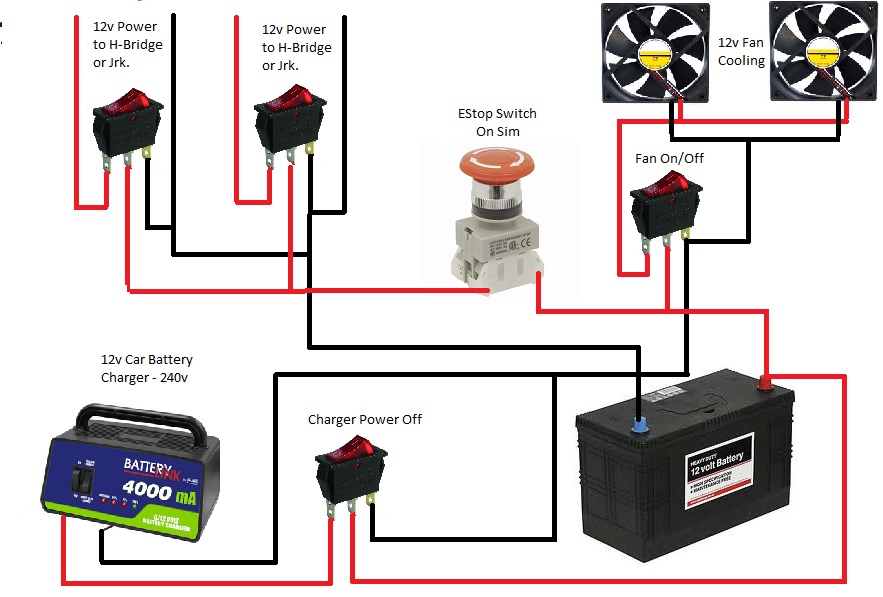

    Is there any reason that a 1200W pc power supply wouldn't work for a build like this...will the jrks draw too many amps or is it something to consider?
  20. eaorobbie
    20,503Coins
    +1,687 / 23 / -2
    Others have used similar items mate. I use a 12dc battery configured like below for ease.
    but these look alot better and once installed and wire not much cheaper.
    http://www.ebay.com.au/itm/1A-2A-3A..._Power_Boards_Cables&var=&hash=item3a8669a1cc
    12volt at 30amps - $68 each.
