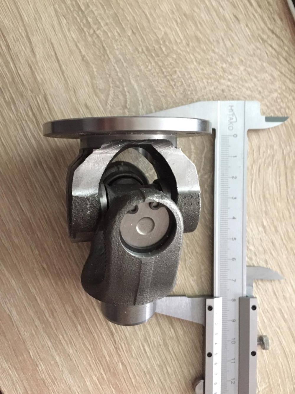

    Soo some shopping arrived, followed by more questions:)
    Fanatec CSW V2,5 complete pack
    Front pivot bearing for TL, casters and "marble mover" (do not know the exact english world for that, did not decided yet if i use those or casters..), PSUs
    3*SCN6 20-150 + Frex Motion 4 + Frex Wires
    And here comes the question about power for scn´s.. I thought that you all guys are using 1 psu for 1 scn.. But frex send me just one power cable for all three SCNs so i guess they count that people use just one supply? I have this PSU´s (24V of course) but i´m afraid it won´t be enough for 3* SCN6?:( Would like to use Frex´s cables when i have them now, so i will probably put this psus back and take one proper one instead.. Any reccomendations from Meanwell preferable?

    Need some little help here with Simtools - it does not recognize SCN at all:(
    Connected all properly, nothing happens. After long searching i´ve find out the "change accurator id" thing, installed TBVST soft, started the Visual Setting tool which recognized SCN immediatelly and i can play with it via this SW. However, the ID was set to 0 already, so there was not a problem there:( But when this works i guess i have all the connection and com drivers etc ok...
    If i try x-sim sw then at startup the acurator moves.
    Only Simtools is dead completely:( any ideas?

    Update - connected second SCN6 and it´s working.. DO not understand how / why, but it does:D

    Some more work done on a frame yesterday..
    SCN bottom mount and dampening (silentblock 8*6cm:) welding not finished on this picture yet..
    Adjustable pedal mount
    Tracktion loss SCN mount
    And (almost) finished frame...
    Righ now i´m waiting for custom SCN braclet, were not able to made it by ourselfes, do not have propriet tools.
    I´m wondering, shall i add more silentblocks to the other side of rods - to the SCN brackets?
