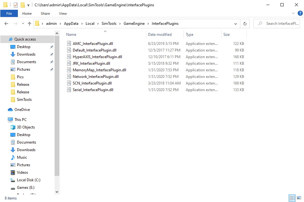

    I'm new to SimTools (but not to programming) and am trying to install latest pro version 2.5.1 on a win10 pro pc. Software installs ok (into default location and default settings), I have purchased and installed a valid licence, the latest net 4 is installed but I seem to be missing the default_interfaceplugin.dll (nothing shows in it's directory) which is causing error messages when starting the program, I can get past this but the program won't run properly of course.

    Has anyone a solution to this - possibly a pointer to download the missing dll ?

    Nothing at all?
    Should look like this:
    If not, i would reinstall SimTools.
    (you can install right over the top of the old one to fix this.)

    Thanks for the quick reply. I've already tried uninstalling (using the win uninstaller and then manually deleting the directories in users, except licence dir) and reinstalling the prog in default and another directory, all times the interfaceplugins directory is completely empty. Will try installing as admin (notes do not mention this) then with av off (kaspersky). Let you know shortly - also I did download the ms flight sim plugin which loaded ok but I can't find where that was put.

    After a lot of install/uninstall on various computers I've managed to understand and solve my problem.
    1) Simtools prefers to be installed in an admin level account (installing in a standard account with admin override will install some but not all files). It worked ok on this computer but I couldn't find the admin\AppData\Local... files
    2) My antivirus (kaspersky) wasn't the problem, leaving it on/off had no effect
    3) My computer is needing another clean install of win10 (I do a lot of programming that requires me to deliberately crash the system and eventually the gremlins sneak in) - my admin user group is not showing in explorer and when I force it to show it hides the apps dir.
    4) Installing on another pc (laptop) still required to be in an admin account but everything works as it should
    5) Copying the admin\AppData\Local... files in the laptop SimTools dir to this pc in my normal user account got everything working as it should (and there where way more dir's and files than originally installed at the start of play today)
