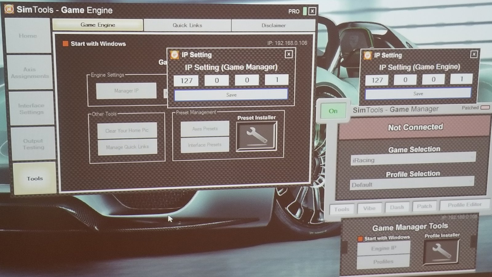

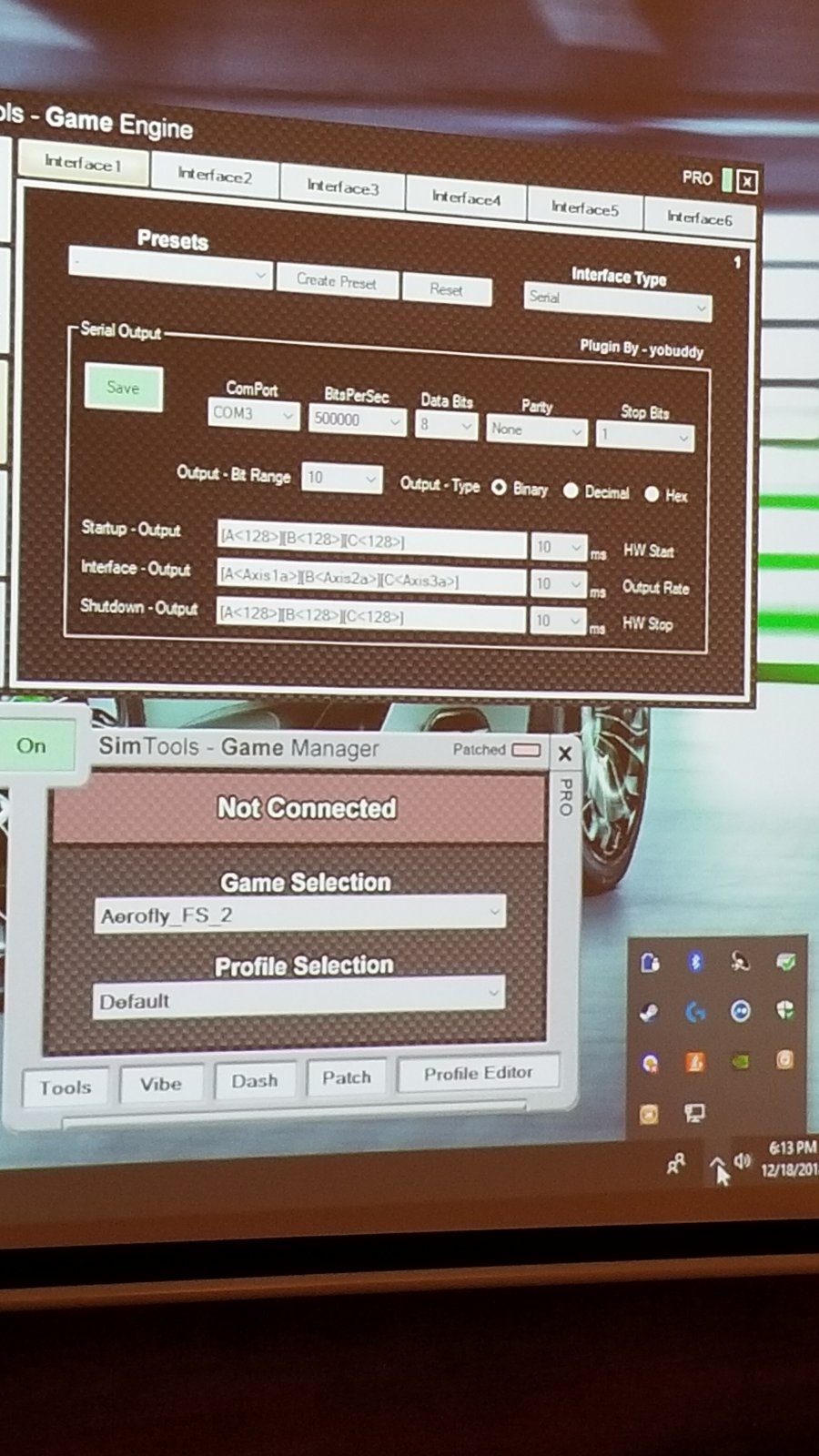

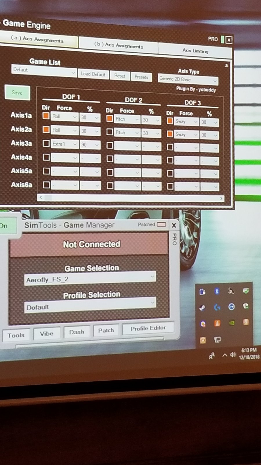

    Hello everyone, my name is John and I am nearly done getting my new DOFReality H3 up and running. I have followed all the instructions and videos supplied by DOFReality, and their tech support has been great in getting me this far, however I seem to have another issue. I hope I'm just missing something simple.
    I can use SimTools to drive my rig, all my motion occurs correctly. So now I am trying to get the rig to work with iRacing. Its the sim I use the most and why I bought the H3.
    From my understanding from the online docs... the Manager reads "Connected" when it is communicating with the Engine, and reads "Game Running" when the program is running as well. I never see Connected or Game Running.
    As you can see from the images below, I am running both the Manager and the Engine at the same time, so I'm not sure why they are not connecting... (Again, please forgive me, I am new to this). I have tried to run the game and "patch" it, maybe I'm doing it wrong, but this hasn't change my "connection" issue.
    Any insight would be most welcome,
    -John

    Hi @John Wilson,
    1) My I see a pic of the GameManager with IRacing showing rather than Aerofly_FS_2 please.
    2 )Also, please goto "Tool" in GameManger and may i see a pic of the "GameEngine IP" settings.
    3 ) May I see a pic of the GameEngine IP settings. In GameEngine got "tools" > then "Manger IP".
    Chat soon,

    Here is the picture, I was hoping to see 2 different IP's and have my answer, but looks like they are set correctly.

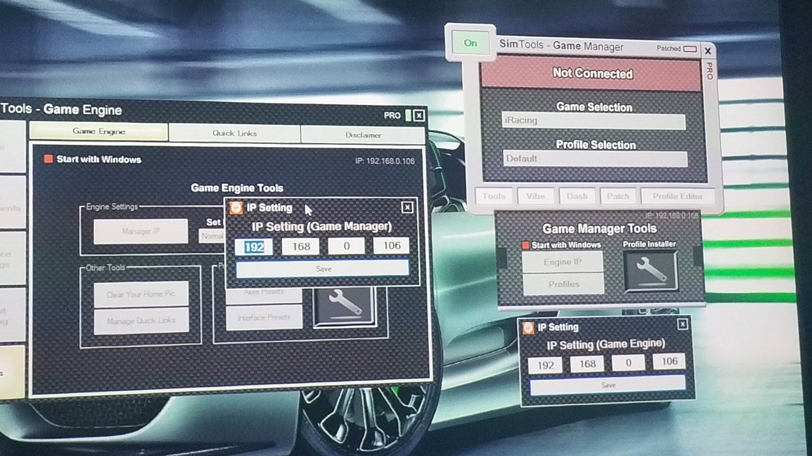

    I see the both the manager and the engine had what looked to be local IP addresses in their screens 192.168.0.106.
    I thought perhaps this was the IP address that each program had acquired somehow so I changed both the manager and engine IP addresses to match this number. No change. Restarted the computer, no change. Just an update... There has to be a reason my manager never says connected.... There has to be a way for me to get this rig working.

    Can you please return the IP settings to 127.0.0.1 and then test in Output Settings->Turn On then use the sliders to see if the rig moves.
    If it does move then my guess is you have yet to create Axis Assignments or patch the game properly, if it does not move then you should probably contact DOF reality, as there may be a hardware issue.

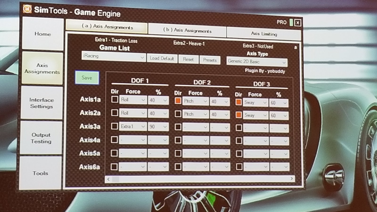

    So can you please confirmed that you have created an Axis Assignment for iRacing and please post a picture of it.

    Hi @noorbeast,
    Below should be an image of my axis assignments for iRacing.
    DOF Reality has been very helpful up to this point. When I discovered the issue with the game manager never connecting their response was, and I quote "Strange. Pls install simtools 2.3.1 simtools.us and if it wont help pls open a ticket with simtools.us"
    Again everything with their rig and the game engine appear to be working properly, good motion, correct axis assignments and movement. I can't help but get past the idea that my problem continues to be a communication issue between the engine and the manager. Exhausted at this point so after my initial attempts as creating a new firewall rule I'm going to take a break and revisit.
    All suggestions welcome and I will do my best to respond.
    -J.p.
