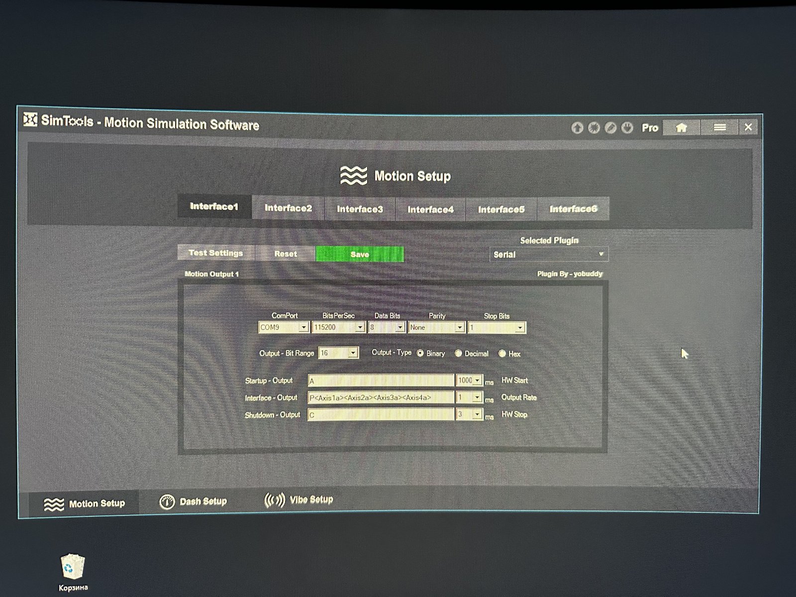

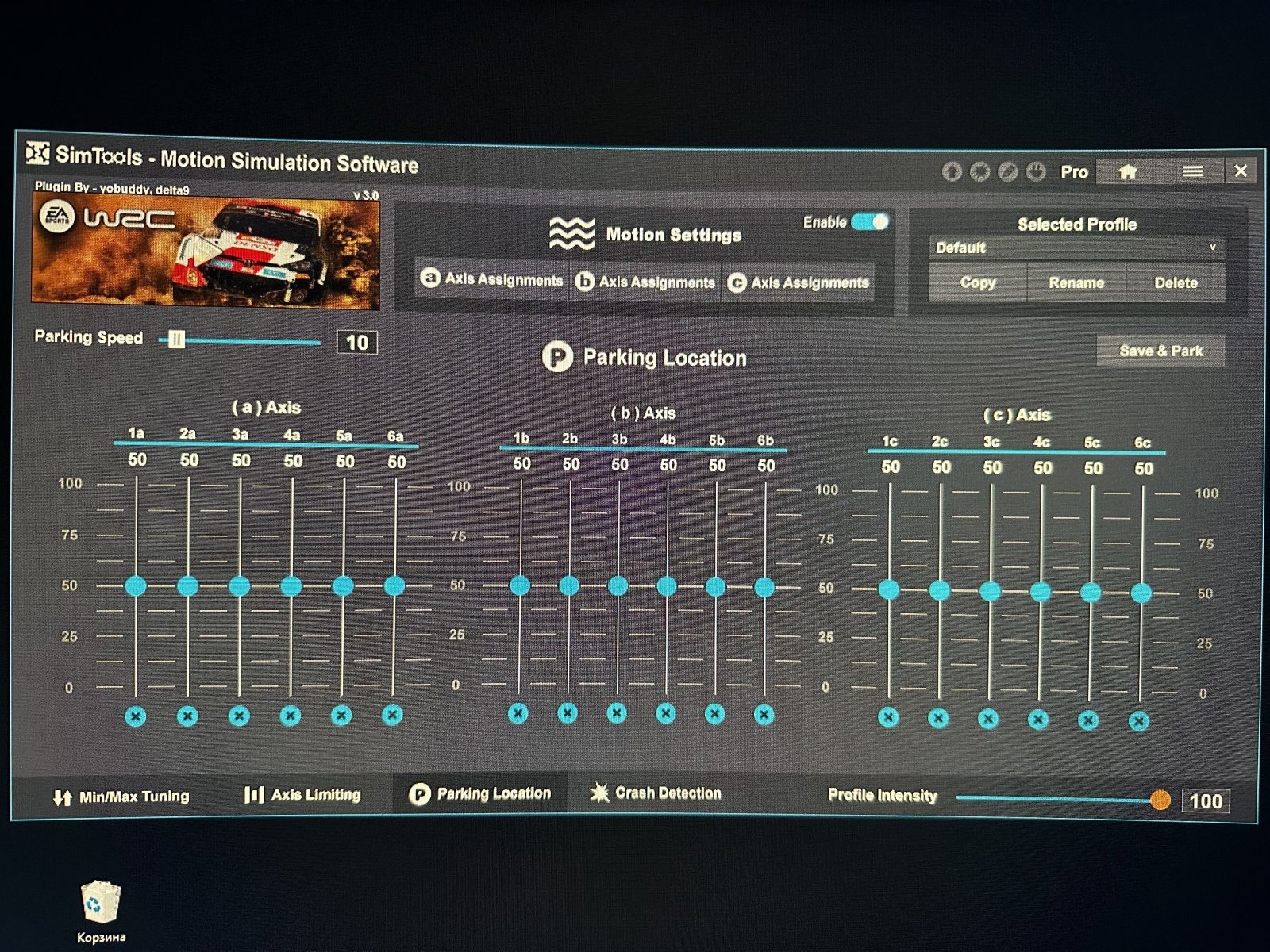

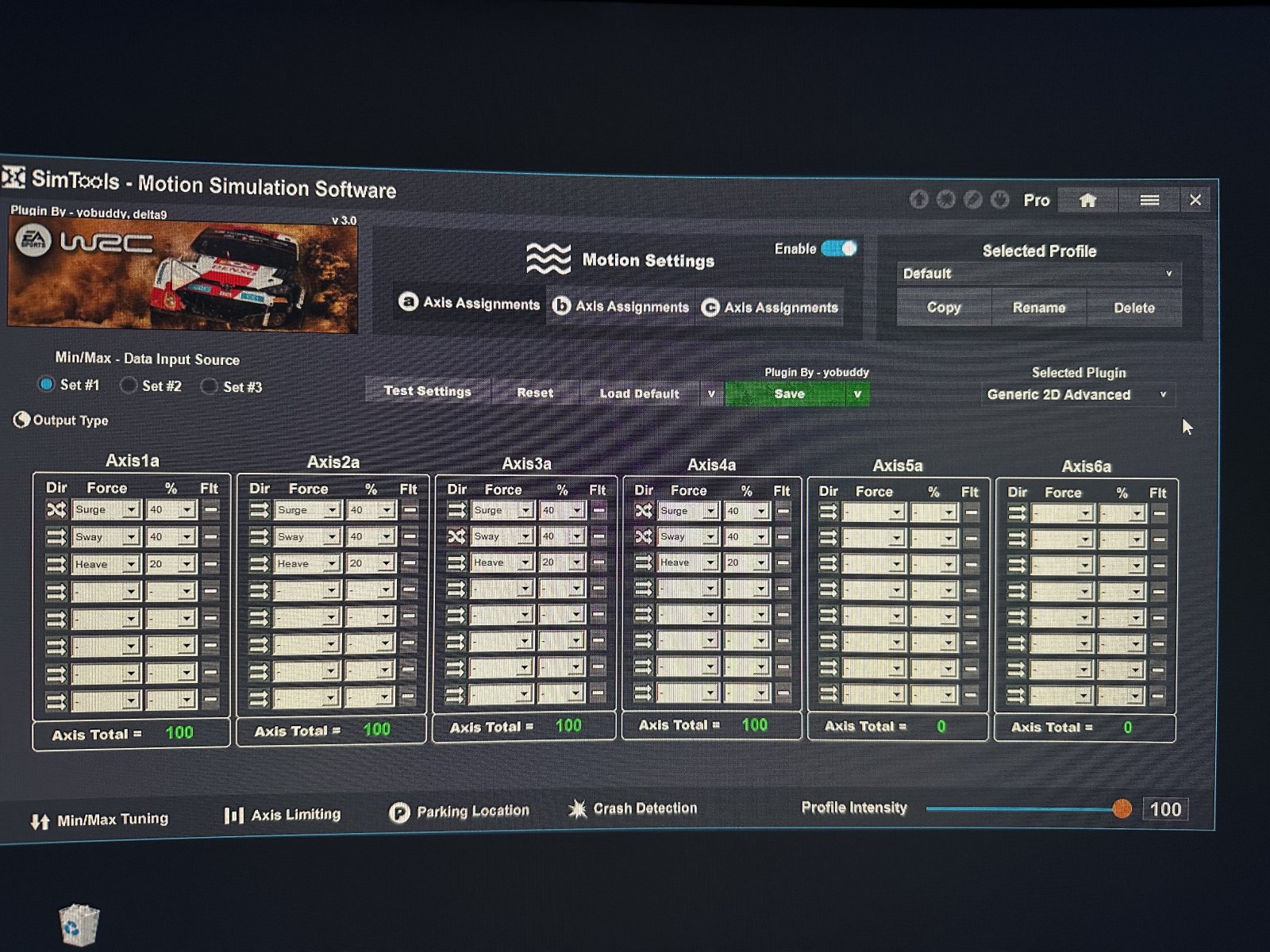

    I can't see what your doing on screen in the video, but everything looks right except parking location.
    May I see your parking location settings.

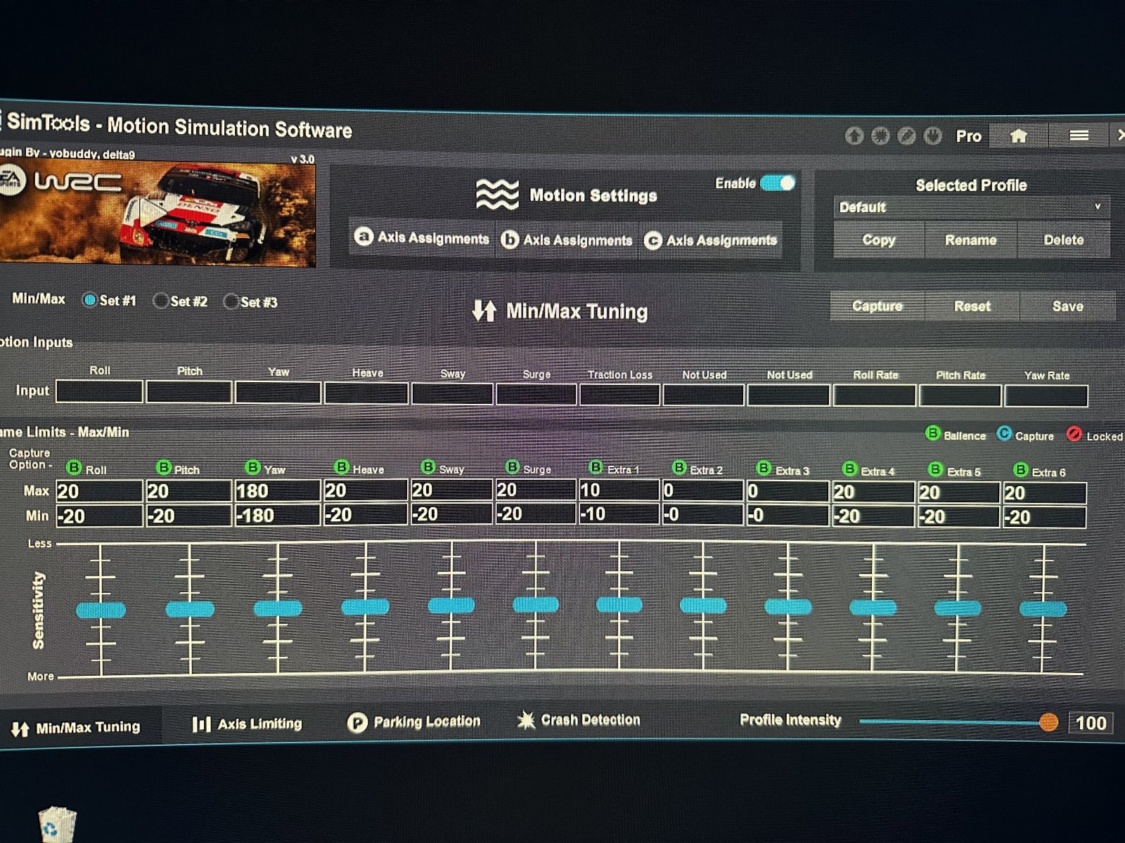

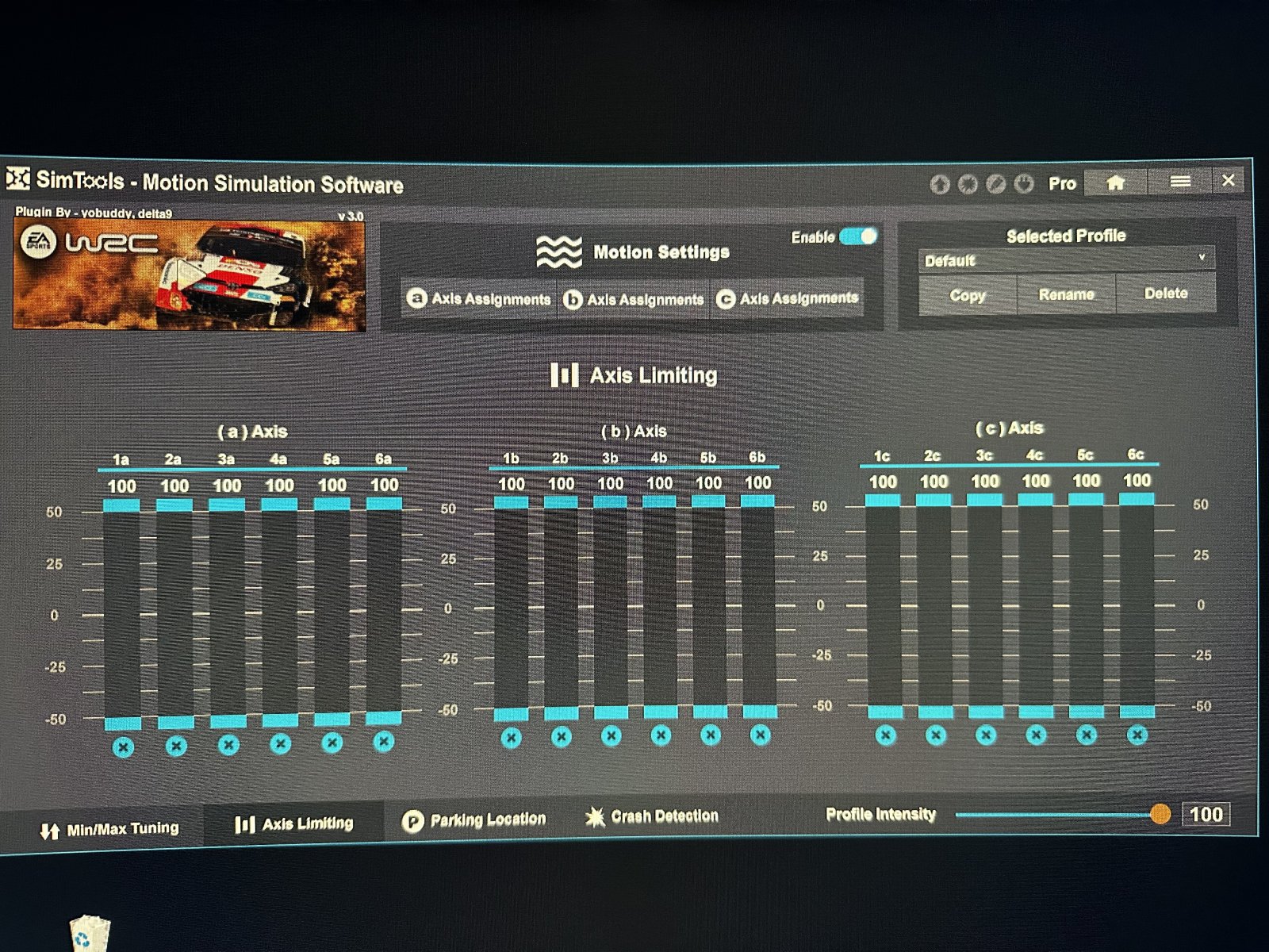

    3DOF, Arduino

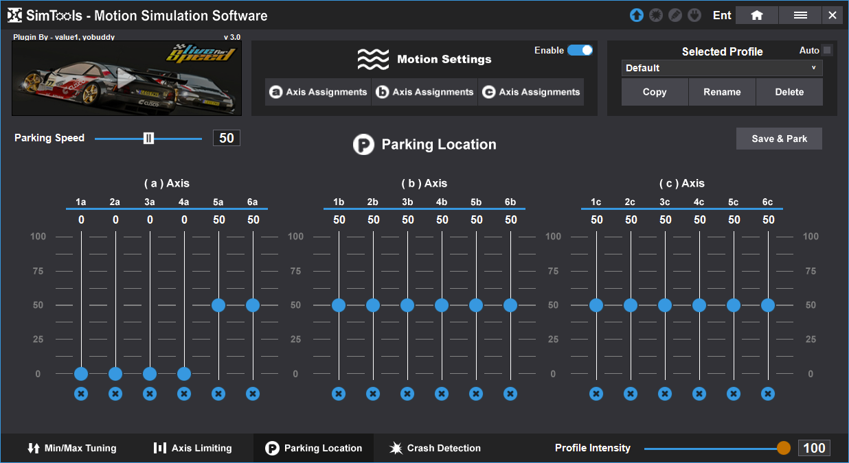

  3. yobuddy
    51,771Coins
    +5,206 / 19 / -0
    Please make sure you don't run SimTools and FlyPt at the same time.
    Set this page like this and click Save and Park.

    thanks . I'll try it tomorrow. tell me, do you need to change anything in these settings?

    Nope, your good to go!

    maybe I should try another interface plugin? I have serial installed, maybe I should install HyperAXIS?

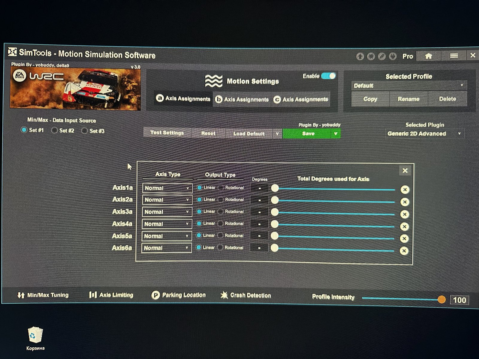

    Please help me from the very beginning. I thought that the WRC 23 game was not working for me. and there is. But I decided to check and downloaded plugin rally dirt 2.0, installed the plugin in the right folder. but the situation is exactly the same. I ask you to help me from the very beginning. I am ready to remove all programs and step by step perform the necessary actions from the very beginning. I don't understand where I'm missing something.

    There is nothing to install by hand?
    You use the plugin manager and they install with the click of a button.
    If you installing plugins by hand. this could be some of the problem I think.
    There is no way the hyper-axis or the scn driver will work with your setup, you need scn equipment to use that driver. It is defiantly a serial based Arduino sketch.
    As far as I can tell from you video, everything is working except the shutdown as the front goes to the floor?

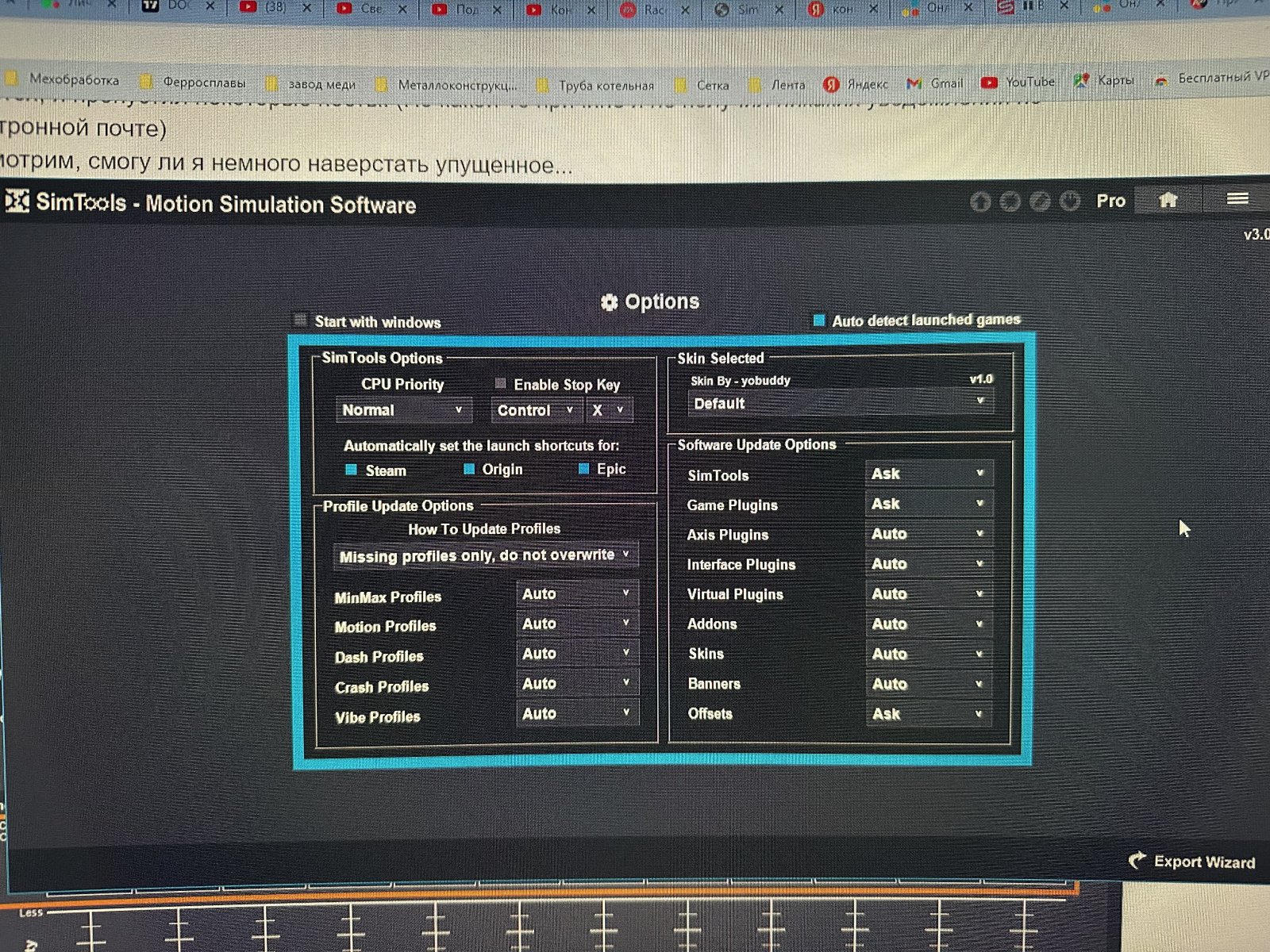

    What it means is that v3 introduces an integrated plugin repository system and installer, to avoid the very types of issues created by users doing unexpected things.
    So you access and install plugins from inside v3 itself.

    For some reason, drivers with a bitrate of 921600 do not work for me. They only work on 115200
    Perhaps this is the reason?
    my operating system is Windows 10
    Fly pt and simtools operate from 115200 to participate in the dirt rally
    it doesn't work with a different bitrate
