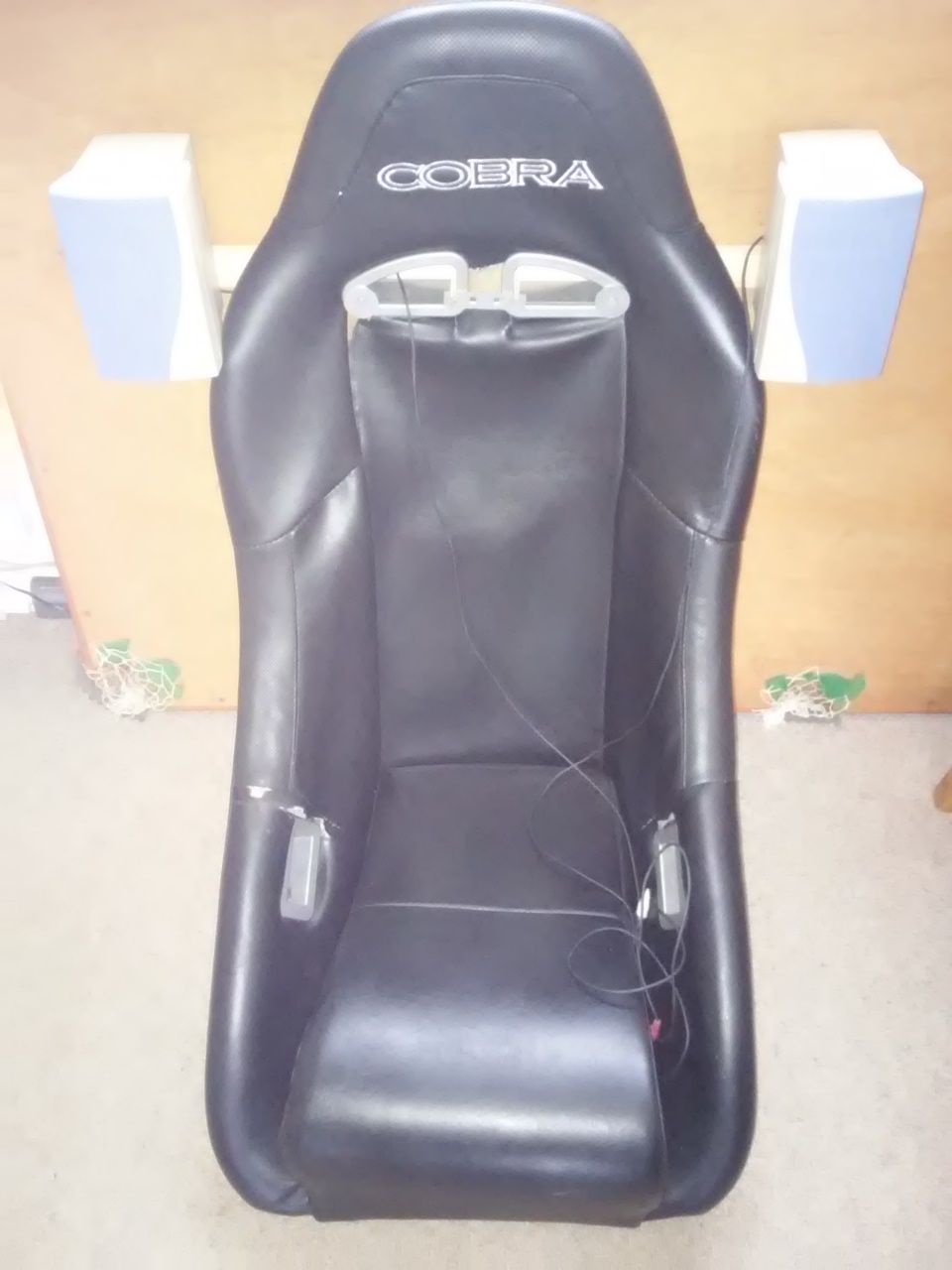

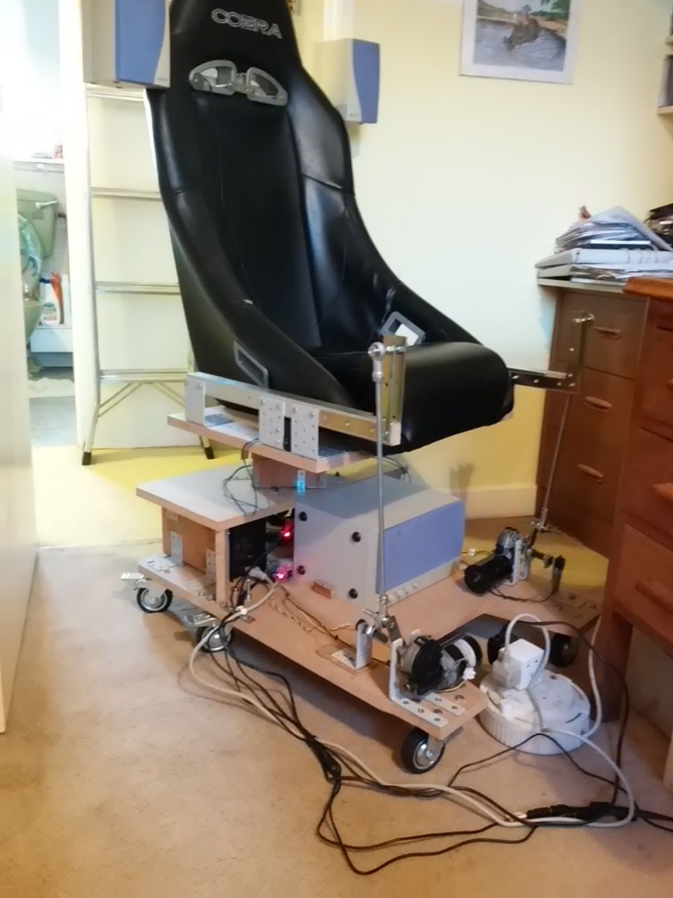

    Hi, here are some pictures of my working 2dof rig
    As you see I've a standard second-hand racing seat and mounted rear head speakers/

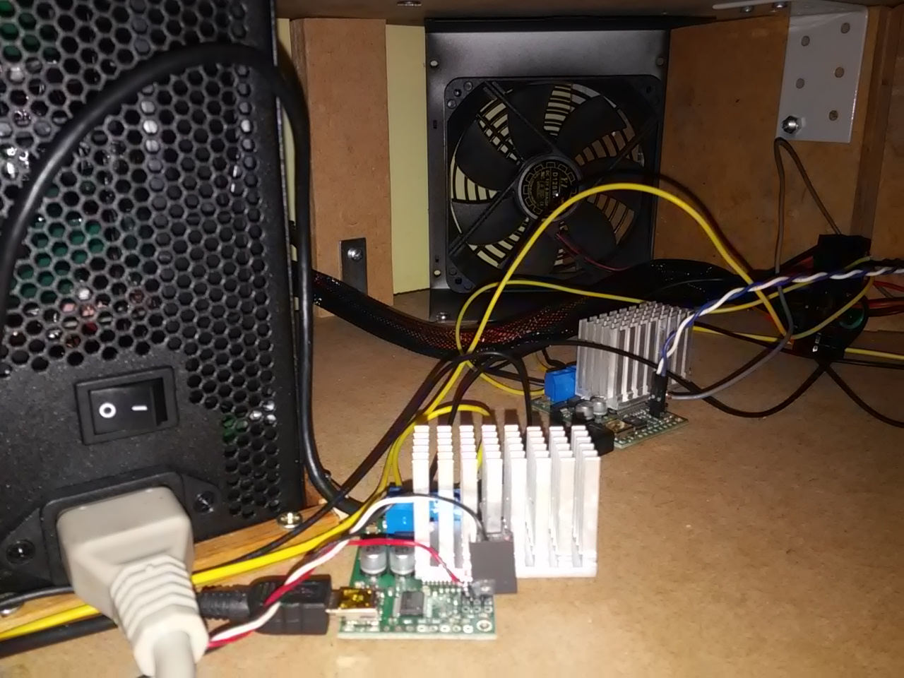

    I'm using a 760W Corsair PC power supply.
    I've use 2 JRK controllers and I added a PC aluminium heatsink (cut in half) and additional 120mm cooling fan

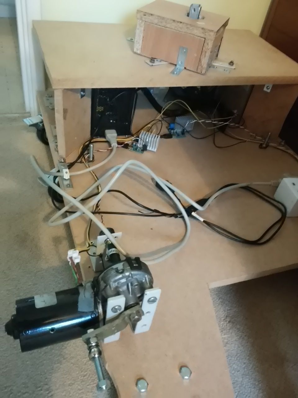

    I'm using wiper motors and external Pots connected via rubber tube and jubilee clips

    My seat is connected via M8 threaded rods and rod ends
    with bass speaker underneath, static on base.

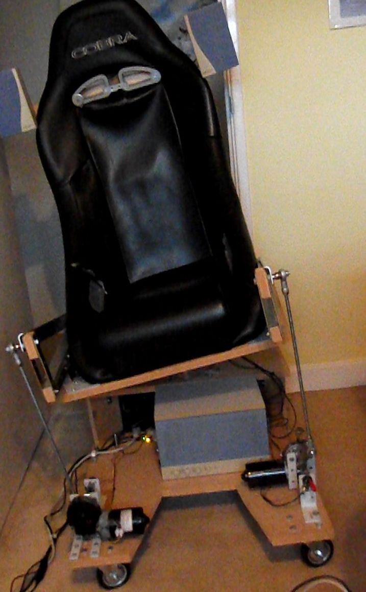

    I attach 2 pictures to show extent of current setup left & right movement: seat-left.jpg seat-right.jpg

    Sorry I haven't posted, I've been busy building.
    The moving seat platform was originally sheet MDF, with wood arms and lots of steel brackets.
    This was easy to adjust & change, until I had size correct. (I have limit space in single spare room)
    I now converted the moving platform to Aluminium which is rigid and lighter,
    but was NOT worth all the work as I only saved 4KG, but it does look better

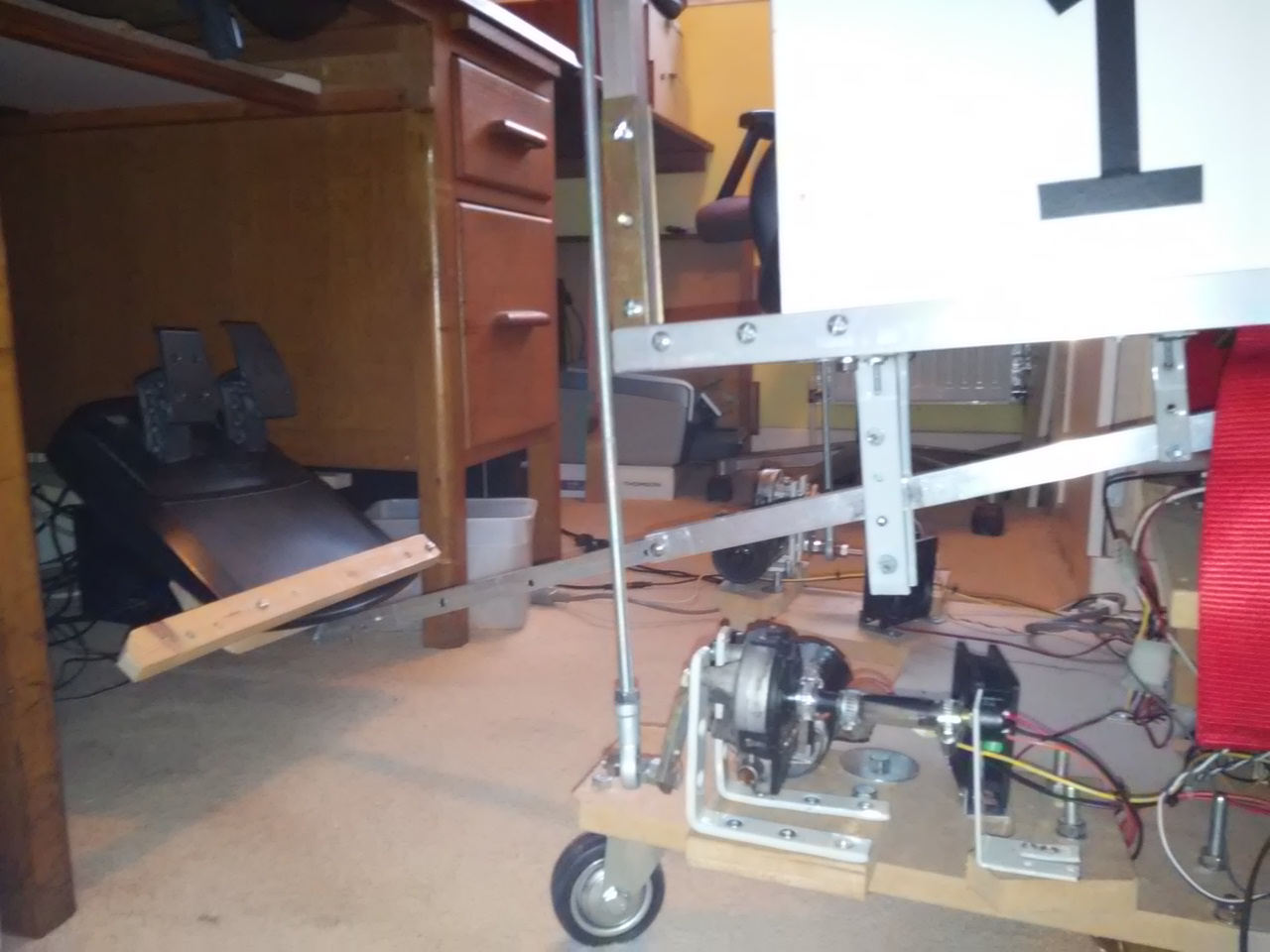

    I added a telescopic (so I can fold away) leg extension for foot pedals to move with the seat.
    I also adjusted seat back to re-centre extra weight caused by legs.
    This makes game feel much better (worth doing).
    Although wiper motors do struggle to cope. I added cooling fans and limit play to 1 hour at a time.
    I added, 2 Drayton TT25 vibes, which connect via a Levy 2024 amplifier, to centre and bass speaker jacks (in 5:1 setup).
    These work great, to engine vibration and vibration going over circuit rumble strip curbing (depending on game).
    I have spent a lot more time building then driving, but its a interesting challenge.

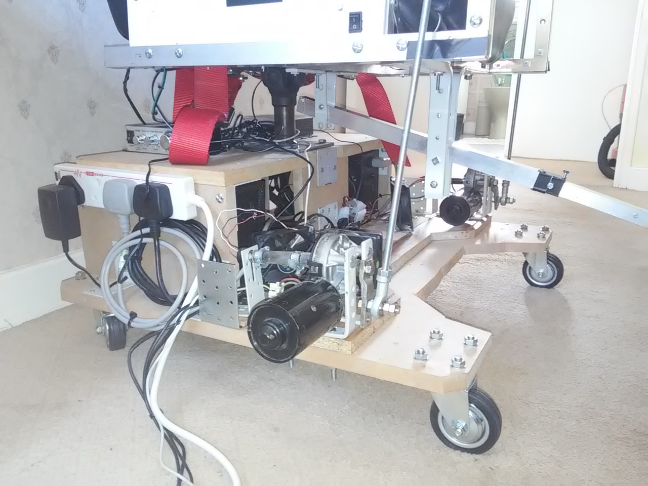

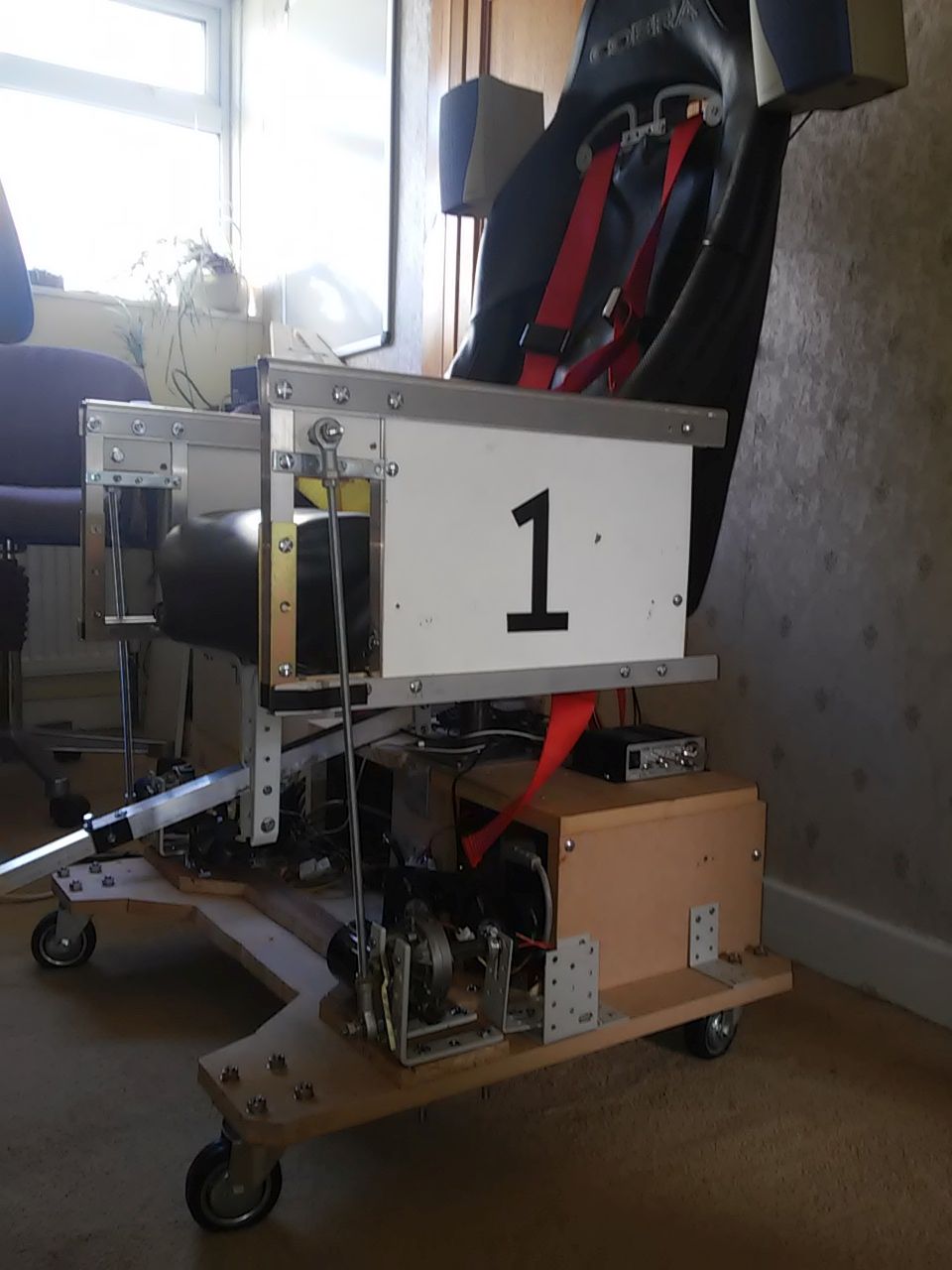

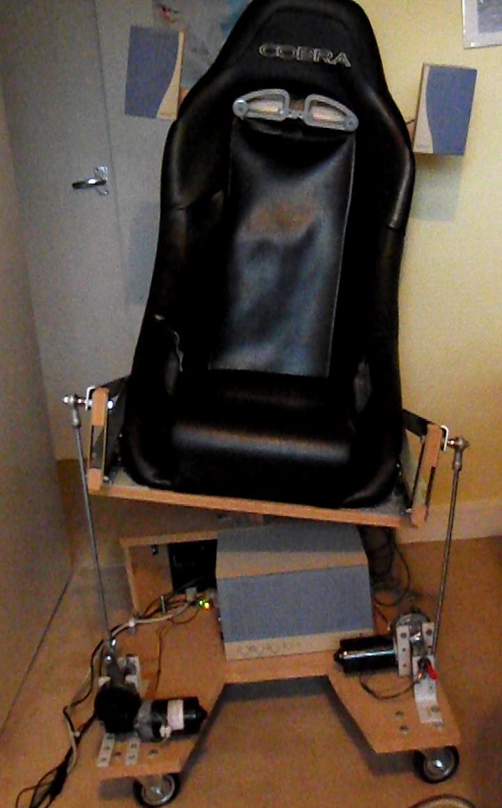

    I've added a couple pictures, as it is now.
    I can change the angle and length of leg extension for different people.

    Hi, I thought I would update this post.
    I wanted to make above 2DOF better,
    but didn't want to buy expensive motors from abroad,
    as I have been unable to find suitable motors in UK.
    So my solution is to use 4 wiper motors instead of 2, simple.
    I placed 1 wiper at each corner and a telescopic tube in middle to hold universal joint,
    This way if any motor goes out of sync or stops working (for any reason),
    then I wanted build some give in the system.
