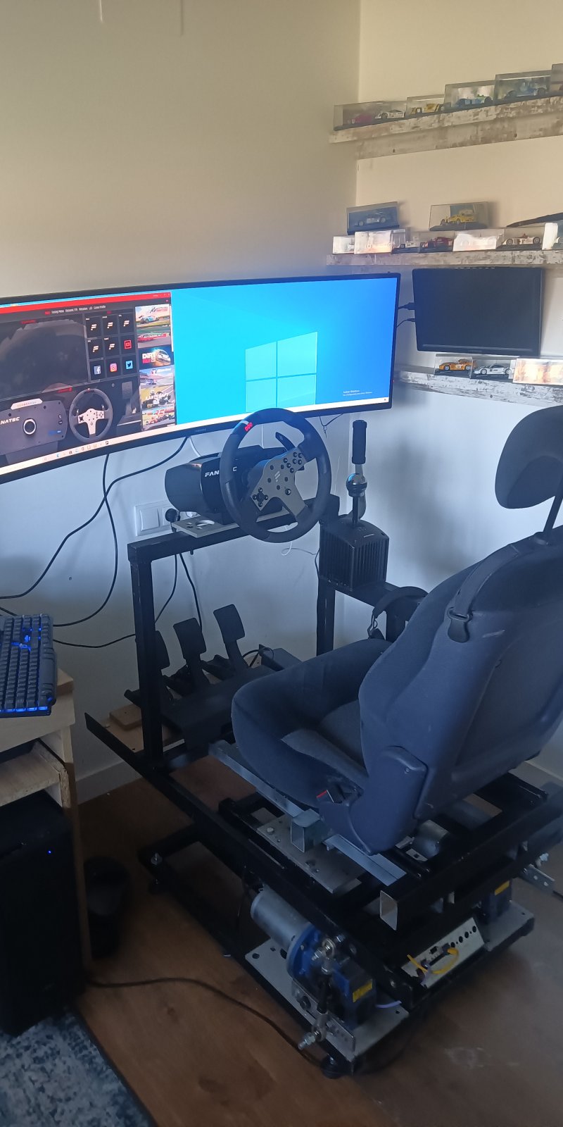

    Thanks for your support Boss. Tomorrow I try to refine the movements. But I am Happy for the moment with the result. What do you think about my 2dof??

    It looks to me as though the fundamentals of your rig are working fine, it just needs some tweaking of settings and perhaps balance, the latter may reduce the backlash a little.

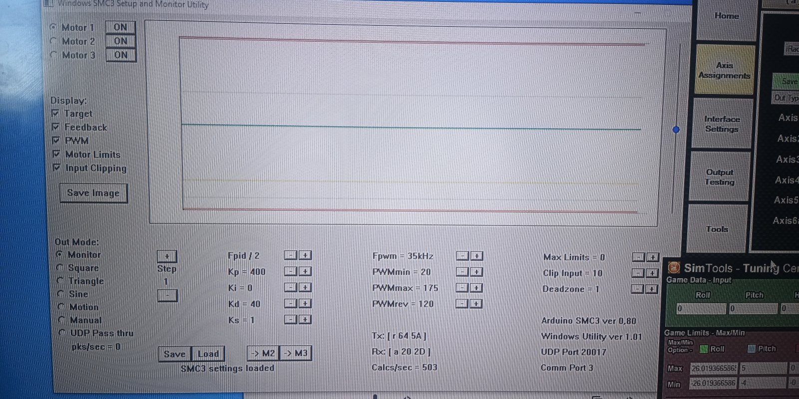

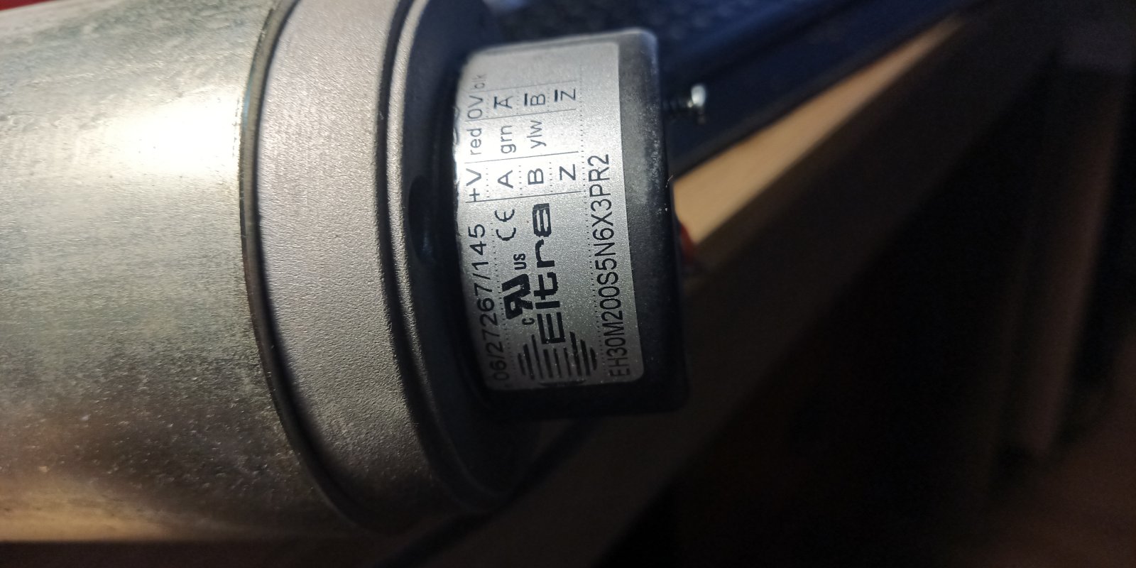

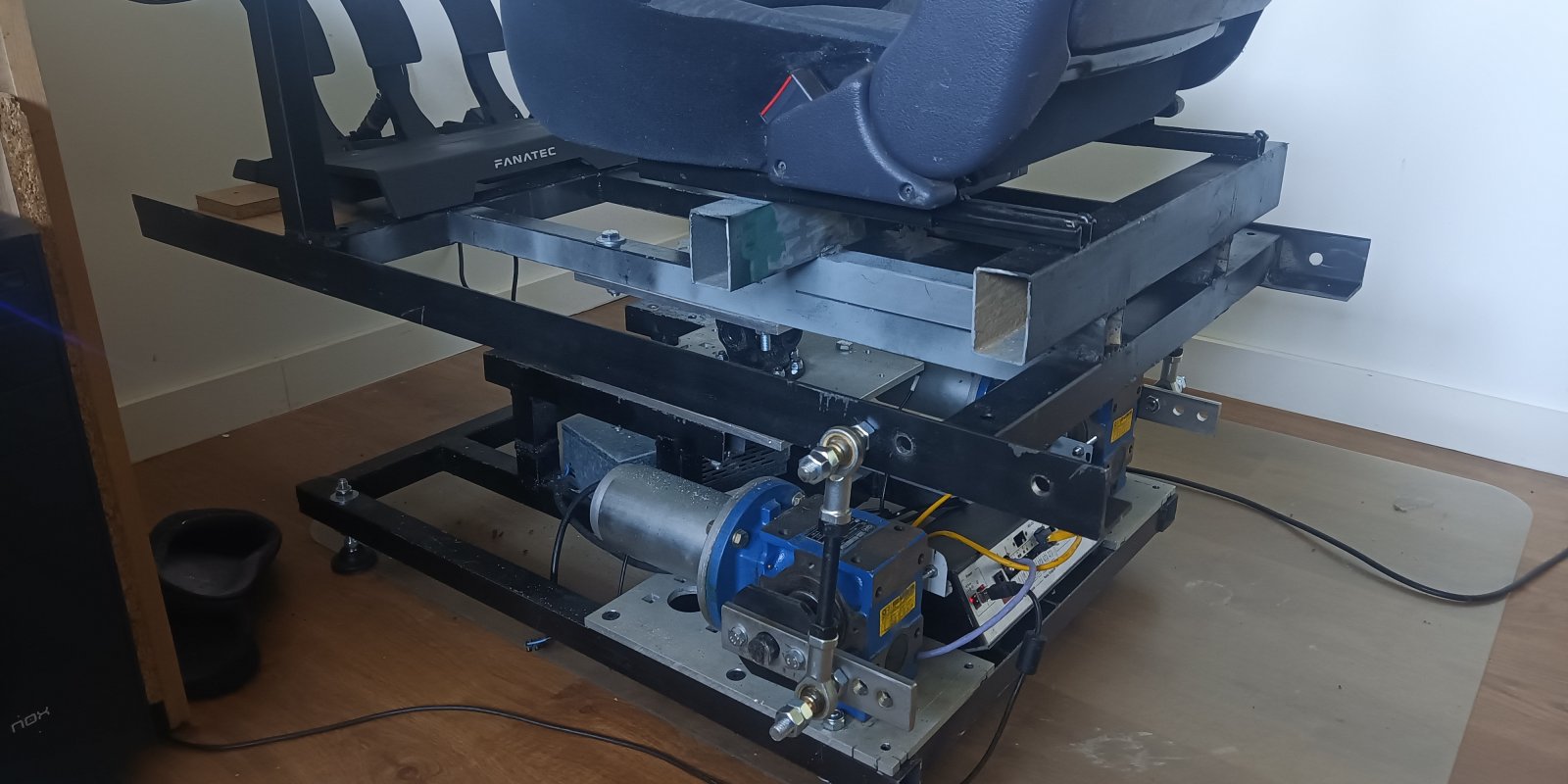

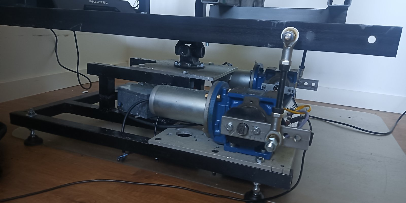

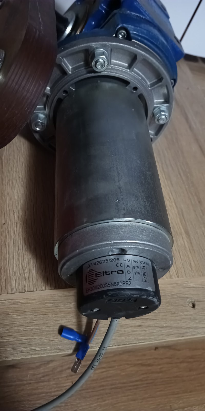

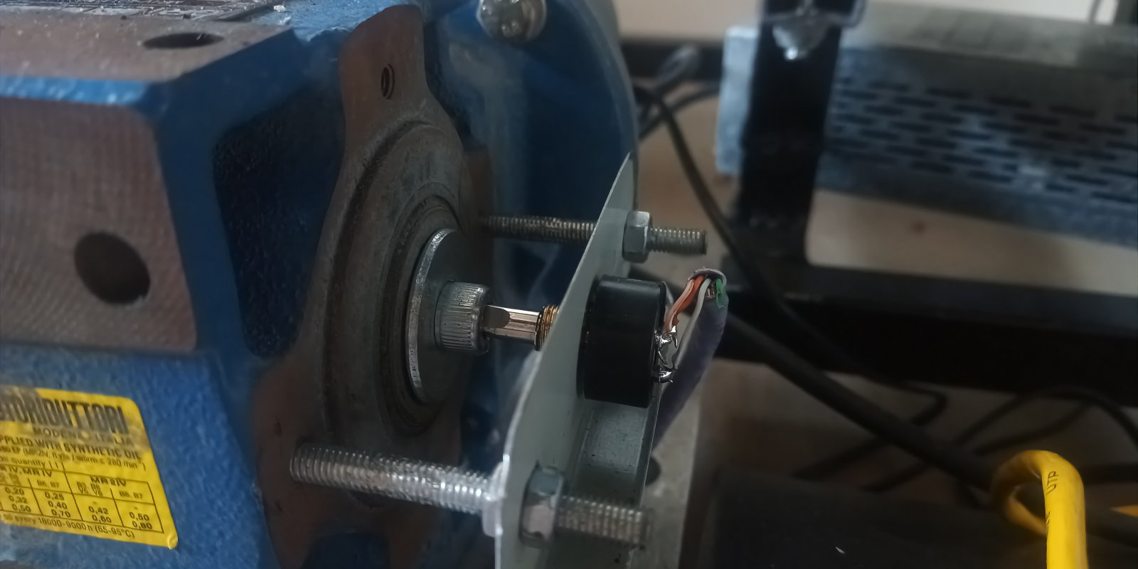

    Hi guys! I have Problems with the setup. Sometimess one motor is nervous. This weekend I show one video and my setup. I Moded the chasis. I think the problems ser for the potencciometers. What other options I have to know the positivo of my motors? What potencciometers are good to the sim? I have two encoders. Can I use the encoders with the Arduino and SCM3? Maybe @yobuddy or @noorbeast knows about the encoders. I share one picture. IMG_20210212_213928_973.jpg IMG_20210311_210122_189.jpg

  5. Manes

    Thanks for the fast reply boss. What potenciometers are a good option??

    Ok, i go to try with hall sensors. The connection with the arduino is the same with potenciometers?
    Is posible woks with hall sensors of 360 grades? in my local store only have of 360 grades....

    Yes the Arduino wiring is the same.
    360 will work, but as you are only using a fraction of that range at some resolution cost.

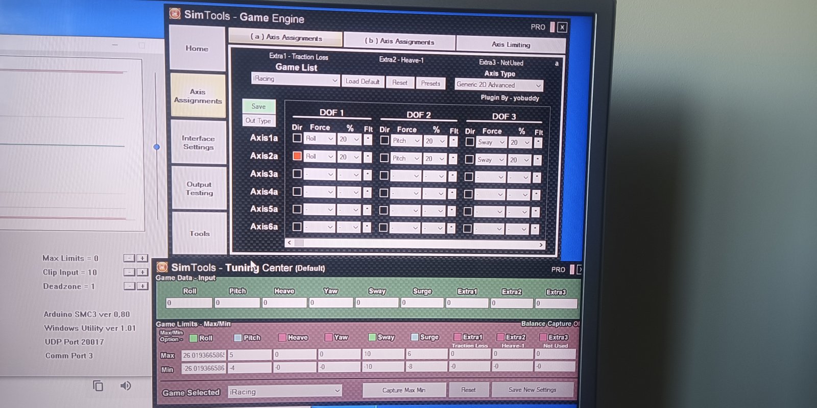

    Hi guys. Some months later, i am come back. In my holidays I Mode my sim getting more rigid and confortable chassis. With the monitor out if the sim I have less weitght and It os more easy. But I have problems. I configure tunning center, Game engine and SCM3 and sometimes the motor start to tremble and I need clóse Game manager and restart SCM3 to get the motor to be quiet. Sometimes also the motors start to turn crazy and need restart SCM3. I need help. I try to much posibilities and configurations in SCM3 and simtools but i dont Found a solution.

    I forget to said i have now in sim hall sensors.
