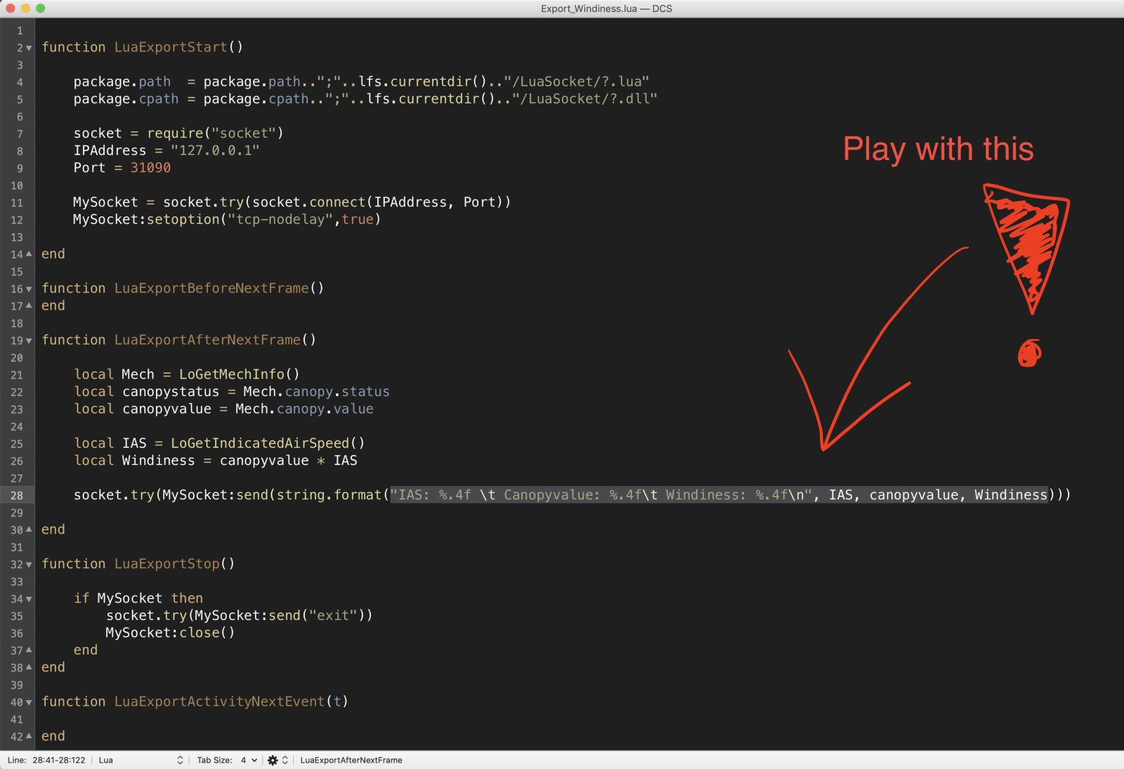

    I played around a little with the Simtools Plugin for DCS (actually, only with the Export.lua file that it creates) but after like an hour or so I was none the wiser. *scratching head*
    I can manipulate the string that is being sent to SimTools. While the raw string that goes through the wire is perfectly fine, the data showing up in Simtools is strange. If I send "0, 0, 0, 0, 0, 0" (all zeros), Simtools reads...
    "180" in yaw
    "1" in heave and
    "0" in all other slots.
    I mean, I have a faint suspicion of why that would be, but nonetheless it keeps me from actually using the 6 default slots (Roll Pitch Heave Yaw Sway Surge) to play around. I can also not use the extra slots, because if I send a 7th, 8th or 9th value, they just won't show up in the tuning center. No idea why.... :) If someone could explain this to me, I'd appreciate.

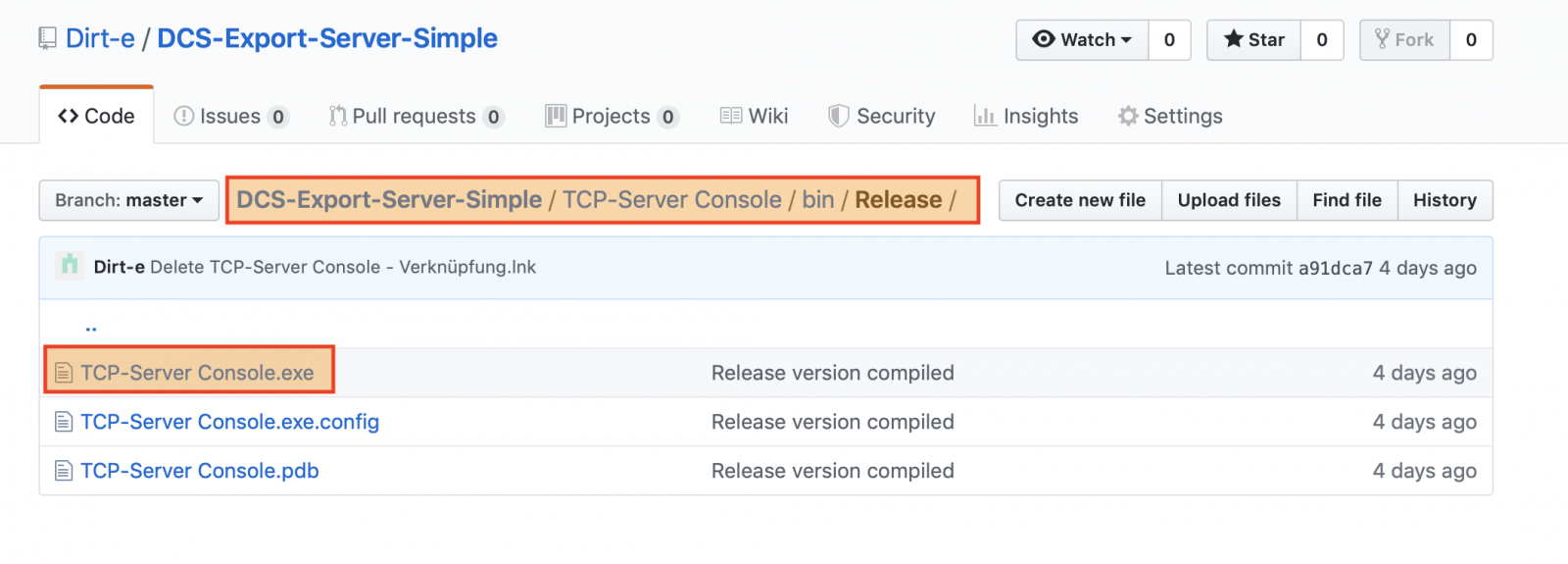

    But I was still curious about the idea of feeling the wind in the cockpit when the canopy opens :) So, if you want to follow along, here's a step by step tutorial on how to read a value out of DCS that vaguely represents the "windiness" in the cockpit:
    1. Download my Github repository. Go to TCP-Server Console/bin/release and run the TCP-Server Console.exe Bildschirmfoto 2019-05-26 um 21.58.40.png
    2. Rename the Export.txt file that I attached to this post into Export.lua and copy it into your [Username]/Saved Games/DCS/Scripts folder. If you already have an Export.lua file in that folder, MAKE A BACKUP OF YOUR EXSTING EXPORT.LUA!
    3. Create a mission with a little wind, or taxi an aircraft around at speeds of about 10-20Kts. Then open the canopy :)
    4. In the console you should see three values: Canopy value, Indicated Airspeed and Windiness (the product of the two).
    Feel free to play with the string that is being sent out. There are plenty of functions to call that will give you data to export. Bildschirmfoto 2019-05-26 um 22.14.43.png
    If you run into problems, ask me any time. Everyone can get this to work. I think it's a great way to take a peek behind the curtain of the DCS Plugin too. It exports data in a very similar way.
    Maybe this can be a starting point for someone to make it work in Simtools, or maybe send it to an Arduino directly. Would sure be fun...
    Dirty :)

    This is because the plugin is manipulating the the data sent to SimTools.
    For instance I'm guessing the plugin is adding 1 to heave for output to offset gravity.
    (The Game probably always spits out a -1?)
    Yaw from the game may be 0 to -360, so we add 180 to get a range output of -180 to 180.
    These are turned off in the original plugin.
    They would just need to be named in the plugin to turn them on.
    Take care!
