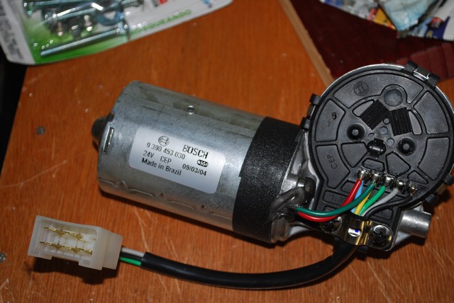

    hey man..

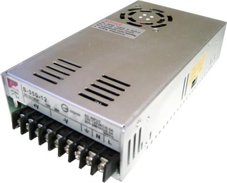

    I have purchased the motor below (Bosch 24V 9A), and the power supply (Switched Power Supply Stabilized 201W 24V 8A)...not sure if it will work..but I will try..
    the power suply will be here this weekend and I will send some pictures of my first test..I hope I dont burn things :)
