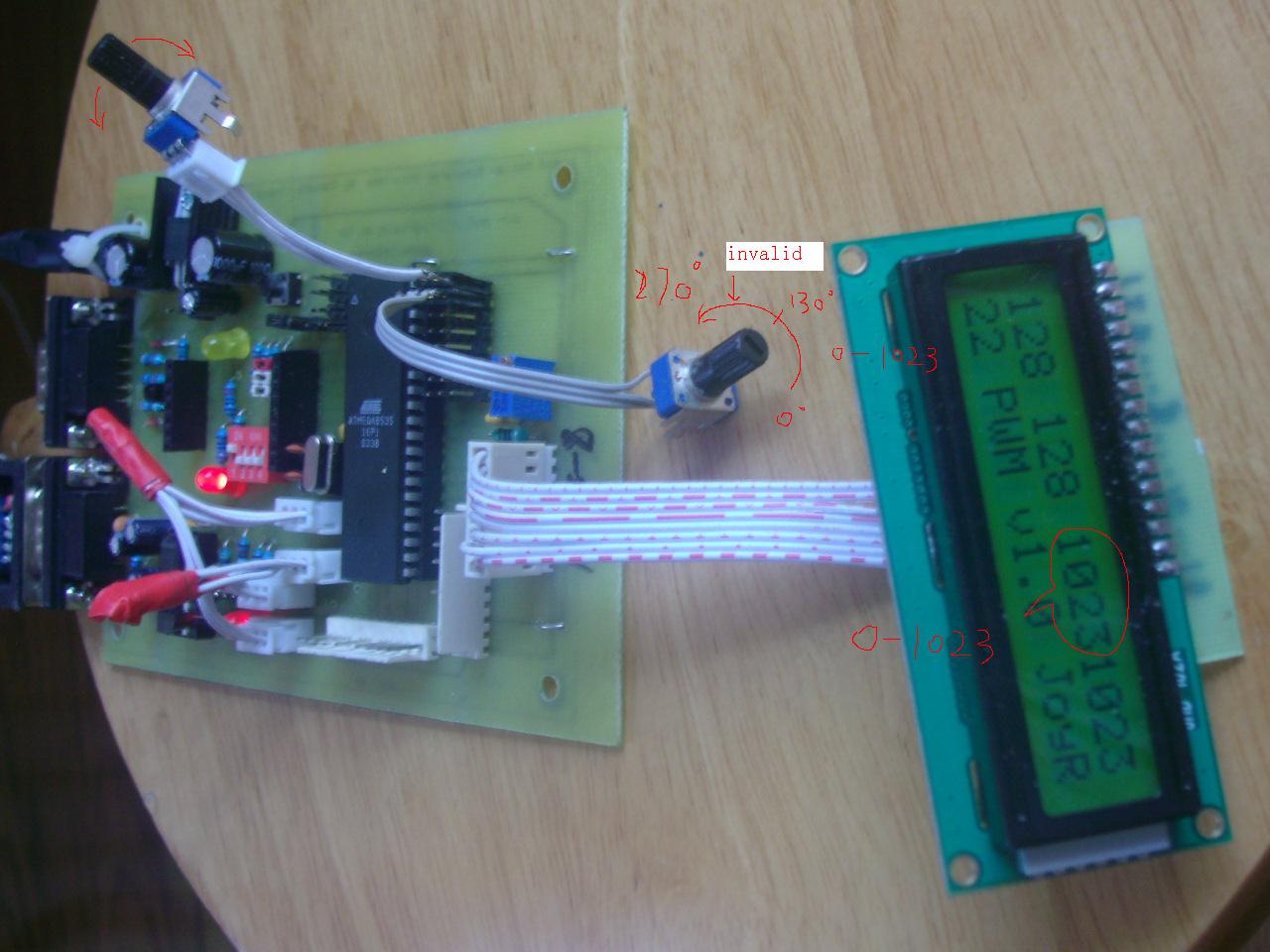

    New issues 2DOF PWM AMC v1.5 board
    Thank you friends in the technical aspects of forum support and contributions, I really like your doing.
    Last week I made a 2DOF PWM AMC v1.5 board as shown in Figure:
    Have questions, please guide
    1. Potentiometer travel about 0-130 ° degrees 270 degrees display data led 0-1023
    130-270 degrees is invalid. Is that correct?
    2. Potentiometers used in the device full (270 °) or 0-130 °?
    Requested an expert to answer Thank you!

  2. Asus-G51JX-3D

  3. 741852cp
    741852cp Member
    Nov 21, 2010
    62
    china
    106Coins
    +9 / 0 / -0
    2DOF, AC motor
    Thank you very much, fast answer! ! You let me solve the problem, to understand everything

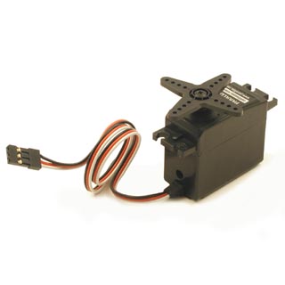

    In your answer, I see two interfaces (figure), what is its role?
    2DOF PWM AMC v1.5 board,,, the firmware (program) with less than 2 ports.
    My English is not good, Google to help me, I hope you understand my words.
  6. Asus-G51JX-3D
    Asus-G51JX-3D Member
    Oct 25, 2010
    44
    - 69Coins
    2DOF, 4DOF
    Servo ports :)

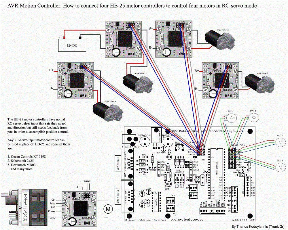

  8. Asus-G51JX-3D
    Oct 25, 2010
    44
    - 69Coins
    2DOF, 4DOF
    Ja oder Servo Controller HB25 :D
