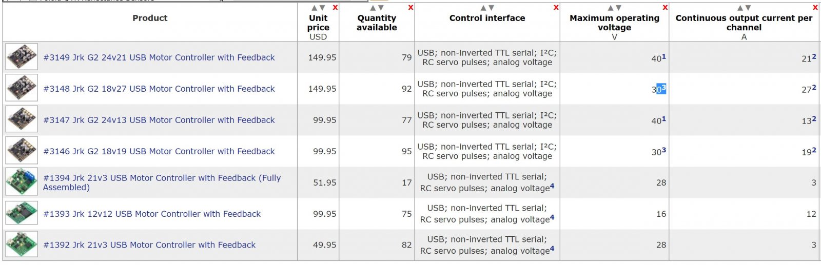

    24v 27 amps is still a bit weak in comparison to what dimension engineering is offering. but its almost double the original. this should be a nice upgrade should someone decide to go this route. good find, especially with the 40% off.

    Is there a guide as to which G2 to buy ?
    My interest would be for a small wiper motor and separately for a rear traction loss actuator.

    IMHO you will get better bang for your buck with a sabertooth 2x32.

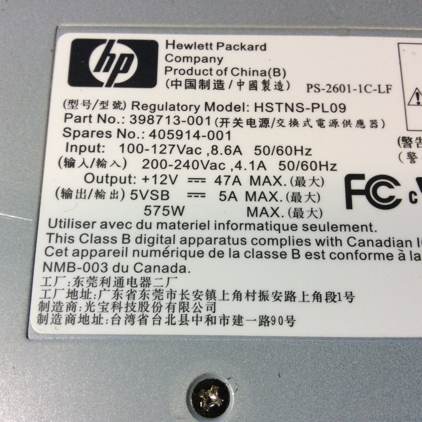

    My power supply output is 12V at 47 Amp Maximum with 575 Watts Maximum

    do your motors support24volt?

    Yes! they actually can operate from 12v to 24v but I do not have 24v power supply

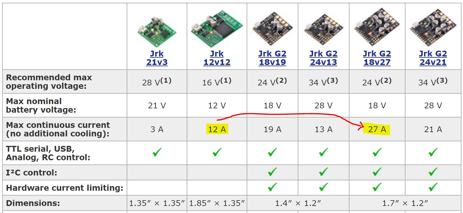

    i am thinking to go with the 18v27 because of the Higher Amps... is that a good decision?
  12. Nick Moxley
    17,057Coins
    +2,506 / 30 / -2
    Yes Morton you want the 18v27
    and here's some info for the guys curious on the differences between the old and new, https://www.pololu.com/docs/0J73/1.2
    Ive got a pair coming for myself after a long discussion with support and sales, We'll see what there all about.

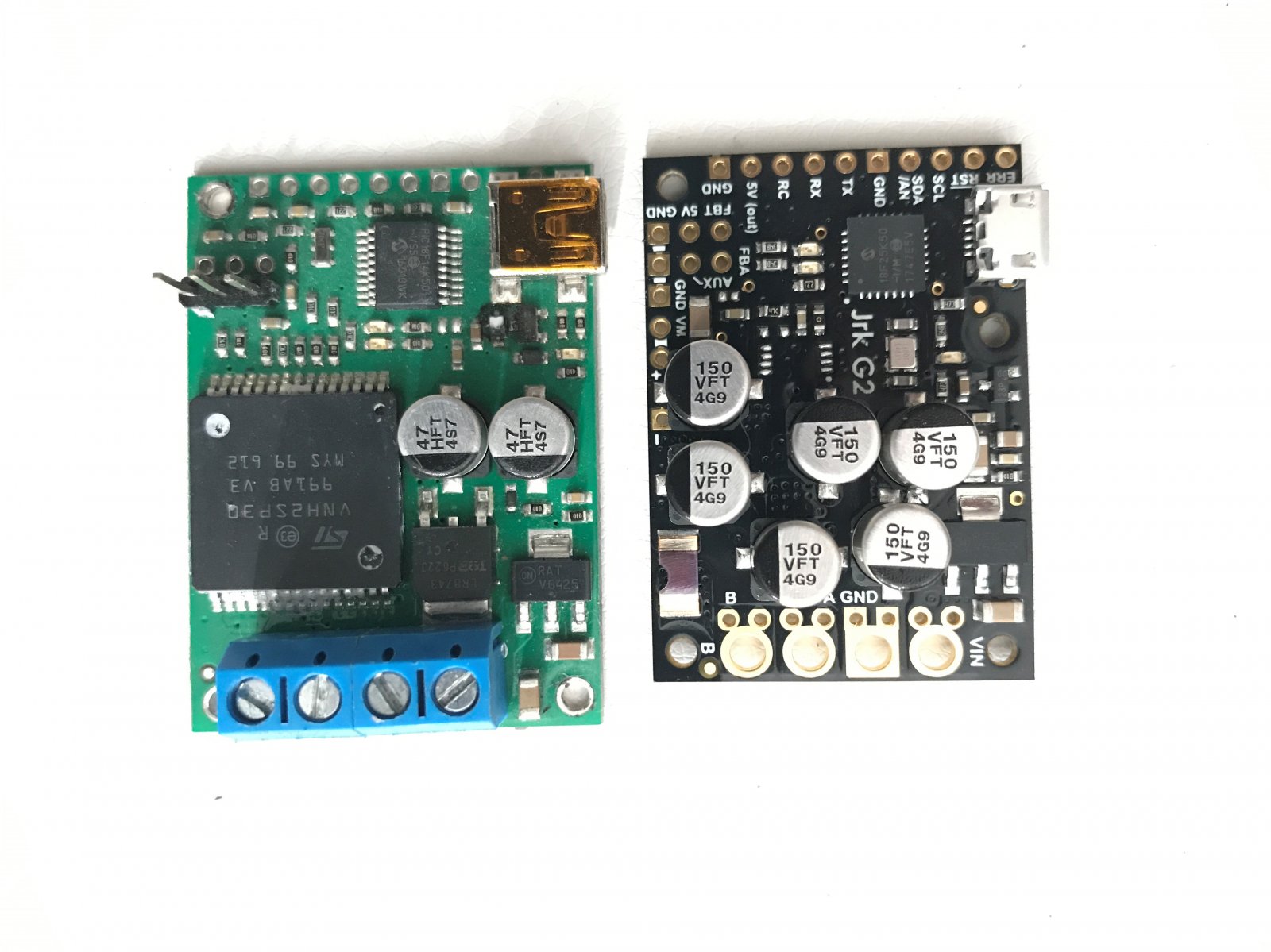

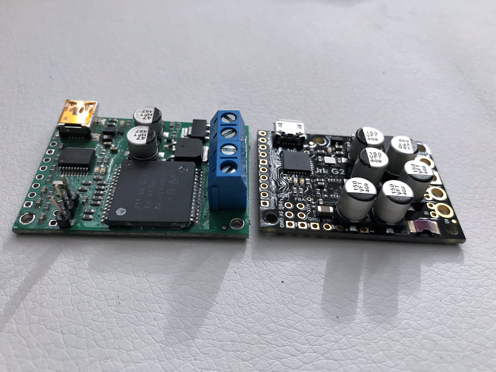

    I got mine already here are some pictures next to the JRK 12v12 and the new JRK 18v27

    3,797Coins
    +1,382 / 4 / -0
    Hi Guys,
    Can anyone confirm if these 18v27's still run at 12V but cope with the higher Amperage??
    The specs only state a MAX which makes me think 12V would work fine..?

    From Pololu site: This version offers a wide 6.5 V to 30 V operating range and can deliver continuous output currents up to 27 A without a heat sink.
  16. Nick Moxley
    17,057Coins
    +2,506 / 30 / -2
    AND if we do need to cool them , you cool from the bottom side mosfets. ;)
