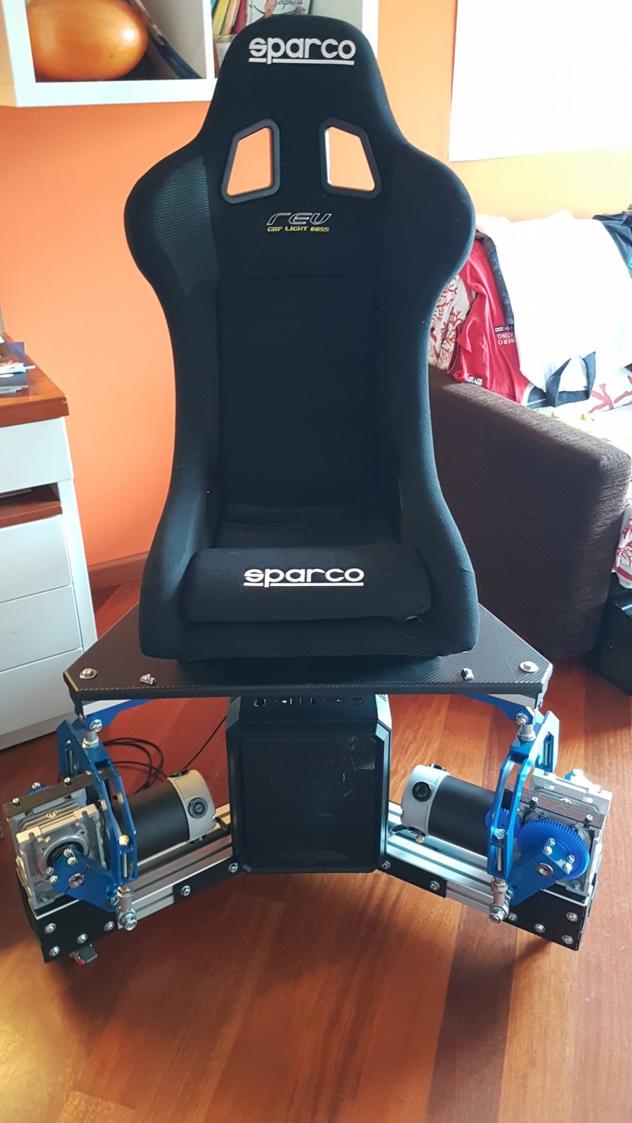

    work in progress….
    Prototype
    Definitive

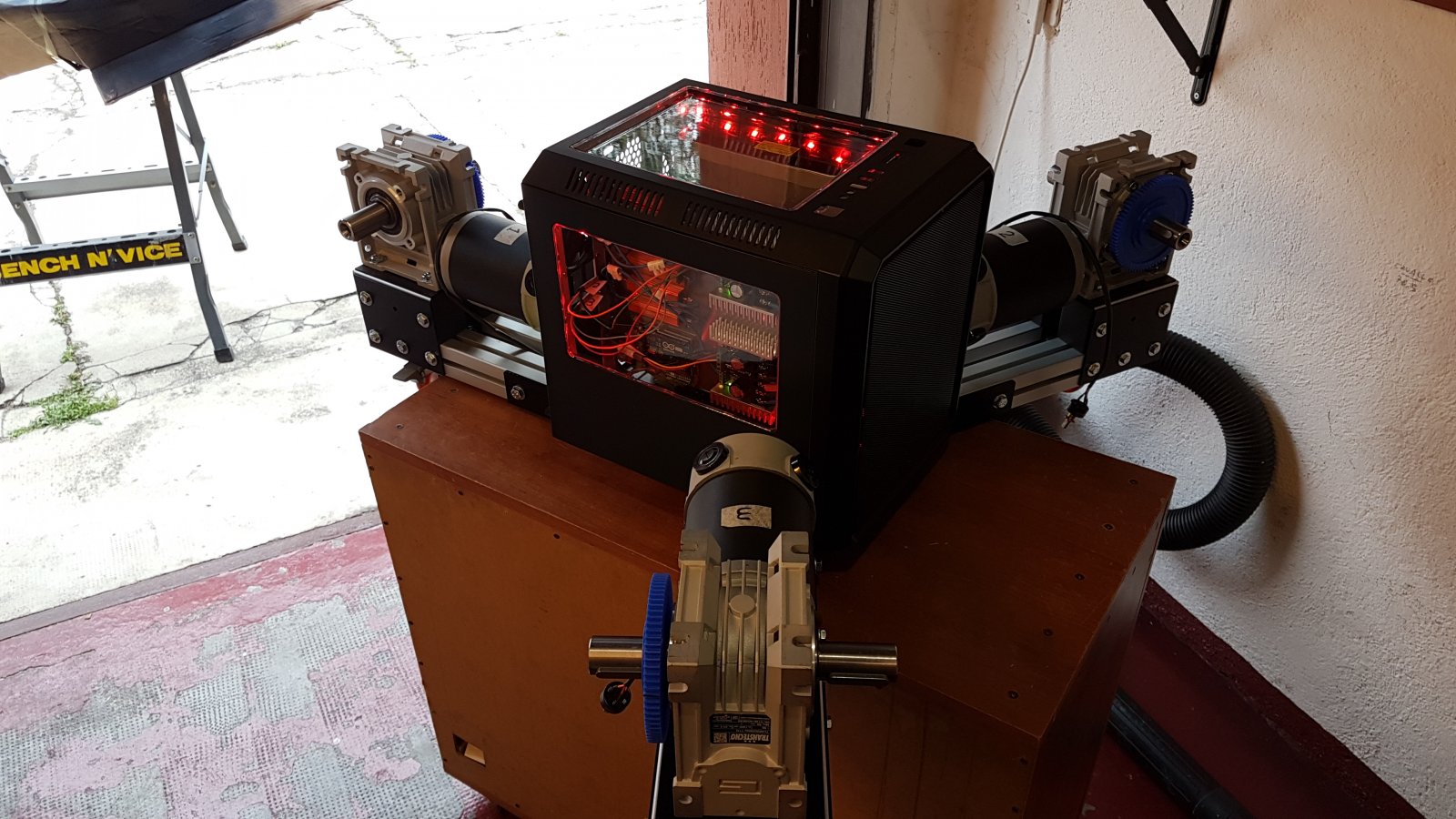

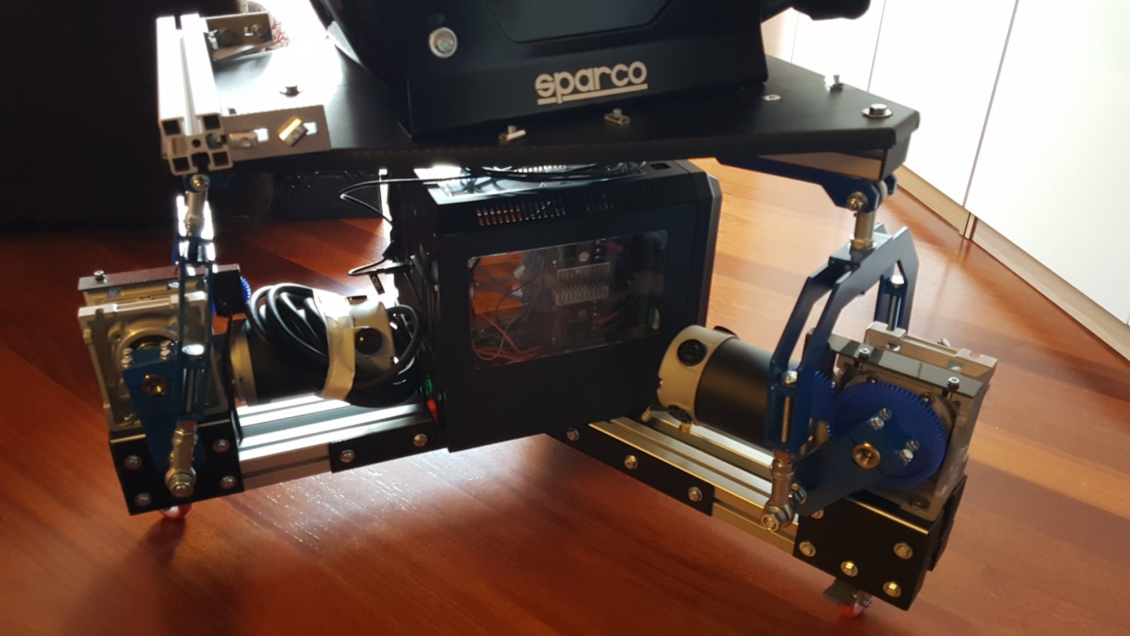

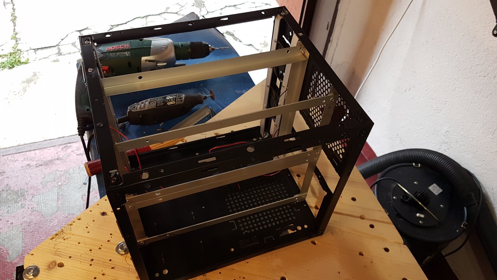

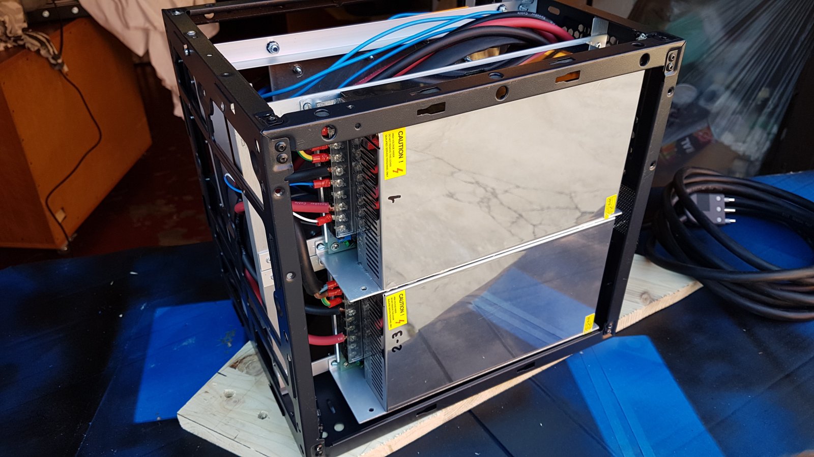

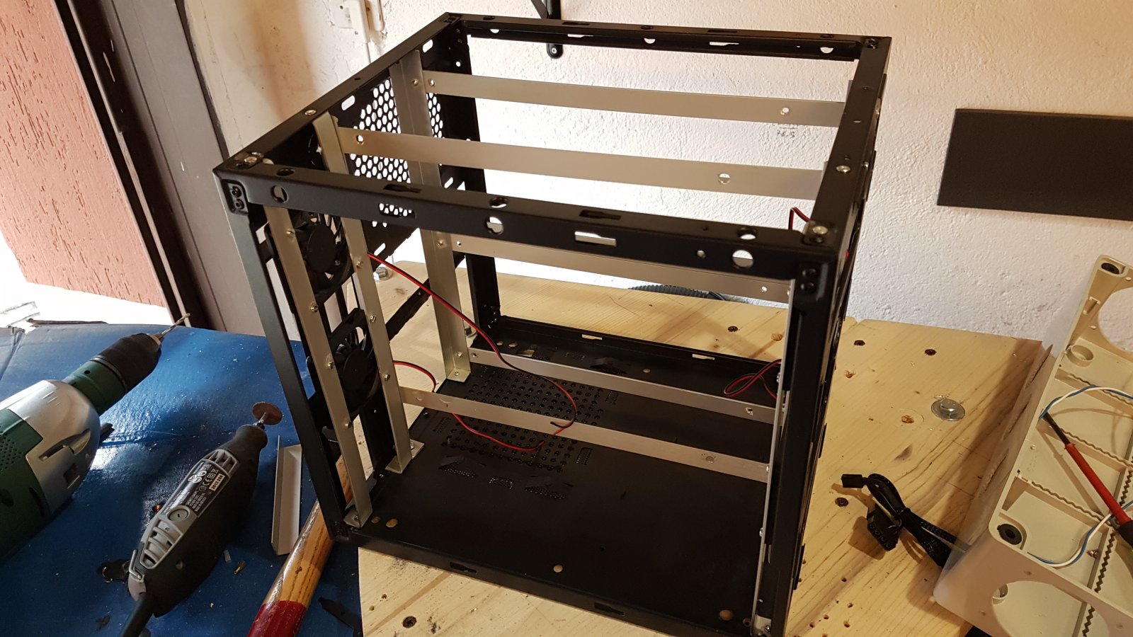

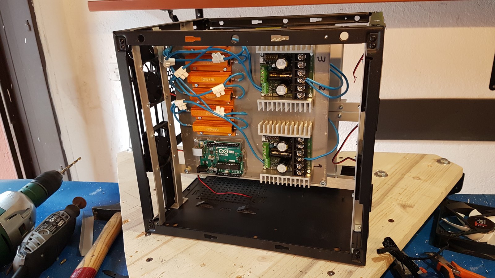

    I bought a cube case for PC .....Itek QBO 8
    I modified it and I inserted all the electronics, which will be positioned in the center of the motors.
    20190520_182138.jpg 20190520_182218.jpg 20190520_184112.jpg 20190522_101143.jpg

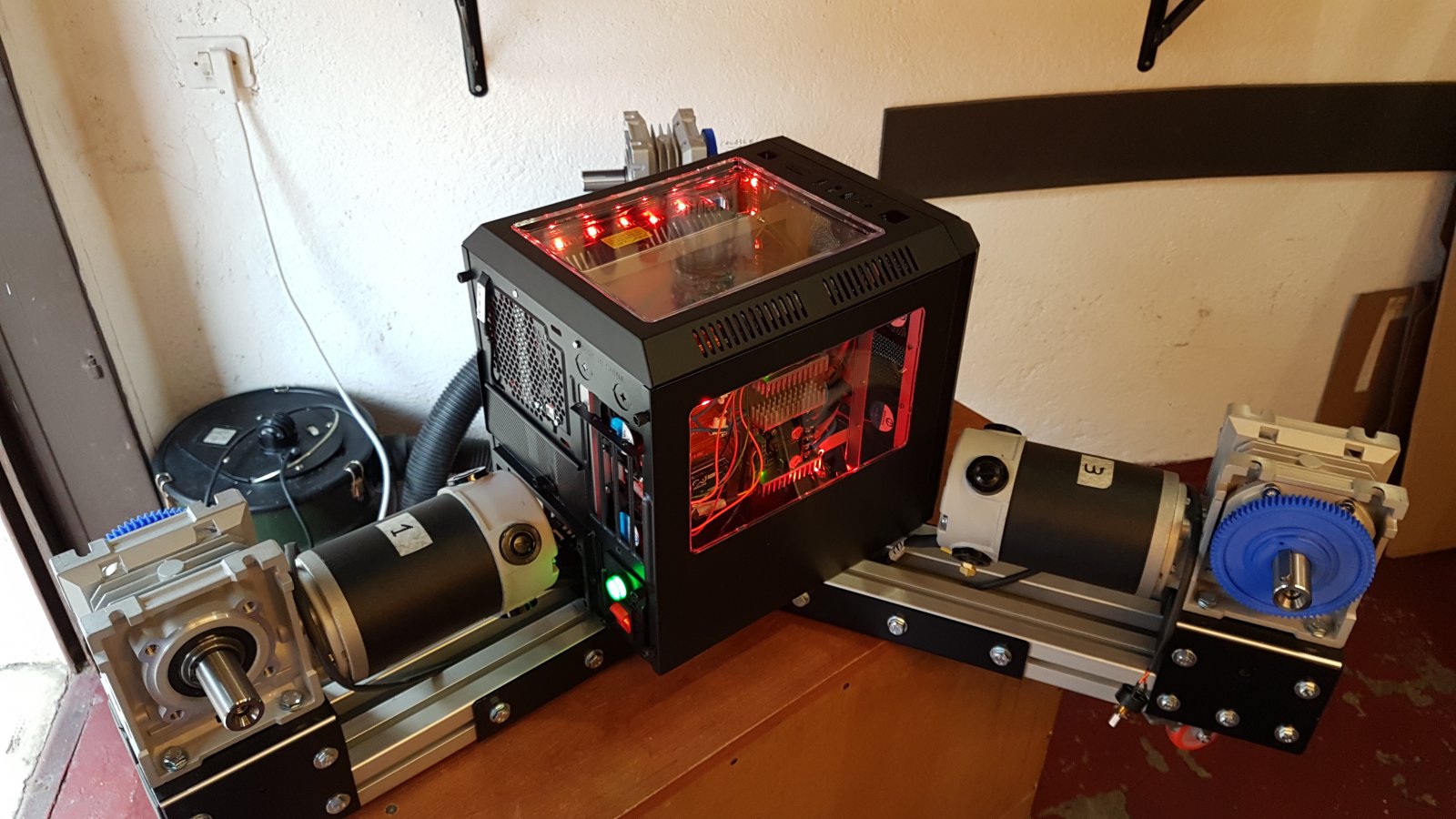

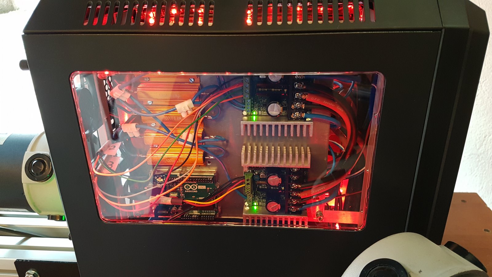

    More photos with the case assembled and mounted in its place.

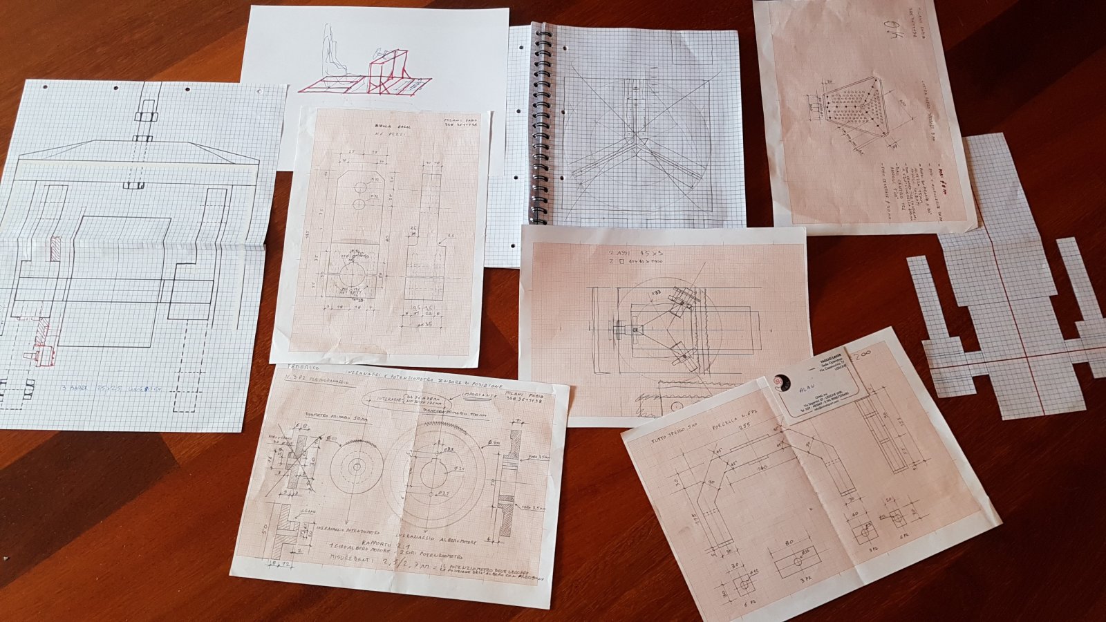

    I don't use software for design or mechanical design, only manual.
    This is my CAD / scketchup ...…….:blush:blush:blush :arrow:think:!:!:!:D

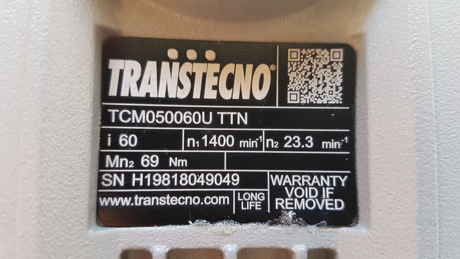

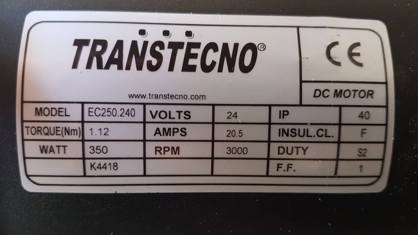

    H
    Hello Fabio,
    It's a beautiful work your playseat.
    I'd like to know how did you buy the Transtecno motor, because I didn't succeed. I don't have "Partita I.V.A. "
    Best Regards
    FrancescoRoberto
  8. Milani Fabio
    Milani Fabio Active Member
    Feb 21, 2019
    105
    Italia
    718Coins
    +74 / 2 / -0
    Ciao Roberto, Transtecno does not sell to private individuals, you must support a friend with a partita IVA.
    I did so.
    The Transtecno engines are a bit expensive compared to the Chinese ones, everyone told me this.
    Call Transtecno and ask for Cinzia Solitro, I have dealt with her.
    Hello

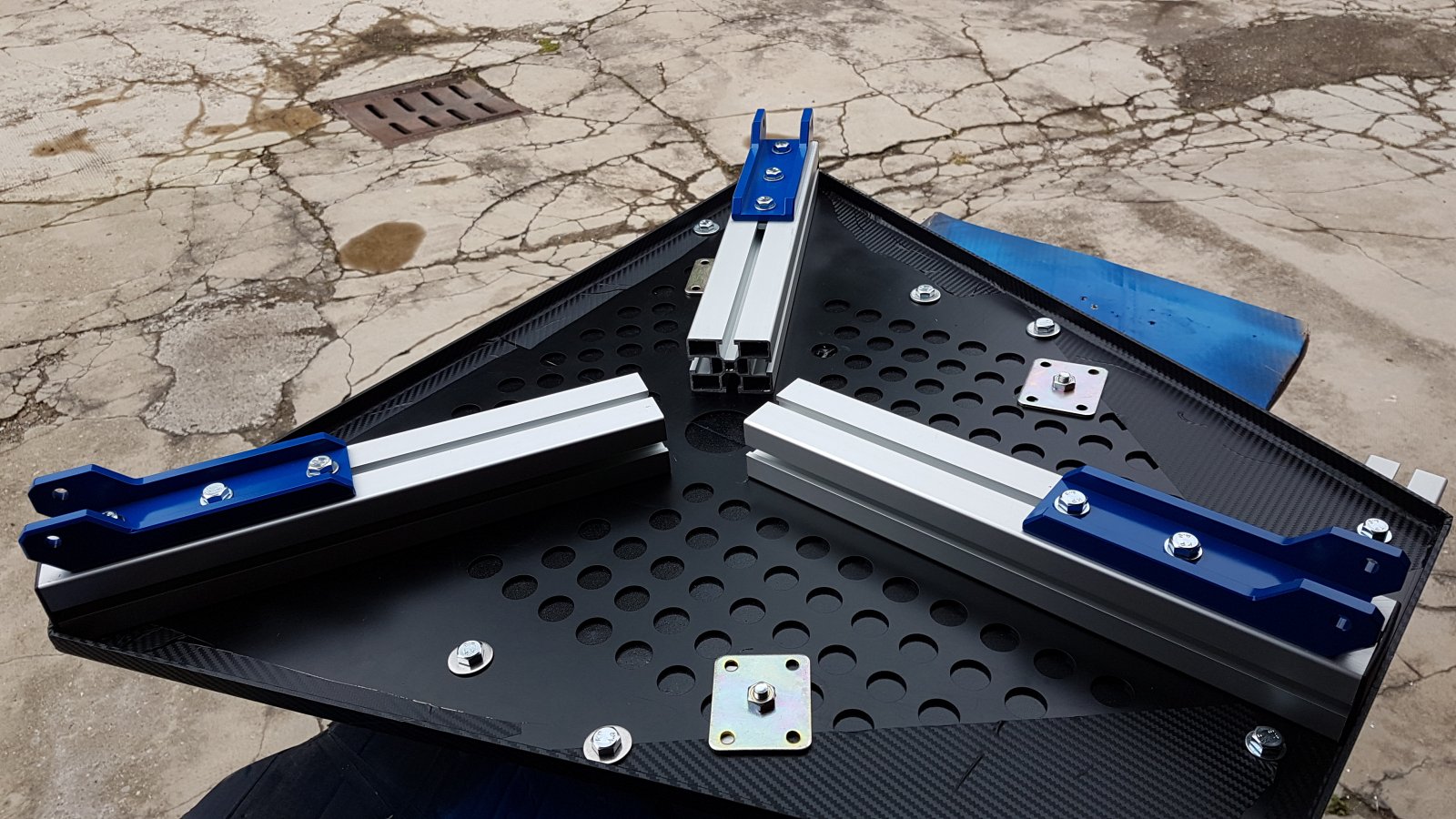

    Cause transfer of the workshop location ....... grrrrrrrrrrrr :mad::mad::mad::mad:...... after 50 days the pieces I had ordered arrived.

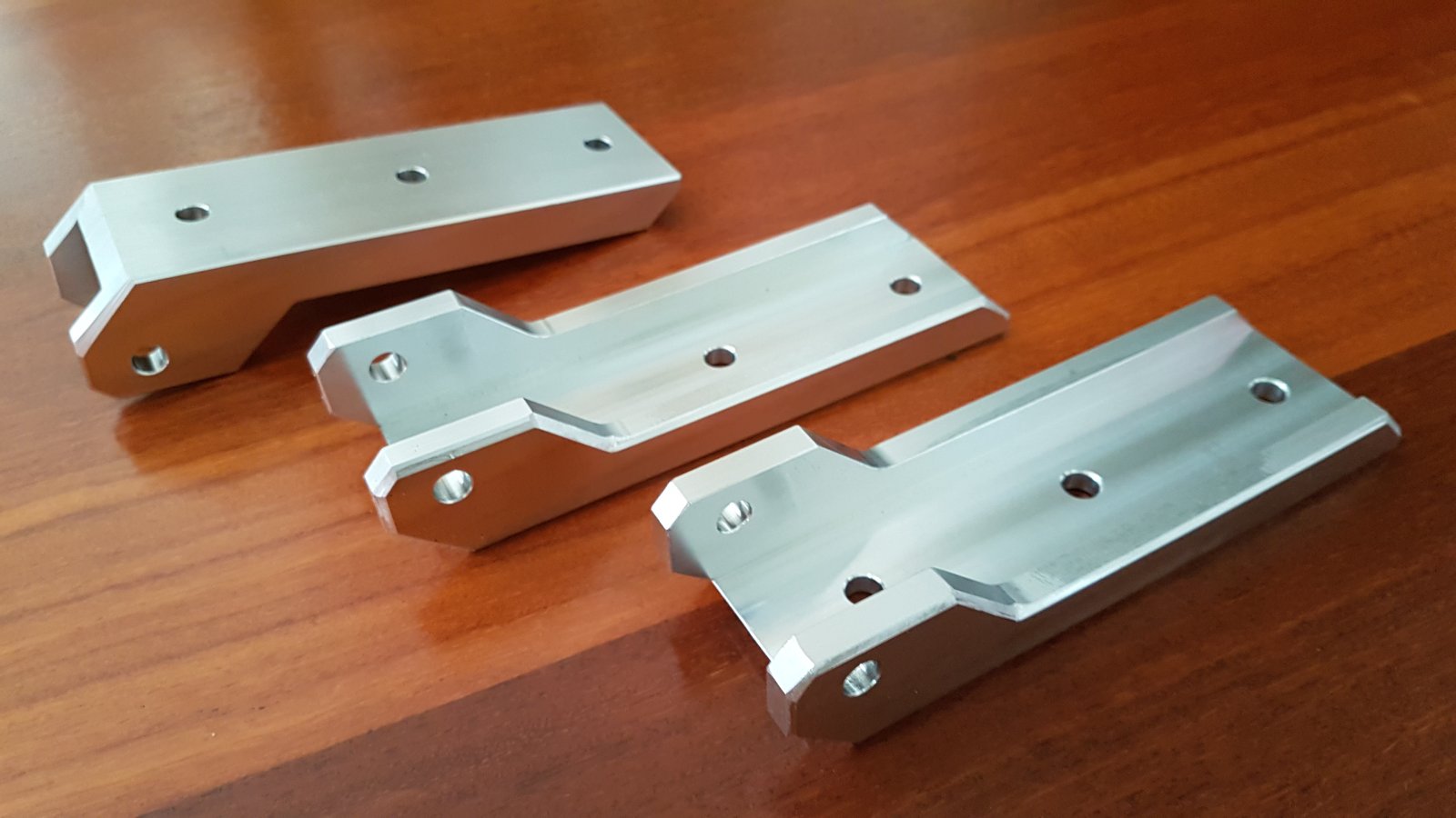

    These are the supposed anchors of the upper base.
    In the coming days I paint them and put them together.
    Then I will do a movement test like the one in the previous post with the prototype wood.
    Hello

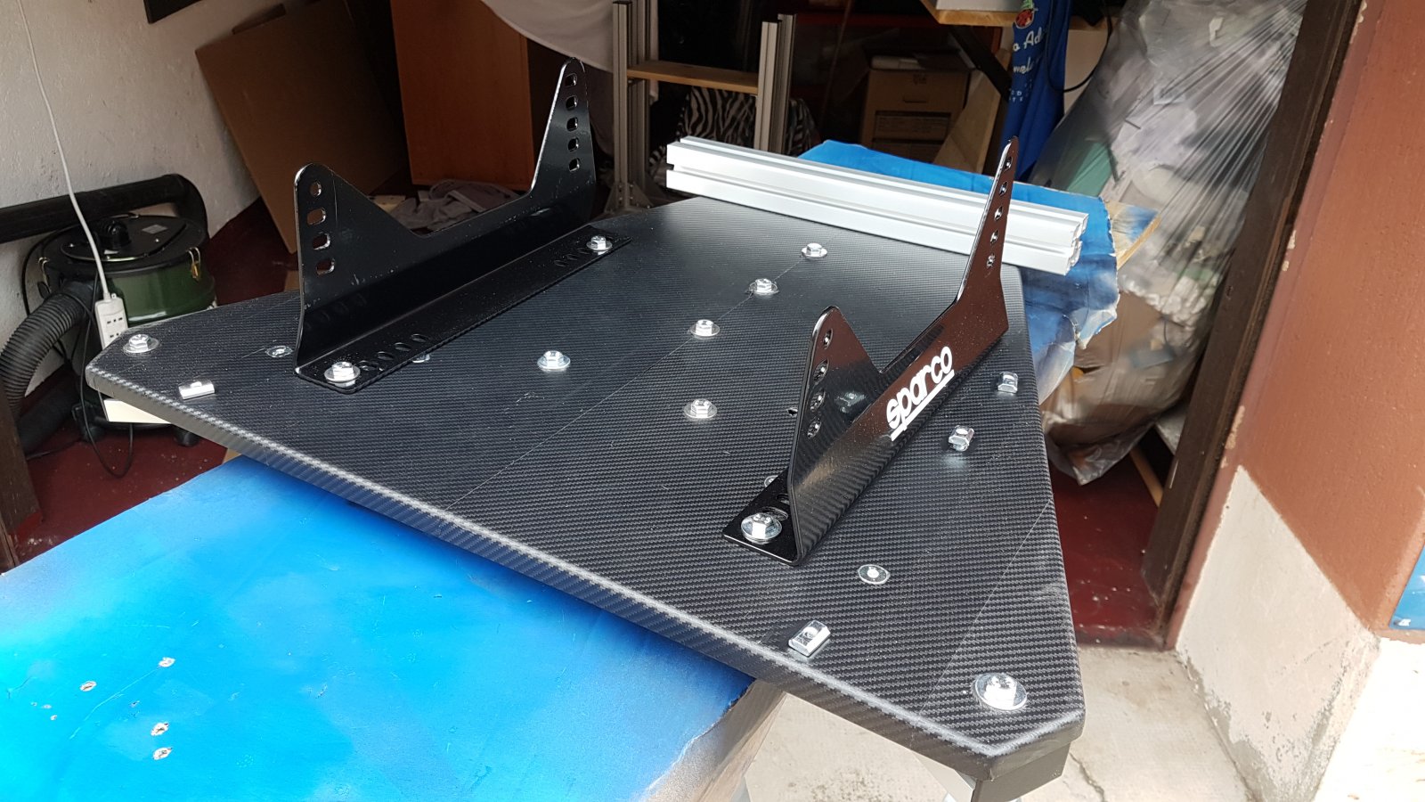

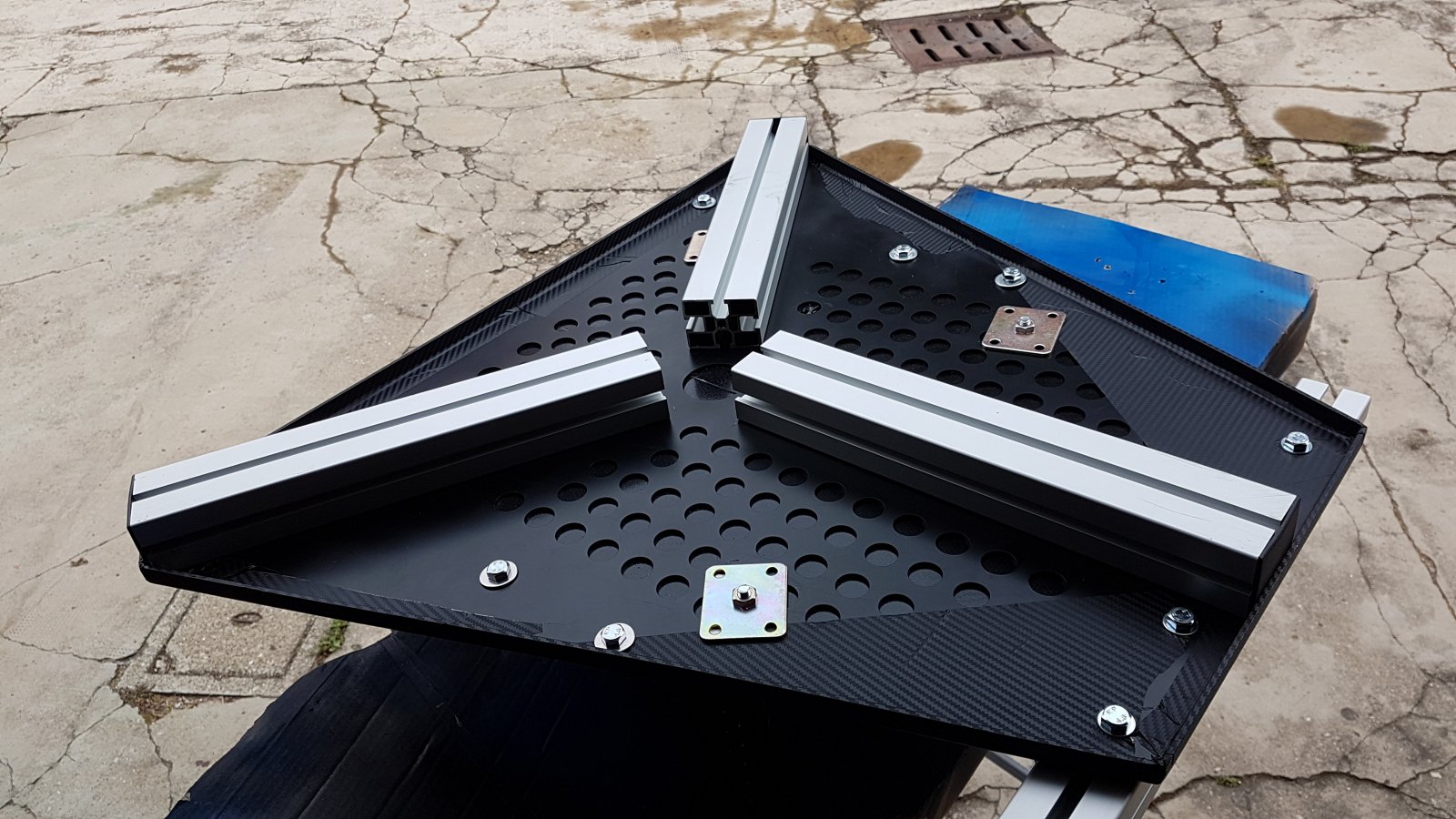

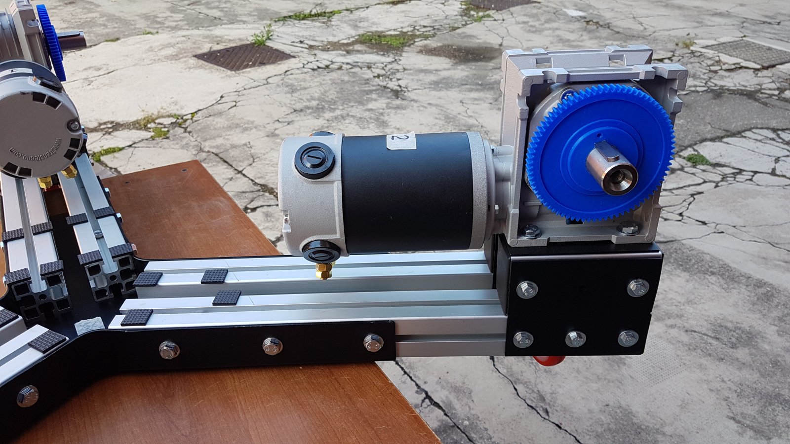

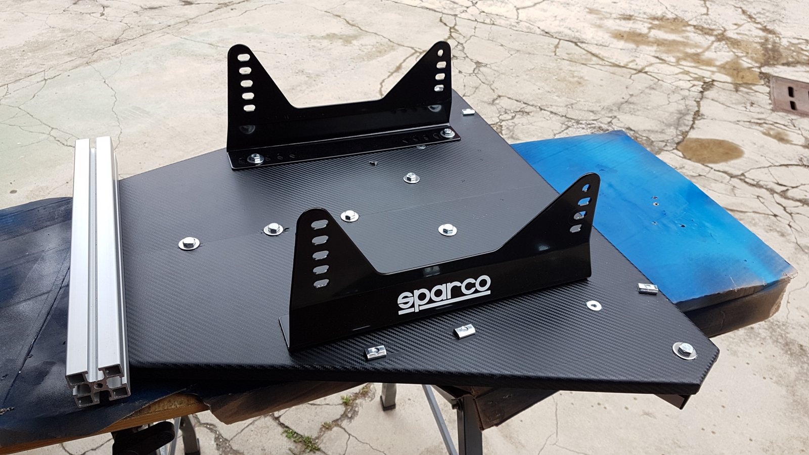

    Here is the top laser cut base.
    Despite many holes to lighten it the weight is 12 kg ..... I thought less …
    20190610_150836.jpg 20190610_150855.jpg 20190610_150921.jpg 20190610_151727.jpg

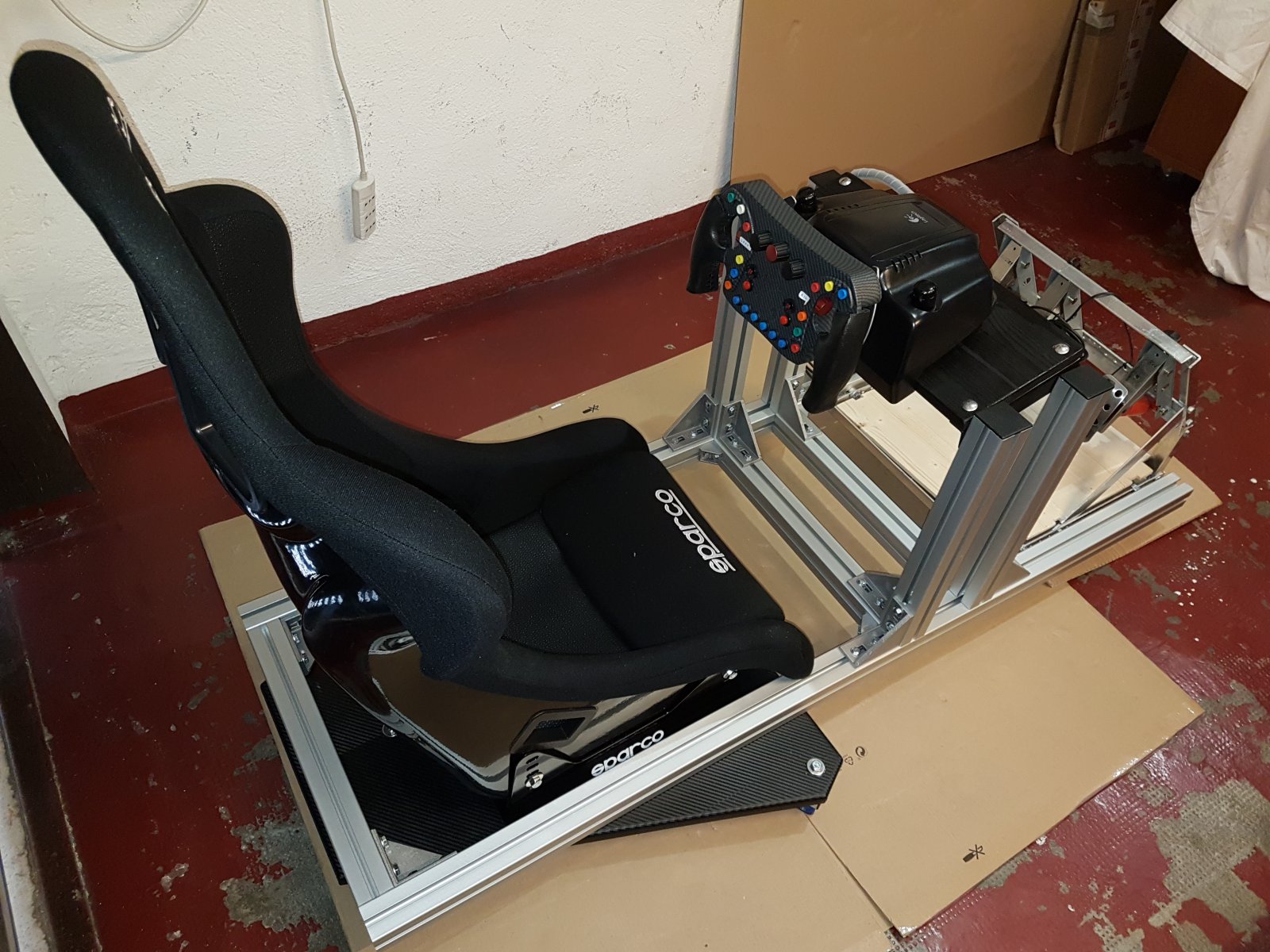

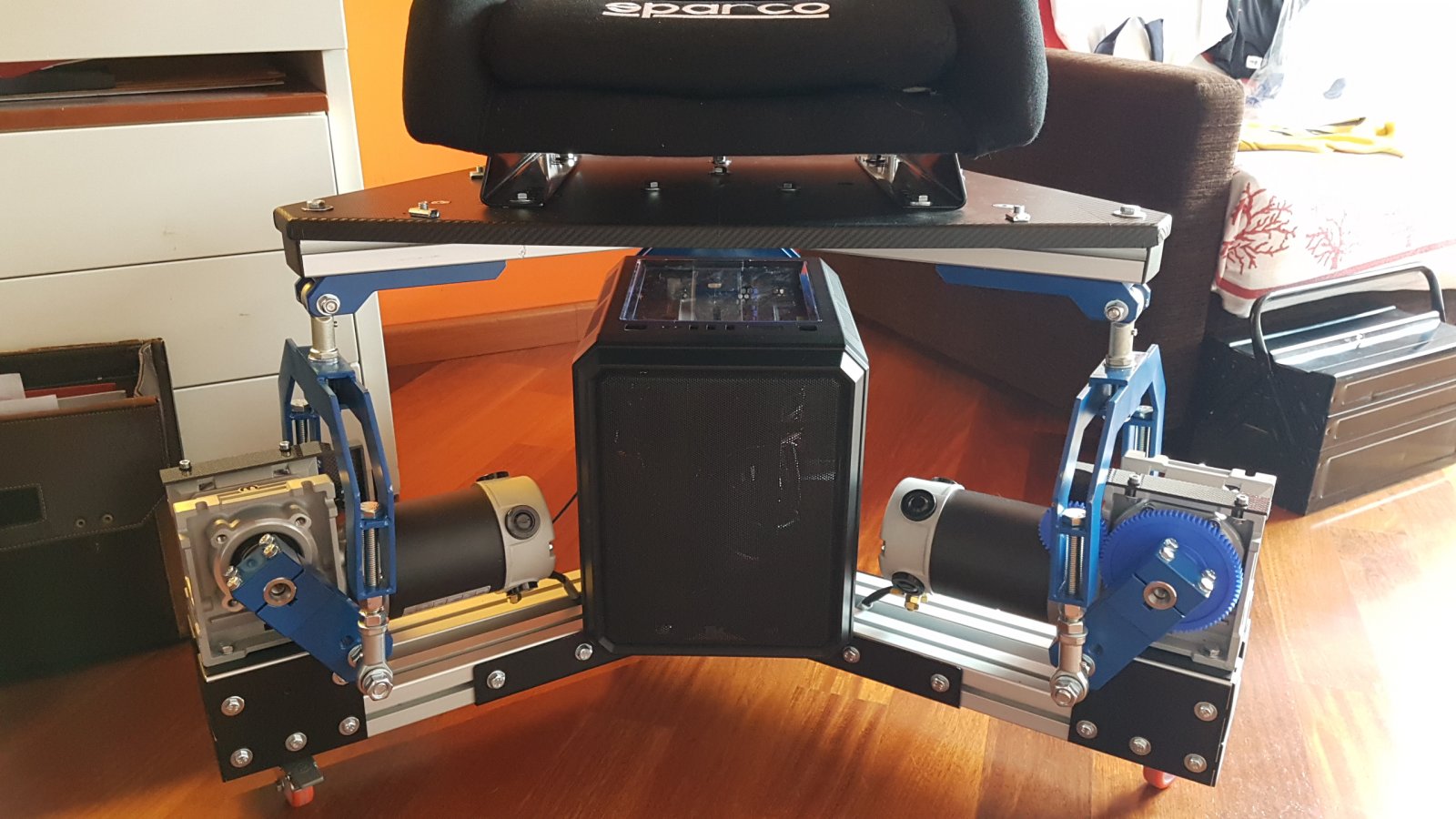

    The structure with seat, steering wheel support and pedals is also finished

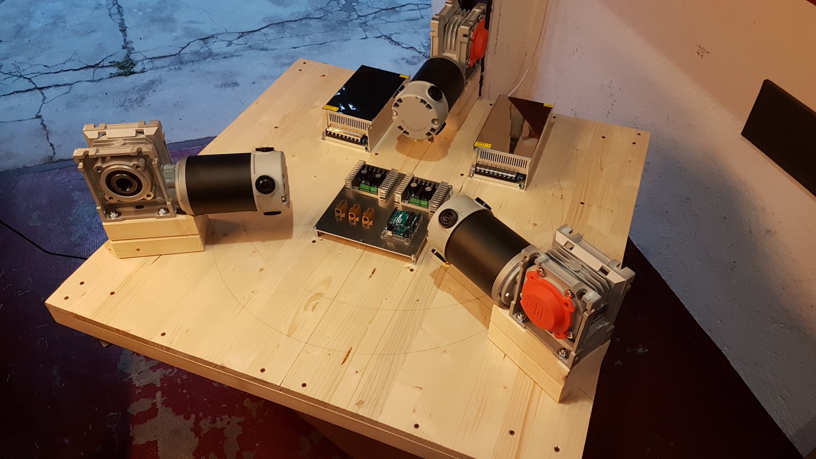

    Last test for the mechanical part to verify that when the base is in the lower part, it does not touch the electronics case

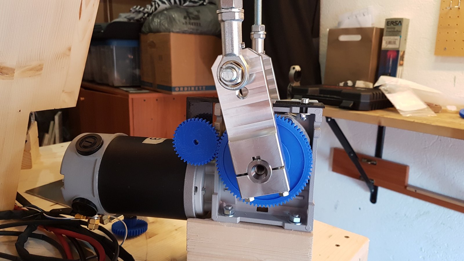

    When you say "lever" do you mean potentiometers?
    I have not yet mounted the potentiometers, it was just a mechanical movement test to see the dimensions.
    The potentiometers will be mounted like this:

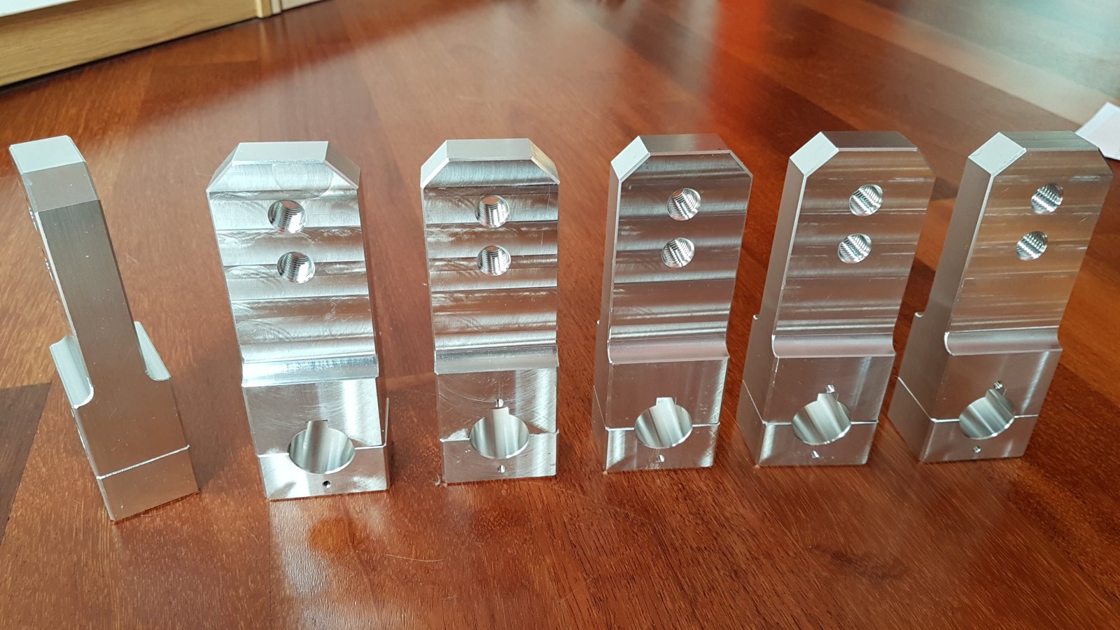

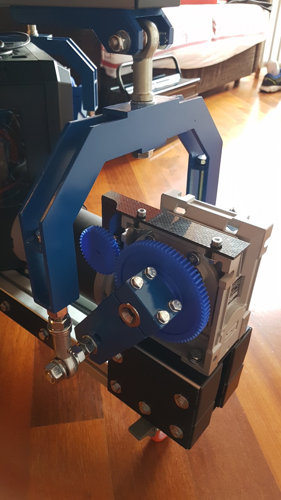

    The crank cannot be bought.
    The dimensions are my project, built with a cnc machine in ergal material.

    I brought everything home and assembled the upper base and the seat.
    Now is the moment of truth ..... Sim Tools .... Arduino .... Sabertooth.
    I have to start studying to understand all the software ....
    We hope everything goes well.
    20190619_121645.jpg 20190619_121658.jpg 20190619_121728.jpg 20190619_122148.jpg
    The aluminum frame for the steering wheel and pedals is also ready, which I will install after the softwere tests …

    i wish my reference sheets look that good...my design is scratch written on paper with pen..
