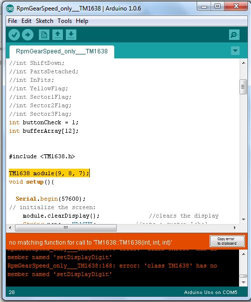

    Hi Guys, just a quick one, When trying to use the "RpmGearSpeed_only___TM1638.ino" file for my arduino, im getting this error.

    Seems I have got the code ok now, But now, when i go to the GameDash Settings, I get a message ""The interface connected to COM5 is not detected!"

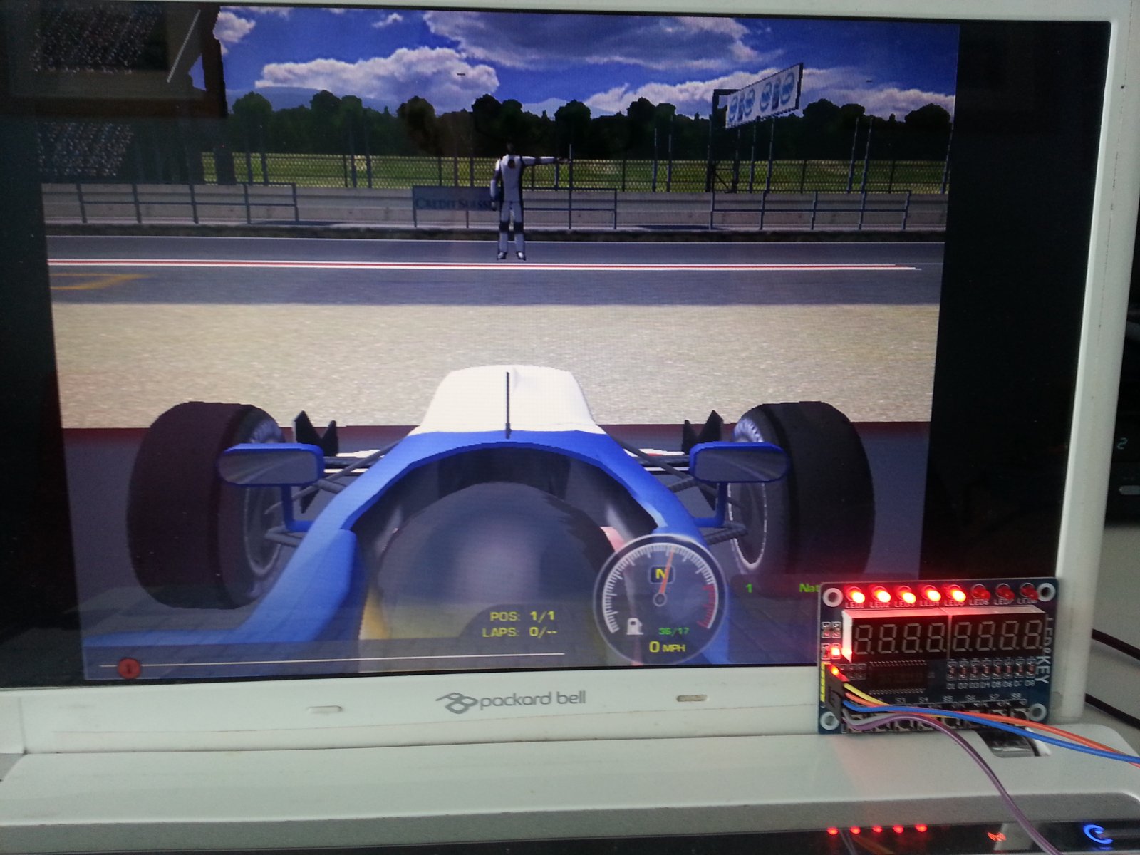

    Ok, I currently have the LED Rev counter working, but the number display doesnt show a single number. But at least im making progress.

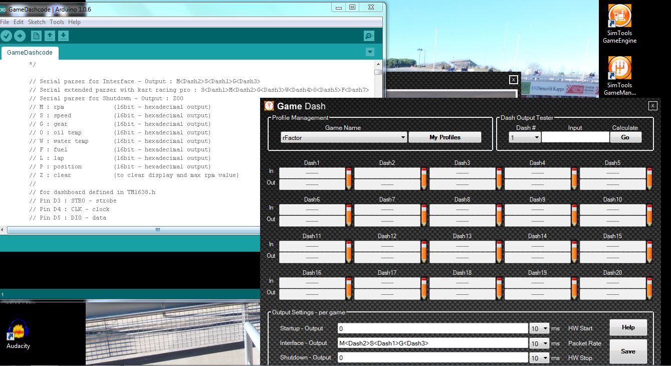

    So here's my settings for the game dash, any have any idea why im only getting the LED's lighting up for the RPM and nothing on the number displays ?

    Here's what im getting in game

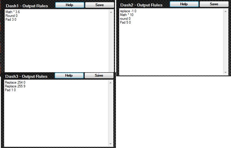

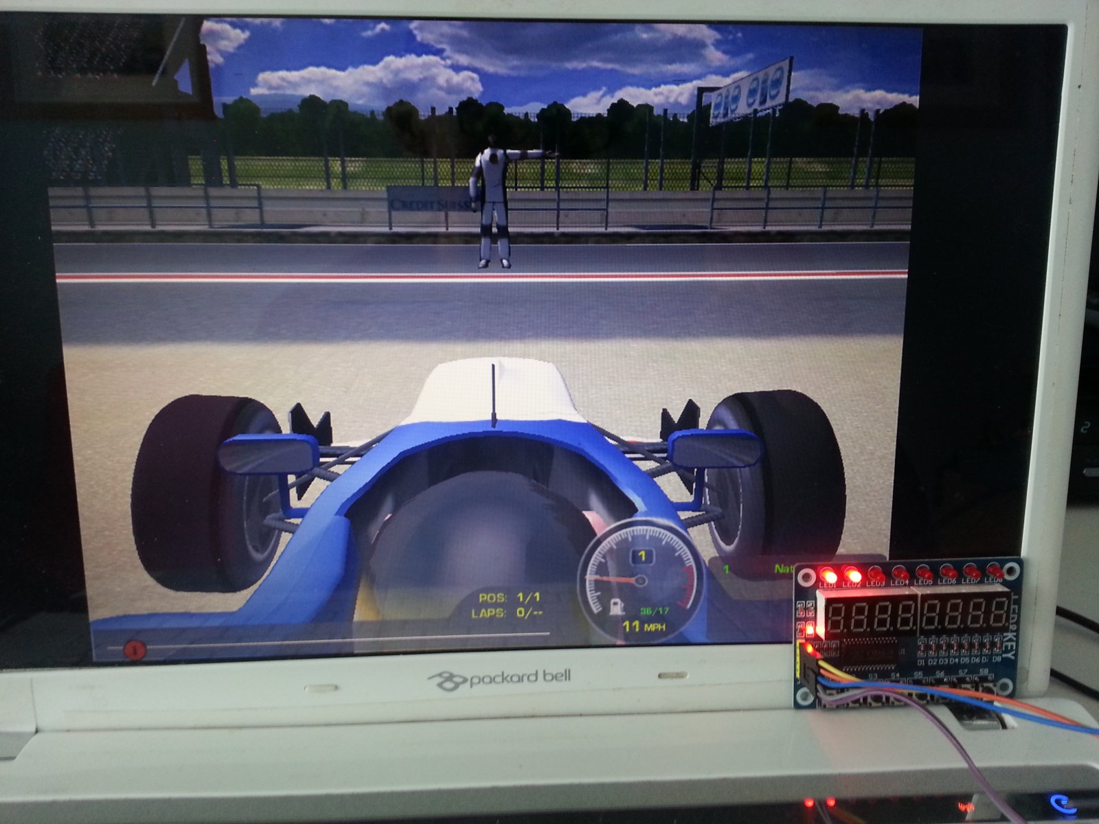

    Any here are my dash settings, the Numbers light up now and change as i speed up and slow down, but im not getting anything reading correctly.
    Im just looking for an LED rev counter, Gear number on one side, Mph on the other side.

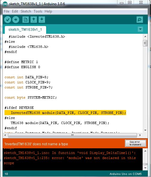

    When I try and verify the arduino code from that download i get this error
  18. Daguru
    Sep 4, 2013
    725
    Kitchen installer
    Wales uk
    233Coins
    +634 / 1 / -0
    Motion platform
    try this file unzip it in the libraries folder but just to be safe rename the tm1638 folder that u already have there
