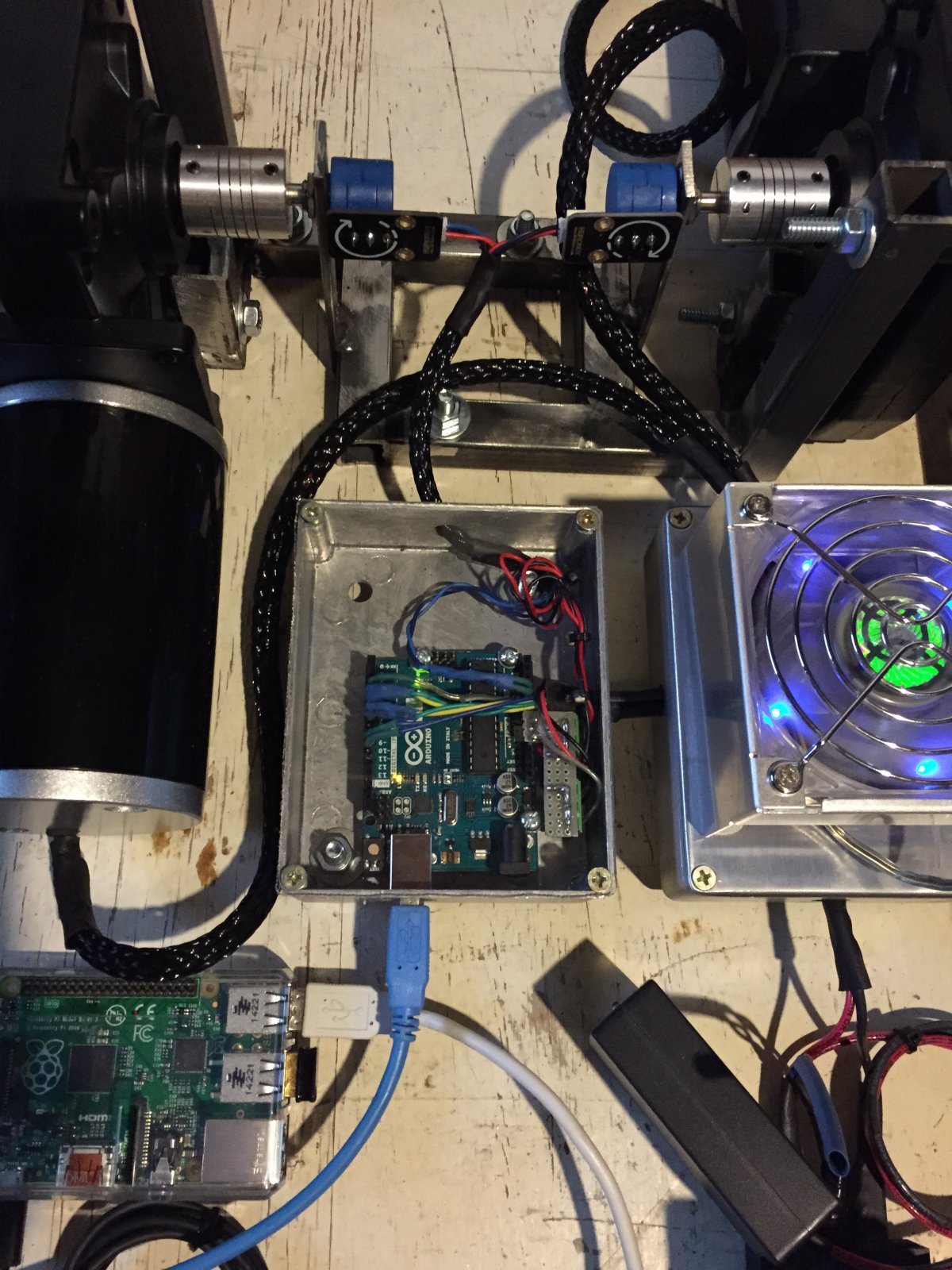

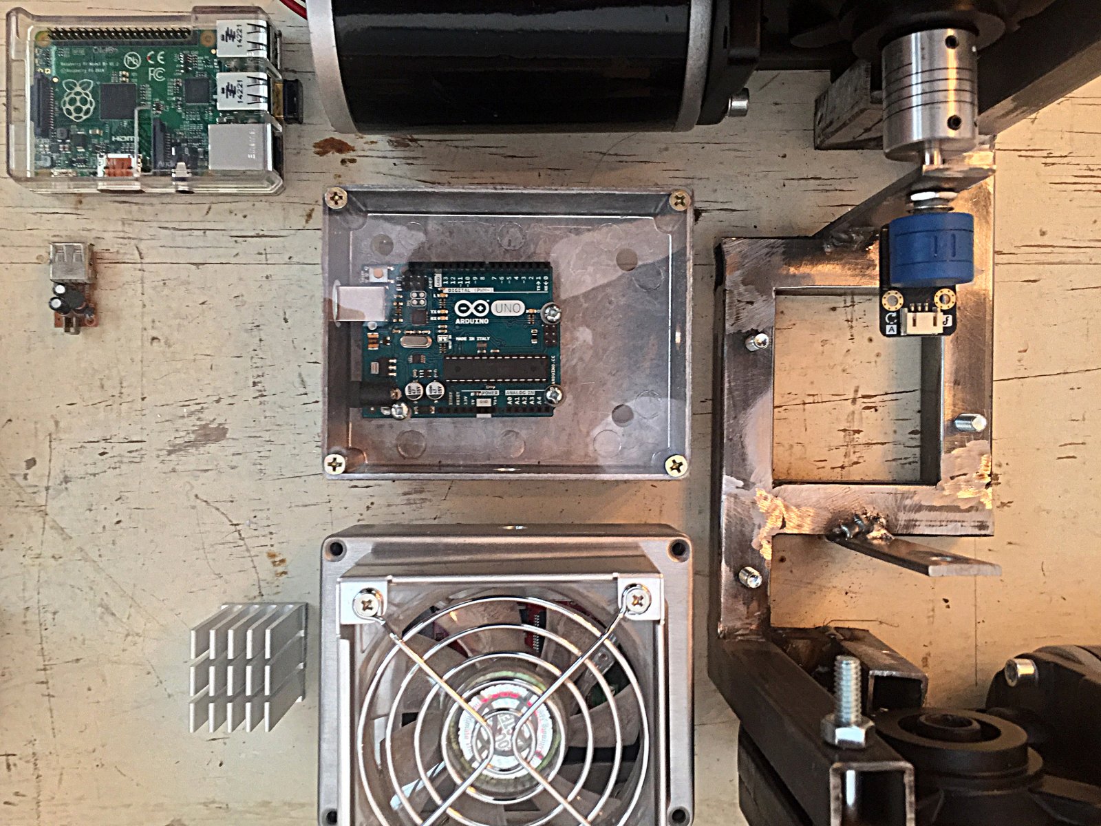

    Coming along. Have boxes for the Arduino, Motor Monster and Raspberry Pi B+ which will run version 1.0 of this thing. Using a 12v case fan and a chunk of an old mac heat sink to cool the Motor Monster, a 12v -> 5v USB car adapter to power the RasPi which will in turn power the Arduino. Slowly but surely.

    The RaspPi will power the Ardunio, program the Arduino, allow serial communication with the Arduino for motor control as well as provide WiFi connectivity potentially a web interface, etc. As @noorbeast mentions version 1.0 of this rig won't run SimTools but a combination of custom Arduino and Python code.

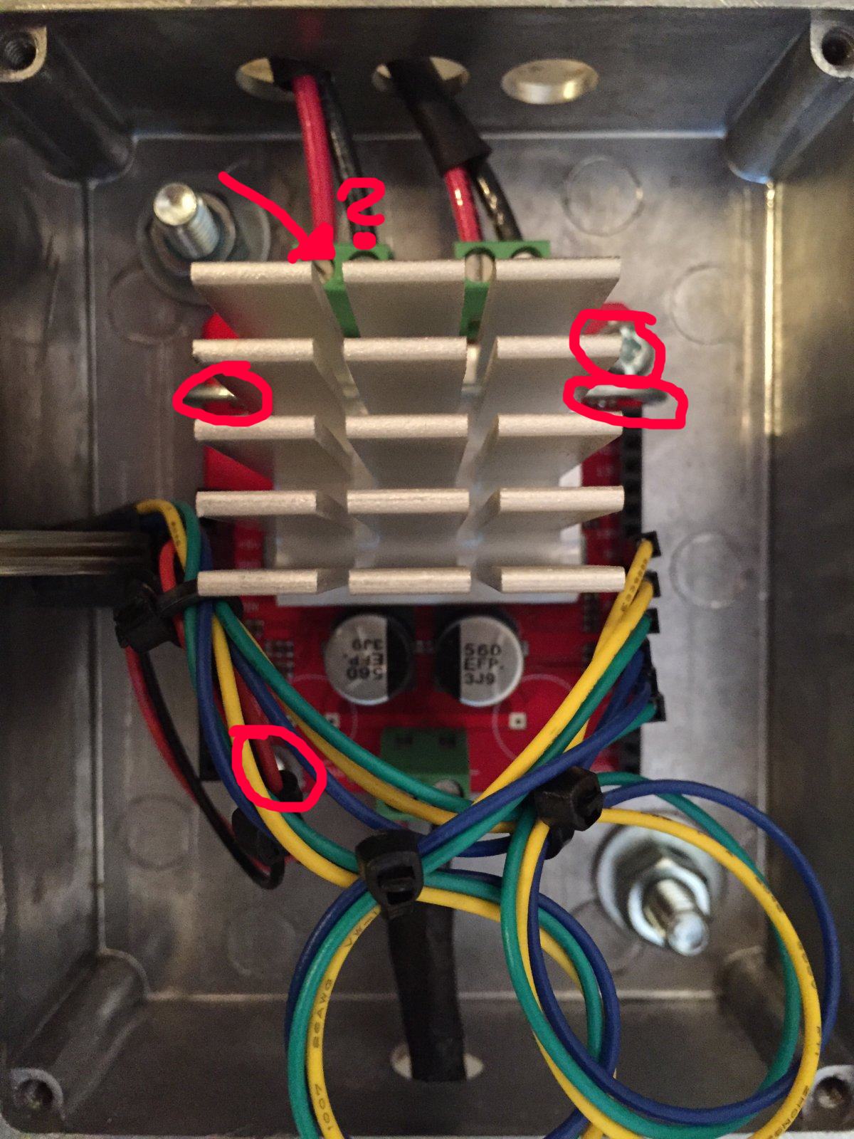

    Barg, I think I blew a channel on my Motor Monster, I was changing some code and one motor just stopped, upon the second try I thought I heard a pop now that channel of the Motor Monster doesn't seem to function.
    At first the direction indicator lights were both on, but having removed the heat sink and checking for damage (which there doesn't seem to be any on any components aside from the "something's burnt" smell) that channel still doesn't work, and the direction lights are off. Don't these things have protection?

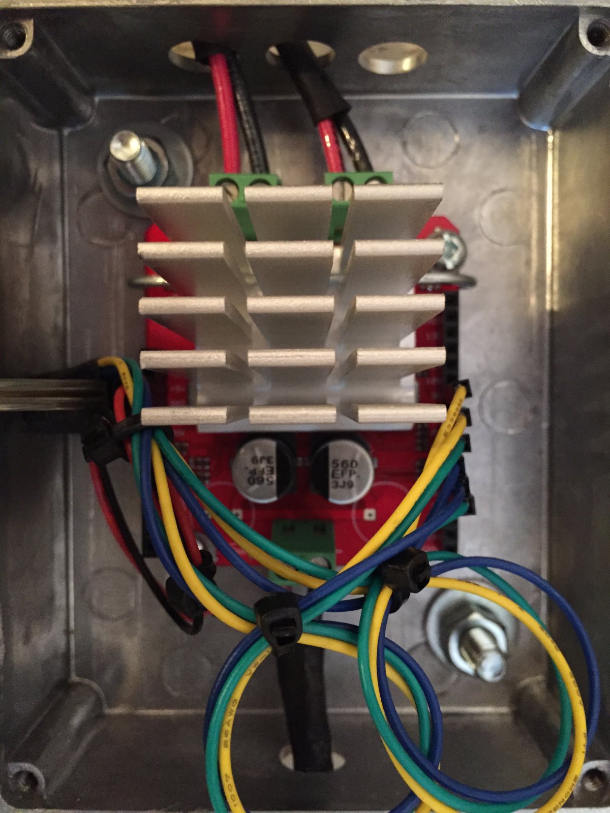

    The H-Bridge, the Monster Motor Shield from Sparkfun in this case, has thermal paste, a large heat sink across both chips and a PC case fan on the enclosure (pictured below). I was working on some code to accelerate (raise the PWM) when beginning a travel and decelerate back down when approaching the target, something was off and I suspect the motor got 255 PWM for potentially a couple of seconds. When I get a new H-Bridge I'm going to set a hard PWM limit to 100 I think.
    The power supply is a converted HP server which many folks seem to use.

    are you sure there is no possible short circuit?
