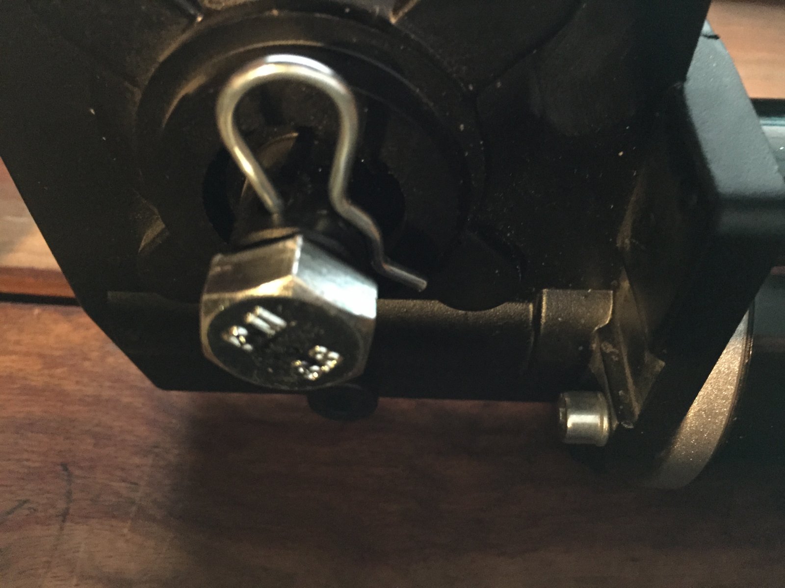

    So this is where I'm at now, I was planning on welding the head of this bolt to the lever and attach the pot coupling to the other side. Sounding like the popular suggestion is that I should tap the bore and use threaded rod as a shaft with bolts holding it in place instead?

    A simple Pin like that will Not be sufficient. I tried Taping the gear housing with threads and using set screw's, and this is what happened after a really good jolt.
    here you can see the set screw's in place.

    wait, so that last pic, the carter pin shreded the bolt like that?
  10. Nick Moxley
    17,057Coins
    +2,506 / 30 / -2
    No, that was to show the set screws.
    That is the current cofig on the seat motor's and holding strong.

    So I understand, the pin's purpose in that last shot is to keep that bolt in place, which is helping to marry the shaft to the bore and there's a matching bolt and pin on the other side of the bore on that shaft as well? In addition to the threaded bore and set screws?
  12. Nick Moxley
    17,057Coins
    +2,506 / 30 / -2
    The Pin in the last shot is preventing the Nut from backing off the main axle shaft. On my Seat motor's I only have the Set screw's and Single Pin preventing the Nut from backing off.
    Now On my traction loss i have a coder pin doing the same thing, Preventing the nut from backing off. As well as a 5-40 x 1" that i drilled through the gear and the axle to KEY the Gear to the Axle bolt. The Picture of the messed up axle bolt is when a Smaller (all be it Too small of bolt) broke and along with the set screw's did the damage in the pic, which is part reason i suggest a through bolt vs a Coder pin or similar.
    BEST case scenario is a Shouldered bolt sized to fit.
    The Picture you posted with the small pin will Not work, IF your main nut backs off it will SHEAR that pin in 1/10 of a second, and will provide little resistance to the axle wanting to "twist" in the gear.

    Ahh, a through bolt does certainly sound like a better option, I think I'll swap that out.
