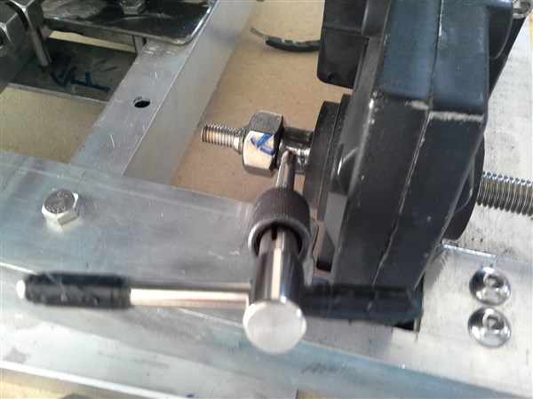

    I got 3 of the Motion Dynamic motors in one order and two took 12mm shafts and one 1/2. I concluded it must be a supplier batch issue and it pays to check the actual size. I am guessing that could be the same with similar style gearboxes.
  4. Nick Moxley
    17,057Coins
    +2,506 / 30 / -2
    Ive had 6 Normal style boxes through my shop and 2 of the "funky" boxes, All but the funky boxes took 1/2" Not that I dont believe you Noorbeast but i would be shocked if Motion Dynamincs guys are sourcing boxes from the same factory. Although anything IS possible.
    22,045
    153,866Coins
    +11,154 / 57 / -2
    That is what I got, three in the same box, but one was different and I didn't notice until I went to put shafts in them, as they look identical. Two have since been replaced with 60:1s.

    I thought I'd ask the seller I got the motor from, GEAR MOTOR 12 VOLT GREAT FOR SAWMILL/CRAB POT PULL/FEED 75-80RPM 50:1, before taking the path of attempting to hammer the shaft in and this is the response I got. They've been very good to deal with FYI.
  7. Nick Moxley
    17,057Coins
    +2,506 / 30 / -2
    Good stuff, so as i assumed 1/2".......Noorbeast you must have gotten the 1/100 fluke gear that was a 12mm Diam.
    22,045
    153,866Coins
    +11,154 / 57 / -2
    Sure did @Nick Moxley!
    They do look identical but I consider it too tight to try and hammer a shaft through and I don't have equipment that would let me drill a hole that large that long accurately. It was better to just change the shaft stock to the proper diameter.

    Further info from the motor seller, they've graciously offered a partial refund to make up for the fact that the listing details said the motors accept a 1/2" shaft, which the delivered motors, in their current state, do not. Wait for your motors to arrive so that you can measure them before sourcing shafts or machining parts folks.

    Can you post a picture of the shaft that youre using?

    I'm still waiting on the 12mm shaft I ordered to arrive. There's no way the 1.2" was going to be hammered in, the bore measured just slightly under 12mm, an extra .7mm wasn't just going to get hammered it. The 1.2" shaft and the 12mm shaft are both listed in my parts list (which I'm updating) on page two of this thread,

    Curious why you would use solid shafts and not just threaded rod ? Are you planning on relying on the small 4mm key holes to secure the shaft to the gear ?
    And FYI the only reason we suggested to tap the shaft in with the hammer is the fact we assumed you were using the right size axle for the gear. Add in the fact the 4mm key holes have a little bit of flashing left over from being drilled at the factory That usually catches on the threads of the Threaded rod and can easily be tapped with a hammer. Obviously we know a 1/2" rod Wont fit into a 12mm hold.

    Yep I did warn it was necessary to check and get the right shaft size.
    On my hollow shaft gearboxes I tapped the shaft and used M6 bolts to secure the box the the shaft.

    Yes, I was planning on using the key holes and beefy spring pins to hold the shaft in place, hopefully in addition to a good friction fit. I don't have a tap/die set at the moment I never considered tapping the bore. These forums are a wealth of knowledge, but the best approach is sometimes difficult to discern with limited tools. I'm pretty new to machining parts like this, the first suggestions of tapping it into place did seem feasible until I had another look at the parts and measured again -- I didn't mean to offend anyone.
