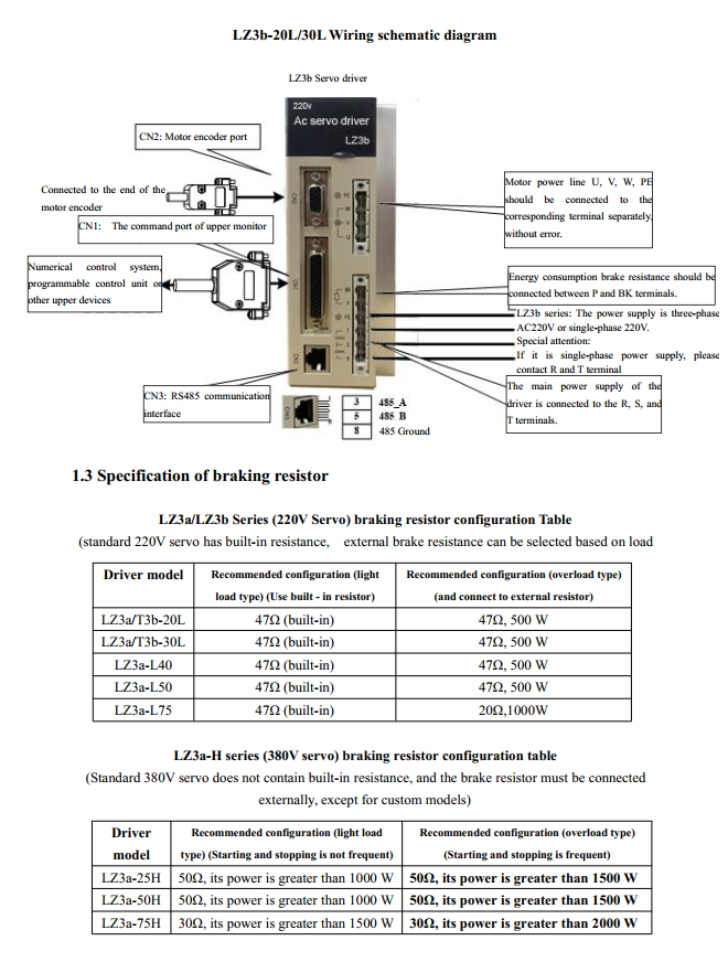

    Hi M4S, and pmvdca for that matter, love your work guys. I appreciate the input to our community.
    I'm about to start buliding a 6DOF stewart platform, done lots of reading and selecting hardware and I have two questions that I haven't found clear answers to yet:
    • Is a hardware interface, such as Thanos or M4S, required? I dont mean to detract from those awesome PCB's, just trying to fully understand.
      • Or can the same results be achieved using FlyPT (and also now SimTools 6DOF support)?
      • If hardware is required, does M4 board work with other motor controllers? Such as Lz3b-20LM? (pic of interface attached). This interface comes with a 44pin HDDSUB connector instead of the traditional 25pin DSUB, but appears to have the same pin names. It does have RS485 ModBUS but no RS232.
        I ask because I was quoted a reasonable price for 80SL-02430 with Lz3b-20LM driver and 32:1 planetary reduction.

    hi ,yes it looks like a self-made cable can be used to connect to the existing servo motor controller. But with the circuit diagrams here alone, it is not safe to say whether all functions will work safely. I think you should go to the aasd driver, I'm not sure if the possible price difference is so big and justifies the work for the cables.
    But on the other hand it would of course also be interesting to see whether other drives work with the controller. upload the manual and send the download link here. i will have a closer look.
    and yes, basti is correct, you need a controller for the servomotors, only software alone cannot do that.
    There are of course many approaches to construction. Ultimately, there are two ways (rotary and linear) with both advantages and disadvantages. the base and upper should always be slightly different. symmetry is always advantageous for the greatest possible range on the axes. if you make the upper platform proportionally smaller you get bigger angles. but the topic is so big and there are some good contributions here in the forum. try to simulate your ideas with movers 3d output. you can easily find out the situation there.
    if you live in europe i can lend you a controller to try, here it makes sense with the shipping costs. pm me for details.

    OK, I didn't make my question clear enough :)
    Thanks Basti, and M4S for your informative answer.
    I currently have a small 6 RC servo unit working on my bench, I built it only to serve as a test to see that I could get what I needed from simtools into a 6DOF platform and measurements were arbitrary. Then I found FlyPT and worked only with that. I modelled the design in FlyPT as built (6 evenly spaced servos on 110mm base and close enough to triangle on 104mm top). I wrote some code on an Arduino to receive data from FlyPT and drive 6 servos. I hooked it up to iRacing and configured what I liked. I also used a joystick as a source and use that for testing range of motion etc.
    My question around needing a device such as M4Sim came about because it seems FlyPT does all of the pose pretending and outputs servo locations as required, isn't this the major function of the M4S?
    Provided I can get the required servo locations to the motor drivers supplied with the motors, I could simply use my Arduino to receive FlyPT data and send it to the motor controllers. Theoretically, I could even plug 6 serial adapters into my PC and use one each for the motor drivers without the arduino interface.
    Yes, I agree these are stand-in hardware for the M4S, but the question was really "can I do [the above] without the need for additional hardware such as M4S?"
    • Thanks for the offer of loaned controller, but in Australia here and if required I'll be happy to purchase :)
    • As for making that cables to suit, for me thats a trivial task which I perform daily.
    • I have no experience with ModBUS but am comfortable with RS485 and I feel like the only requirement for me to buy an M4S (or Thanos) at the moment would be to get the RS232 data into RS485 modbus. And I feel like thats something I should be able to figure out. I guess I'll find out this weekend :D
    • The cost difference is significant, at the moment I can get the Motors, drivers and planetary 32:1's for ~ US$1900 direct freight (US$533 freight! $200 for sea freight), I cant get close to that for whats available with AADSL15A at the moment :-(
    Whats available does change rapidly so I'm checking regularly, but the quote I have from an AliBaba supplier is the best I've come up with for the last month of looking. If someone is aware of 80-M02430 with gearboxes and AADSL15A's for a similar price I'm just as happy to go with another supplier :)
    I'll upload the manual tomorrow and provide a link. Cheers guys.

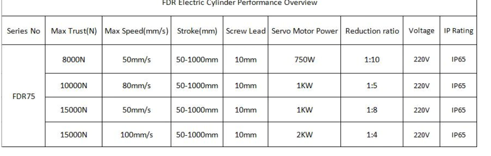

    Hello, would these be able to control linear actuators
    e.g.
    FDR075 Heavy Duty Servo Motor Angetrieben Elektrische Zylinder Linear Antrieb Max Schub 10000N Ersatz für Pneumatische Zylinder like you can get on aliexpress??
    for a 6 dof racing/flight sim??

    Hi these actuators are too slow for sim motion ... sfx is (5mm pitch) max speed 250 mm/s and my rotating actuator is 600mm/s but these actuators are strong ask them for redutction 1:1 then speed goes up .
    these motos should be aasd servo drives to work with the controller

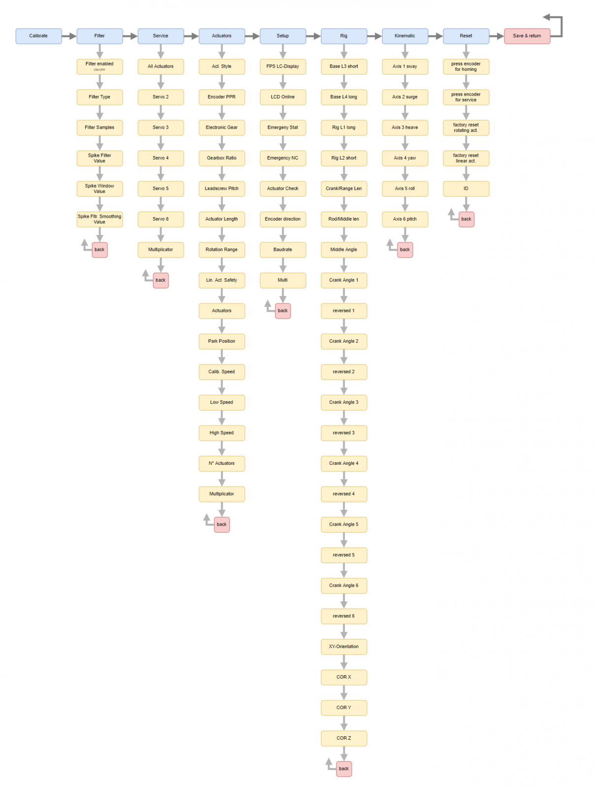

    1. I noticed that when I flip the switch to "Online" the rig goes to a position that is about 50% extension. From there it then folllows the motion commands. Is there a way to set this position on linear actuators? I'd love to be able to set a certain length for that. Either "global" or on a "per actuator" setting.
    2. I noticed that when I use the emergency-stop button, it completely depowers the motors. Is there a way to change that behavior so that it only freezes the rig? I'd love to be able to choose wether I want a Depower or a Freeze function on that button.
    Cheers,... Dirty :)

    ...and in case someone gets lost in the menu. Here's a map:

    Thank you @Dirty for your feedback. I am glad that you are satisfied.
    thank you for menu map.
    to answer your question.
    to setup different parkingpositions or standby positions there are some options already included in fw
    so you can play with actuator stroke and or increase the safety length so park and standby positions could be moved. but the standby pos should always be in the middle of the actuator length i think?
    i have finished new fw update and testing is done . there is a update for using an extra pin for switching servobrakes and an additional option to set an offset for the linear actuators start position for each individual actuator. this is normally used for calibration of endless slew actuators.
    also actuatorcheck option has been approved . will upload the new fw next days.
    you can already change the behaviour of emergency switch in ->menu->setup->Emergency Stat
    "ON" : Servos were switched off and rig falls down
    "OFF": Servos stop working but are energized and hold position
    also you can setup the way of emergency button is switch so normaly open and normaly closed.
    checkout the manual page 25 i think.
    please feel free to ask more questions.

    Ahhh there it is! Yes, that's what I was looking for! :thumbs
    I overlooked "Emergency Stat" because I thought it was some kind of statistics how ofter the user needed to emergency-stop the rig.
    Maybe it is my childish naivity, but does it make sense, to have to set it to ON to have the motors go OFF... and set it to OFF to make the motors stay ON when the button is used? :D
    Cheers,... Dirty :)
