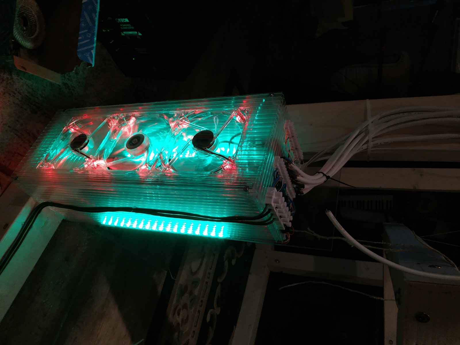

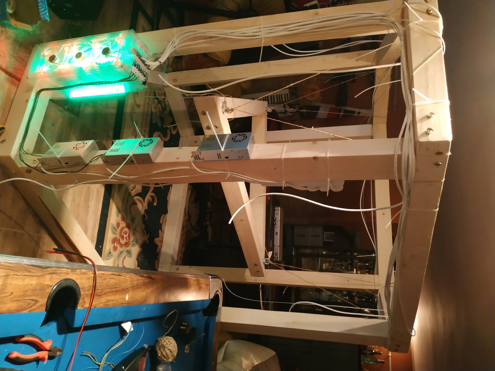

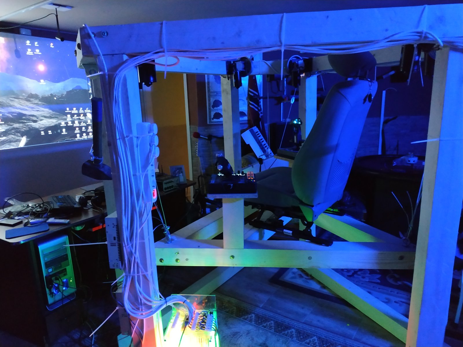

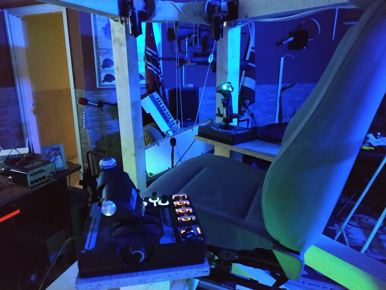

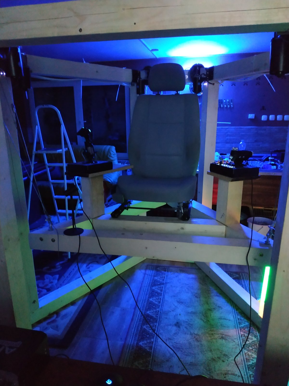

    Hi All,
    I have finished my project. The first test are VERY impressive, seems to works well.
    In the next few days more tests come, and I'll make a video of it's working.
    Here are some pics of the 80% finished system.
    Chhers,
    George
