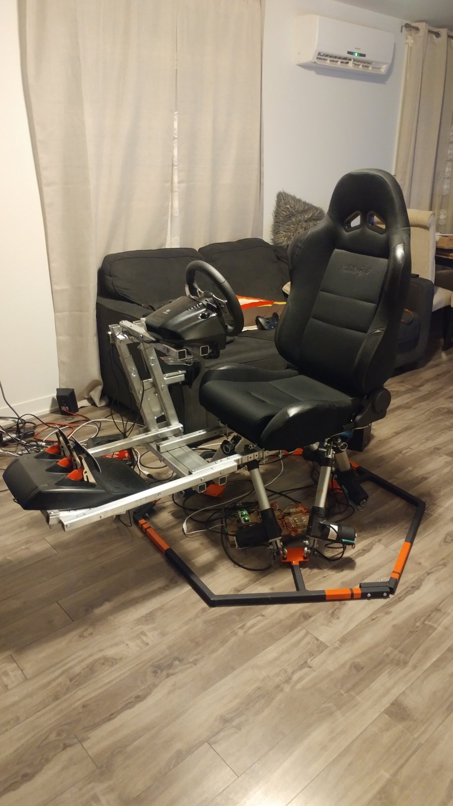

    Hello everyone,
    2 years ago, I presented for the first time a DIY 6DOF working concept. 2 weeks ago, I finished the 2.0 version of that project. This new version has been improved significantly in terms of motion. I’m extremely proud to share my project with all of you.
    Take a look! I’ll be posting videos soon, stay tuned.
    Cheers,
    Michael

    Interesting. Are these DC motors?
  4. agroum
    agroum My solo 11 years ago
    Jun 24, 2017
    15
    Mechatronics engineer / part time aero master
    Canada
    154Coins
    +20 / 0 / -0
    Motion platform, 6DOF
    Yes 12V, I use 3 roboclaw drivers, but all the regulation is made in an other board.
    Simtools is only used to send the raw data to the controller.
    It allows to make figure like a circle or an 8 in a plan.
    The time between the set point and the position value is between 30 and 60ms with a maximum error of 1/3 of mm when there is a peak and an average about 1/5 of mm.
