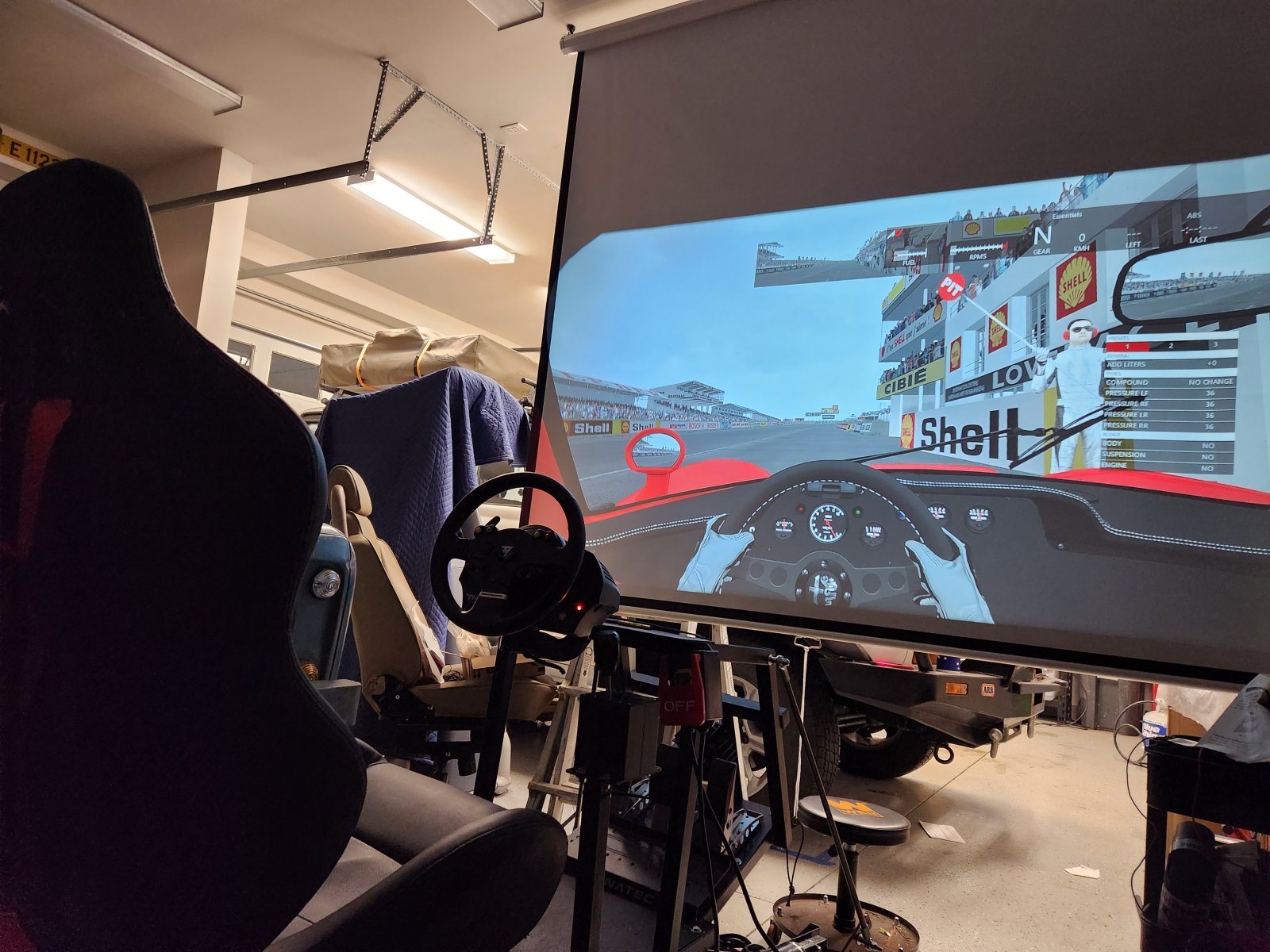

    Off to the next phase of testing. Did a tiny distance in AC but suffering from one motor that shuts down .. either its getting out of range or the IBT is overheating. Not sure what is going on yet but that's a thing to check tomorrow.
    On the plus side, the drop down projector screen and projector are doing a good job. Will move the rig closer at a later stage though.

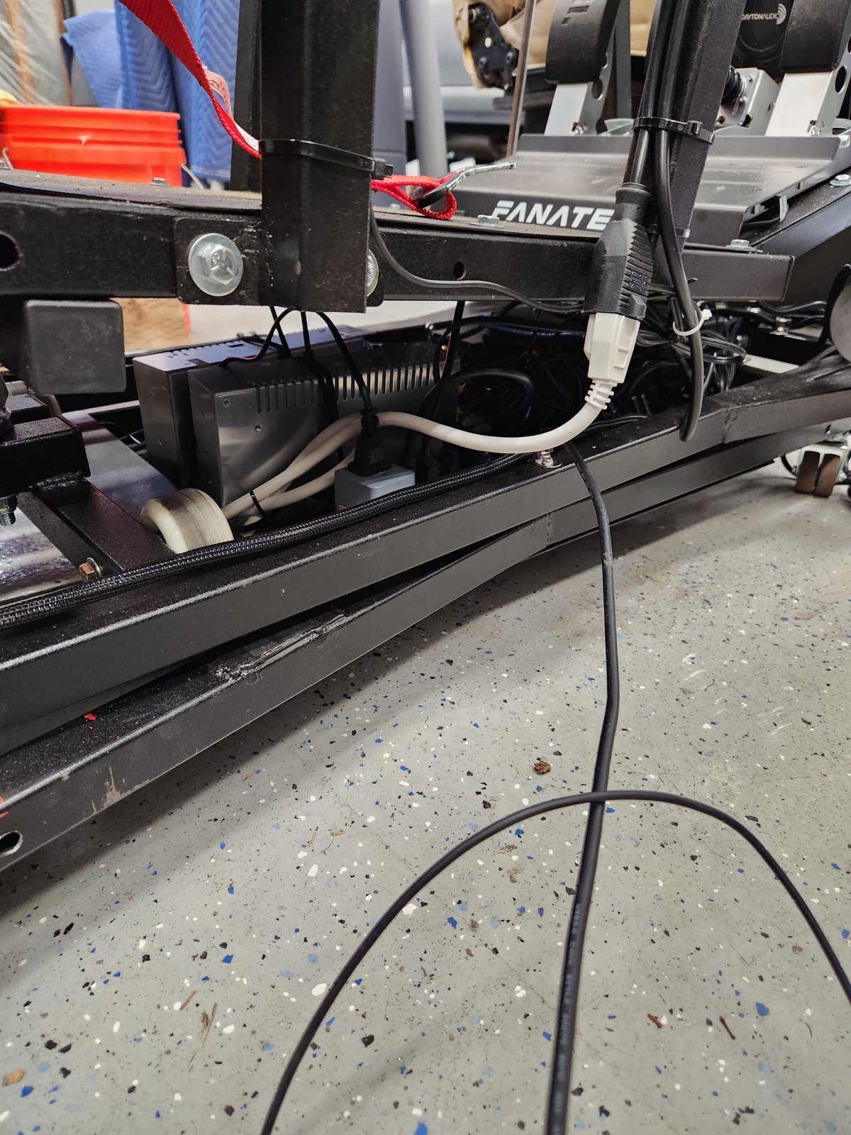

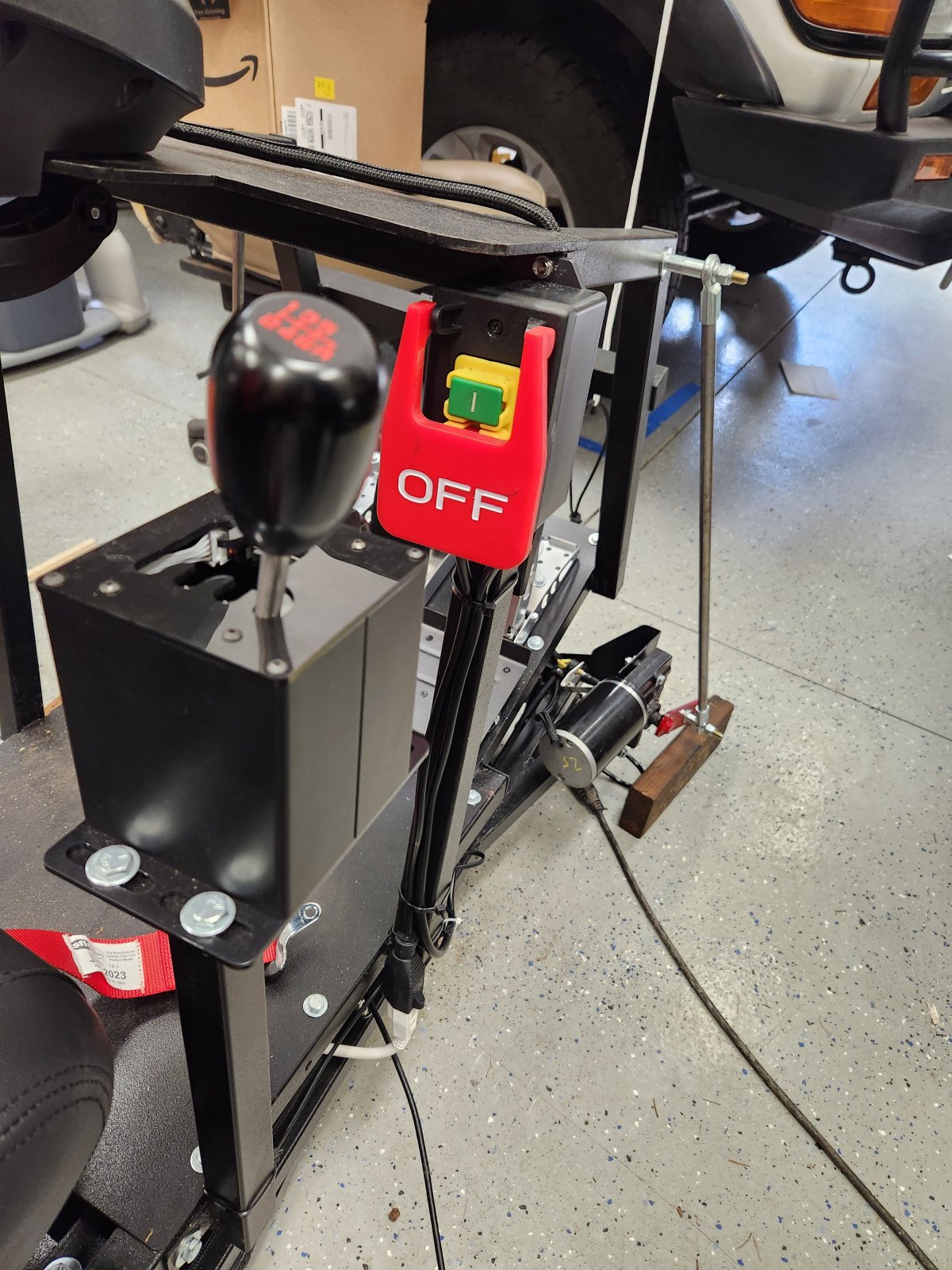

    The height of my ujoint has both a disadvantage and an advantage. The negative is that when power is off, the arms and motor drop outside of the max clip limits. To solve that I am going to fab up some arm stops that will mount to the bottom of the motors. It's not a hard thing to fab but something that's needed for usability.
    The plus is that it gives me plenty of room to hide and secure all the electronics on top of the bottom frame plate as seen below. It creates a really clean look and access is easy by removing the floor board.
    Like anyone really should, I did install a emergency button. You can find these on Amazon easily for not much money. It's a tiny bit big but it's easy to find the shut down if needed. It's just screwed into the frame. 20230119_124227.jpg
    The wooden blocks are the current temp solution to prevent the drop.

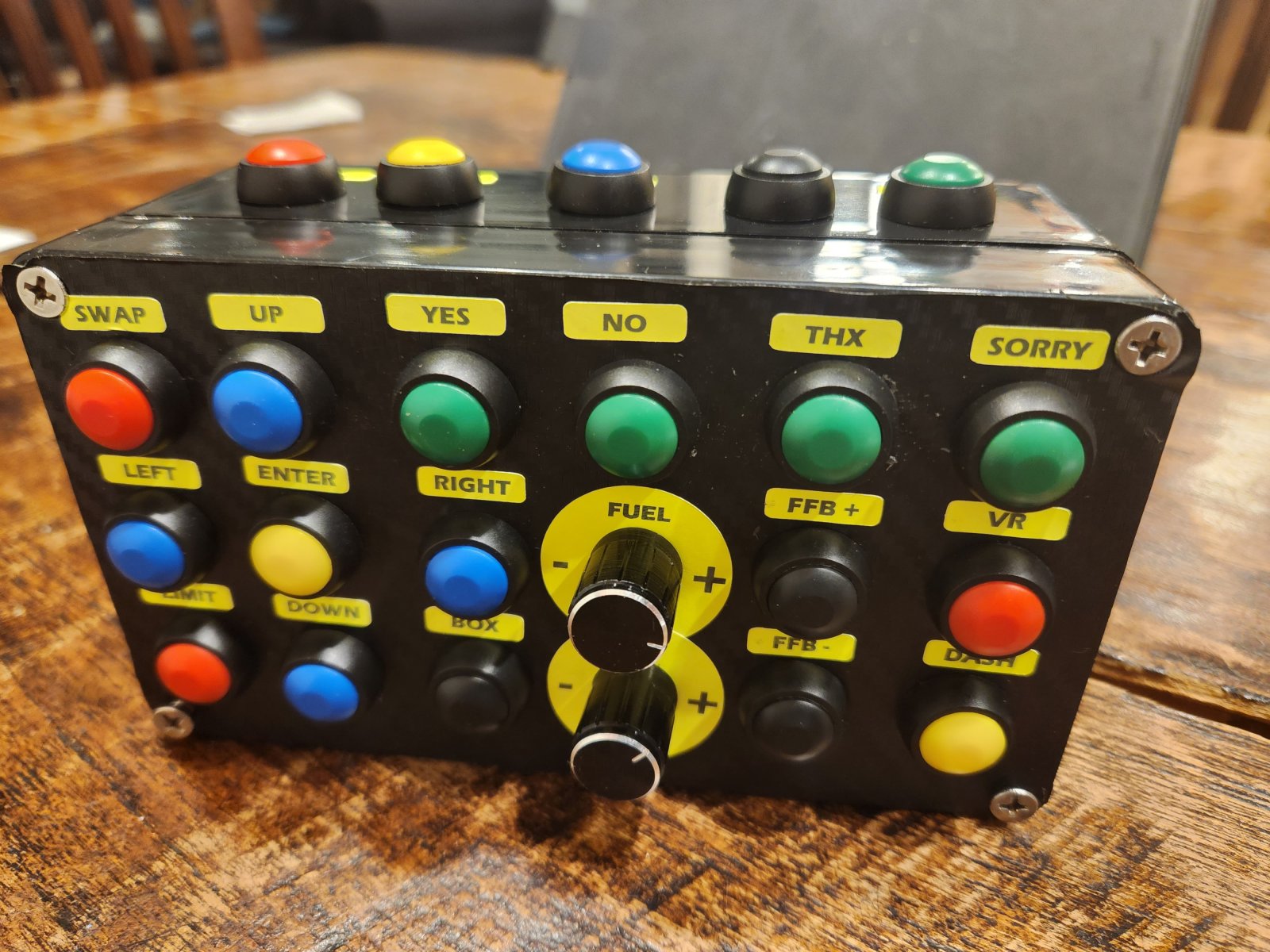

    Let's see how many buttons I can fit on my second button box. Still tinkering with simvibe and trying to track down why my traction loss motor stops functioning after 3 turns or so.

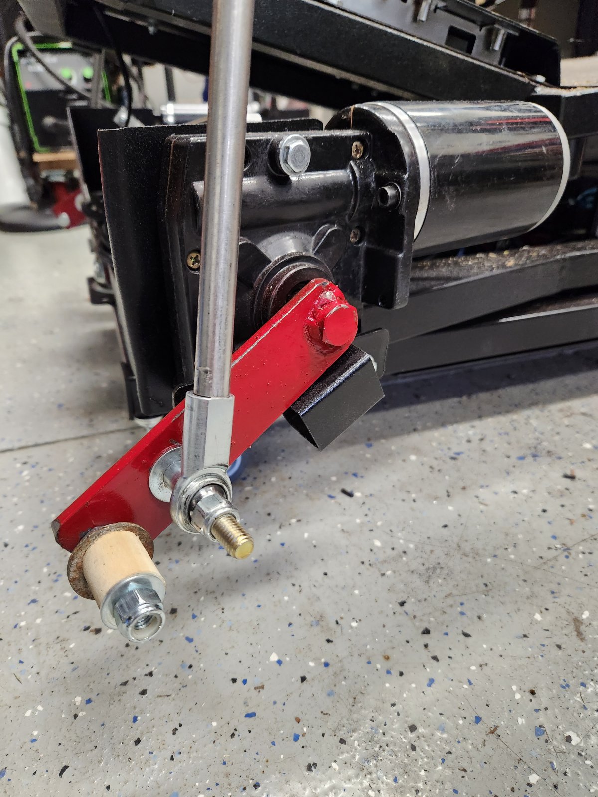

    Reporting back on my rig after I have been using it for 3 months. I struggled for a while with the motors here and there getting out of range and fabricated stops for both ends the maximum range which really stopped the problem
    Here you can see the metal tube mounted to the motor being the rest stop and the little wooden dowel on the arm being the top stop. It's wood as I wanted a little give in the material if needed.

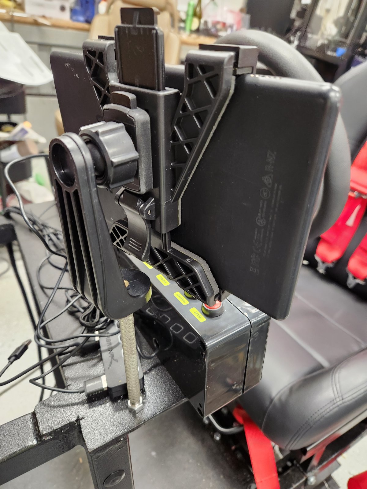

    I also found a much better solution for my sim dashboard. Using an old Kindle fire for this. The mount is a simple camera tripod extension with a tripod tablet mount. Drilled a hole in the top plate, small bolt holding it down and it's been solid.

  15. noorbeast
    21,720
    152,027Coins
    +11,062 / 56 / -2
    Just a note of caution, hard stops may be an issue in a runaway situation (pot or other failure). Long term it would be better to address and fix the out of range issue, which may be settings and/or inadequacy of the motors.
