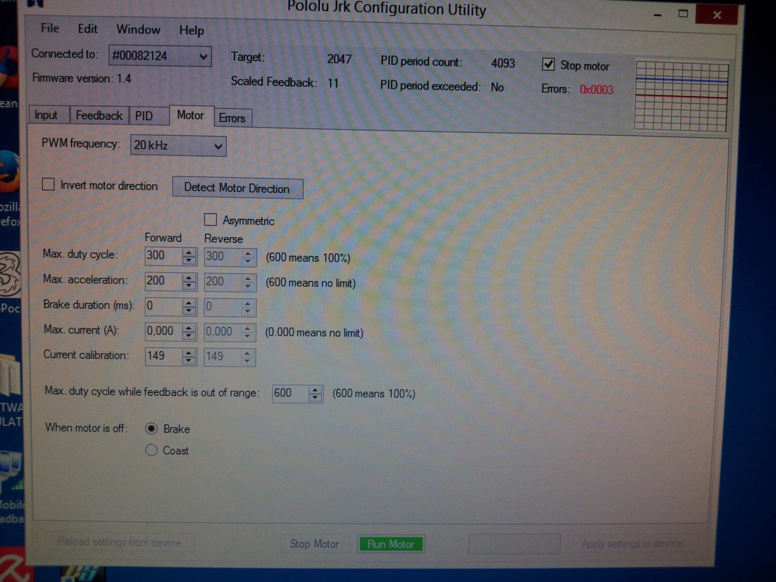

    +1,687 / 23 / -2

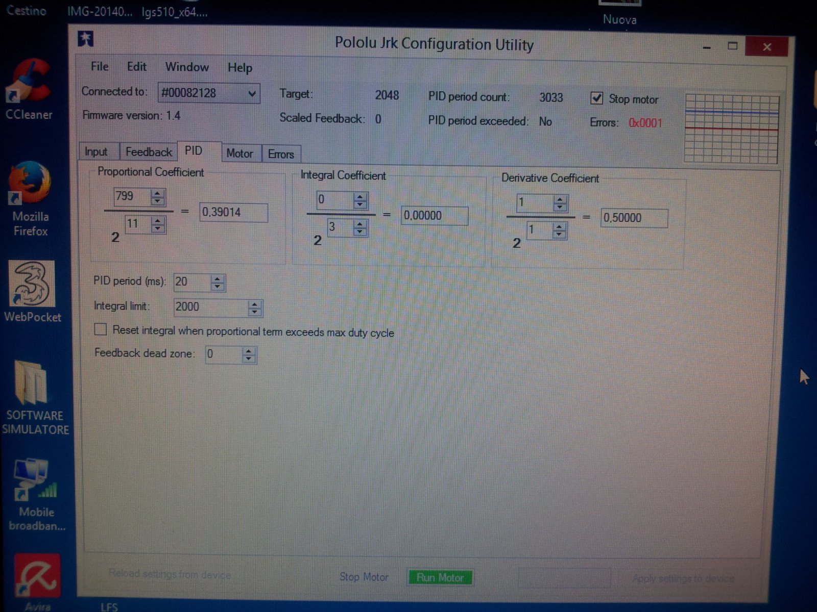

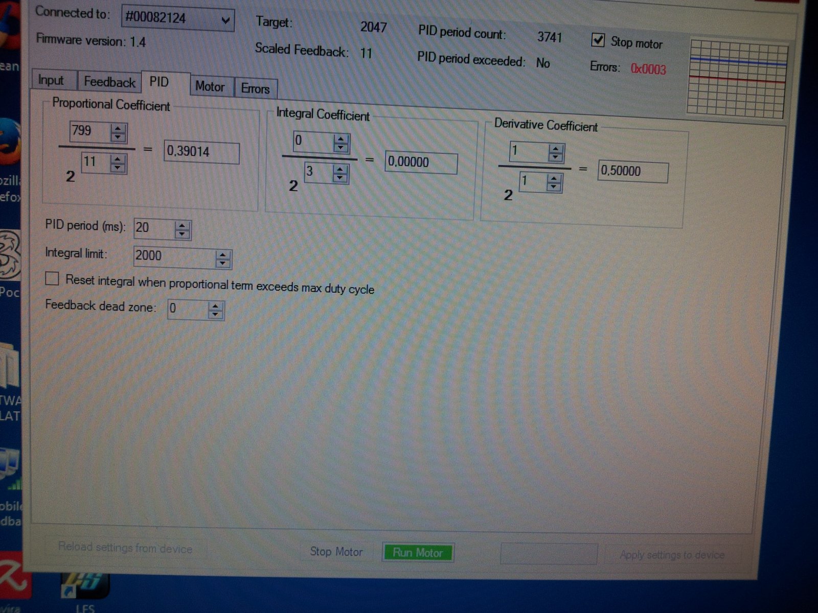

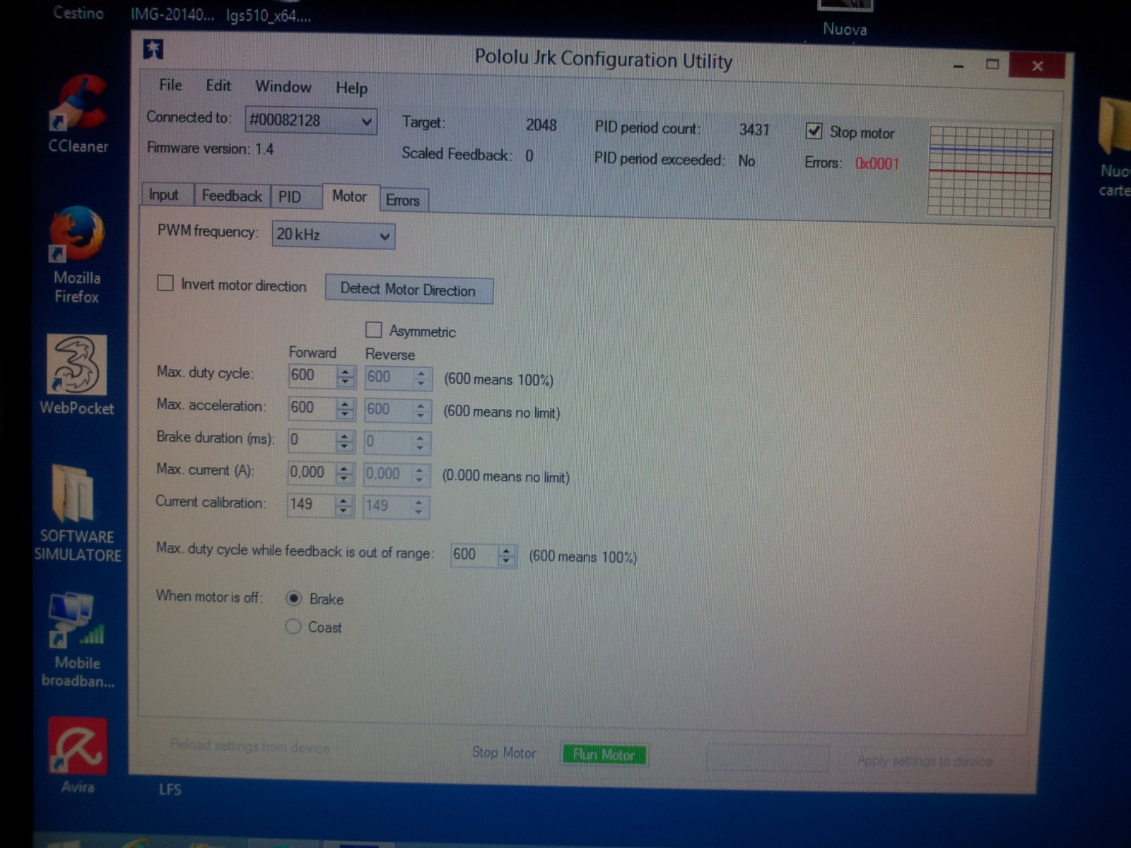

    Ok slow the motors down, change the max duty cycle to 300 and accel to 200.
    retest if not stable at 0 then a pid tuning will be needed as the motors are not the same
    Try adjusting the speeds and test manual slider , increase them if stable movements.

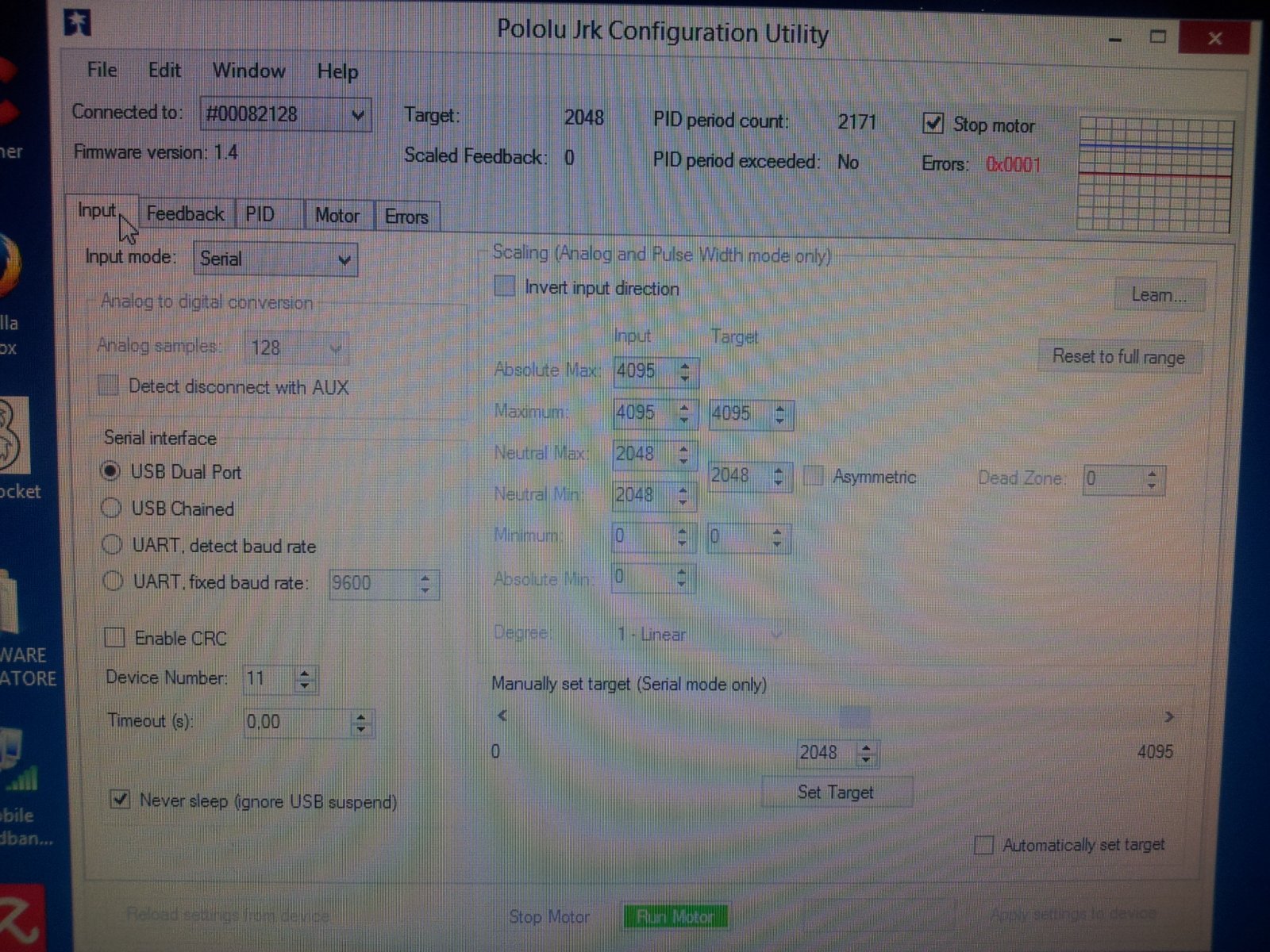

    here the images of configuation

    do you think it's a pololu jrk configuration or xsimulator configuration?
  9. bsft
    you havent set the feedback.
    I can see that.
    did you move the motor/pot to a max position, set and then to a min position, set and apply settings?

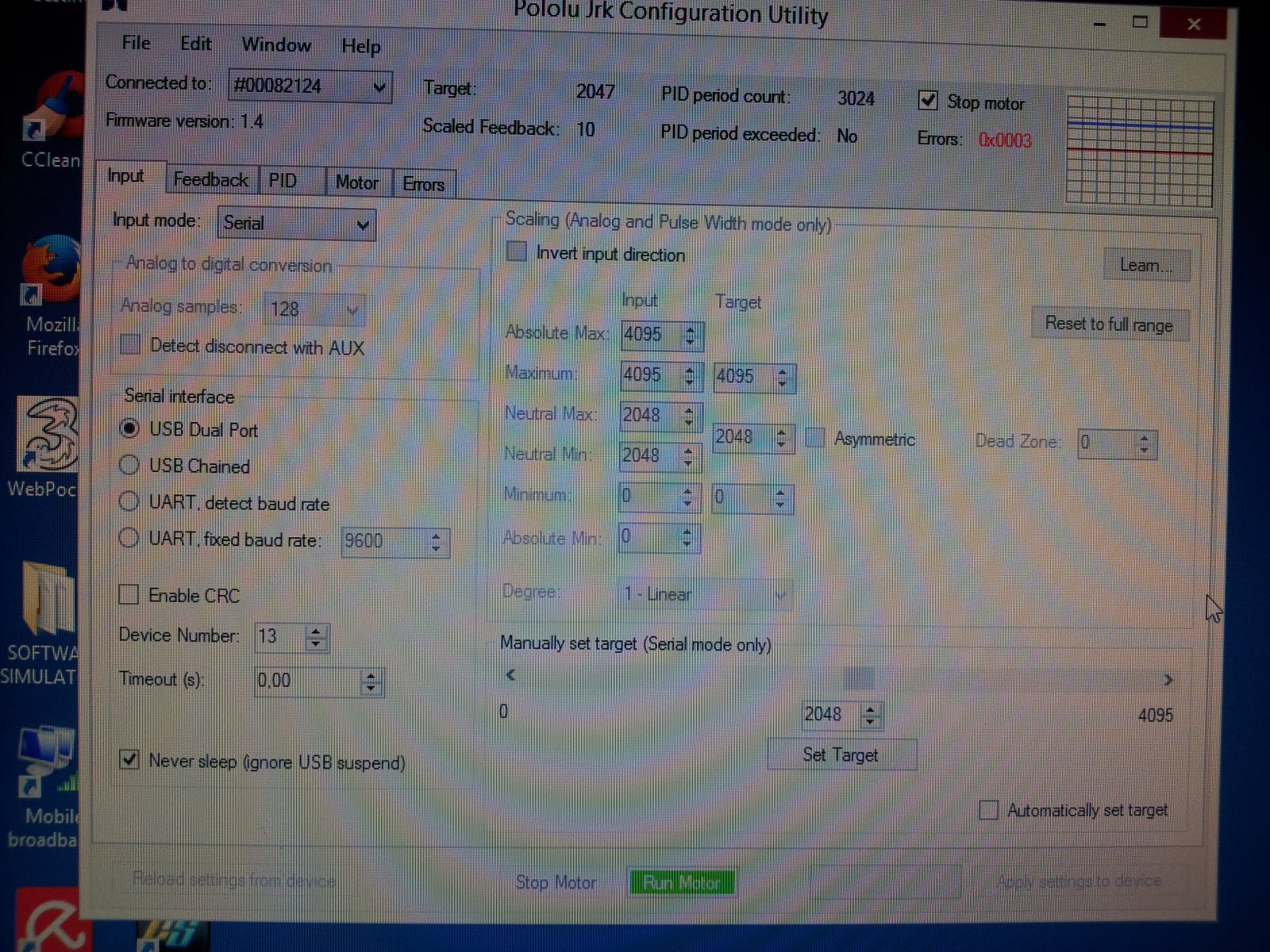

  10. eaorobbie
    20,503Coins
    +1,687 / 23 / -2
    Before even trying SimTools you need to test via the Pololu Configuration utility.

    not resolved. I change the max duty cycle to 300 and accel to 200 but the poblem is the same.
    As need to translate your post and suggest in italian using google translator please write in correct english
    avoiding abbreviations.I have no knowledge of electronics and for me The setup is extremely difficult. imperfect understanding of the posts due to a faulty translation makes everything more complicated
    thanks for your understanding and help

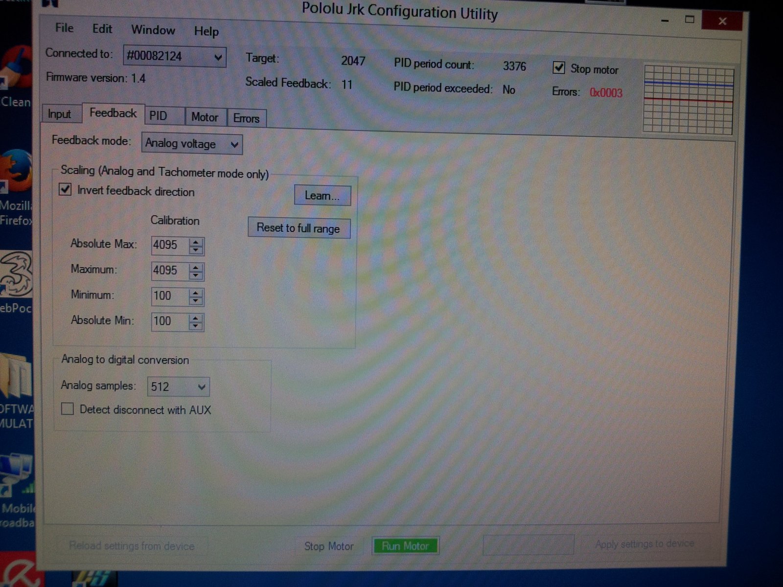

  12. bsft
    again, did you set the feedback correctly,
    your feedback settings are wrong
    4095
    4095
    100
    100
    thats not right.
    Look at the video I posted and you can see that the numbers should not be like that.
    Do you have the pot attached to the motor shaft?
    Move the motor in one direction like I did with the joyrider frame, set the max, then move it the other way and set the min.
    Granted the pots were connected to the frame and not the motor, but it is still the same principal for setting feedback correctly.
    did the videos help or not?

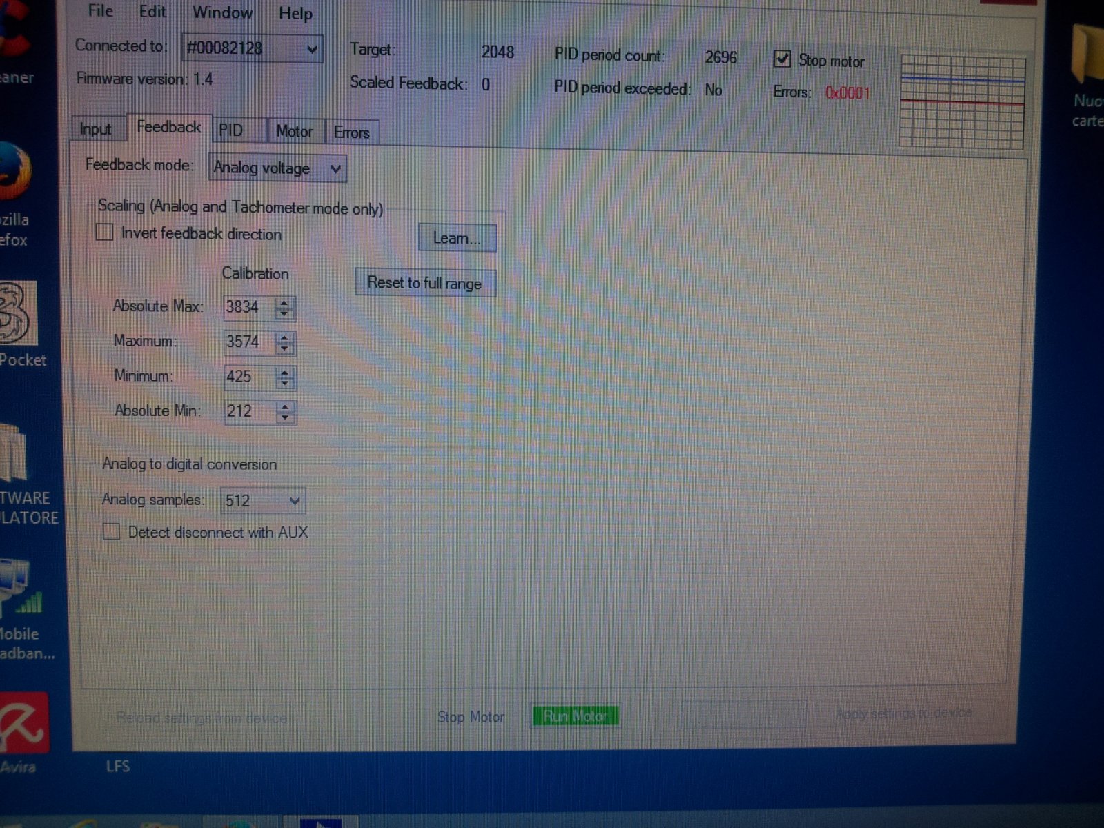

  15. bsft
    ok, feedback looks better, but something is not right. Maybe you need to find the centre of the pot reading.
    Now, I suggest to take the wires off the pot, and get a multimeter and with ohms reading, wind the pot shaft back and forth till you find a middle reading.
    Example, if its a 5kohm pot, centre would be about 2.4, 2.5 kohms.
    Once you have done that, centre the lever on the motor, re-solder the pot wires and try again.
    It could be the centre of the pot is not right and or you have wired the pot wrong.
    Check that.
    if its all ok, then reset feedback and test the motor in the input tab. Forget the "motor centre" command in jrk.
    The video is too dark to see whats going on.
    I have sent a message to @eaorobbie so he can check. he should be online in a few hours.

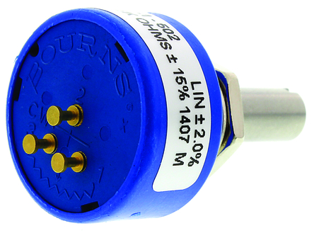

    As I wrote .... I have no knowledge of electronics .... so I'm not able to use a multimeter. In any case, as I mentioned in the previous posts, connect the Pots. these are the Pots
    http://www.conrad.it/ce/it/product/...639S-1-502-single-turn-Lineare-5-kOhm-1-W-15-
    I connect to GND 1, 2 and 3 to +5 to fb

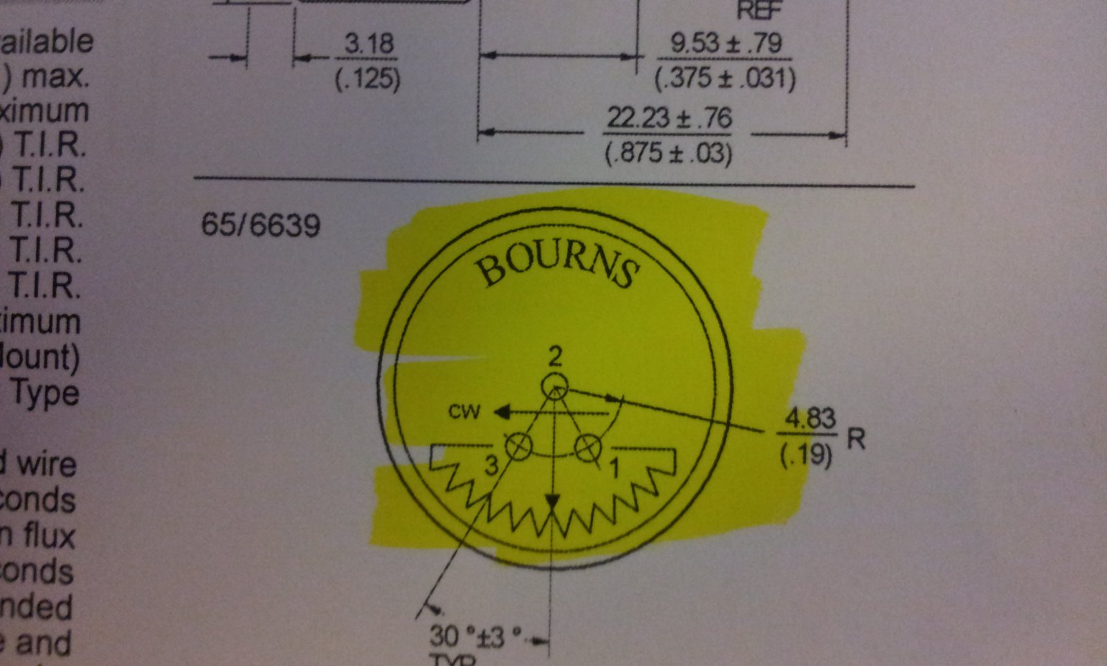

    Can you take photos of the side of the motor where the pot is fitted please.
    You may need to swap the wire GND and 5v around.
    I found sometimes even though I follow instructions, the wires need to be set opposite.
    Again, I suspect you may have the potentiometer set wrong.
    The pot is a 340 deg turn, not a 360, that means the pot will have a stop point. Has that been broken at any stage by the motor spinning around with the pot fitted.
    The pot has its own centre that cannot be found with the JRK utility.
    Its basic electronics.
    Connect the red wire of the multimeter to 2 and the black wire to 3. Read off the display until you find the maximum reisitance, the minimum resistance and also about half way in between.
    If you cannot use a multimeter to find it, then find someone whom can help you.

  19. bsft
    thats more like it. Well done!
    Now find the half way reading as you can see and thats the centre of the pot, match that with the centre position of the motor.
    http://au.rs-online.com/web/p/potentiometers/1642661/ these are the ones I use, but even a 270 deg cheap pot will do as you would be only using 150 deg turn of a motor.
    A 360 deg turn pot is a safeguard in case the motor spins freely , so the pot does not break.
    With yours wind the max accell right down to 100 so it turn very slowly, so if the motor goes the wrong way, you can hit the stop motor in JRK utility.
    Once the motor goes the right way and moves the right way in the INPUT tab of JRK utility testing with set target slider , (tick automatically set target box first) apply settings, click run motor and slide the bar back and forth to see if the motor lever moves up and down.
    It it goes around the wrong way at first, invert the feedback direction box in feedback. If that still doesnt help, invert the motor direction tick box in MOTOR tab . test and re test.
    Once its set right, change max accell back to 500 and that should do it.
    I connect Vin to 1 , feedback to 2 and 5v to 3.
    If it goes crazy, I reverse 2 and 3 connections. No it should not damage anything.

    2DOF, JRK, 4DOF
    pot have a range 0f 5,32 so the center is 2,66.
    Now with the pot in the center (2,66) What should I do to communicate to jrk that this position is the center of the motor?
