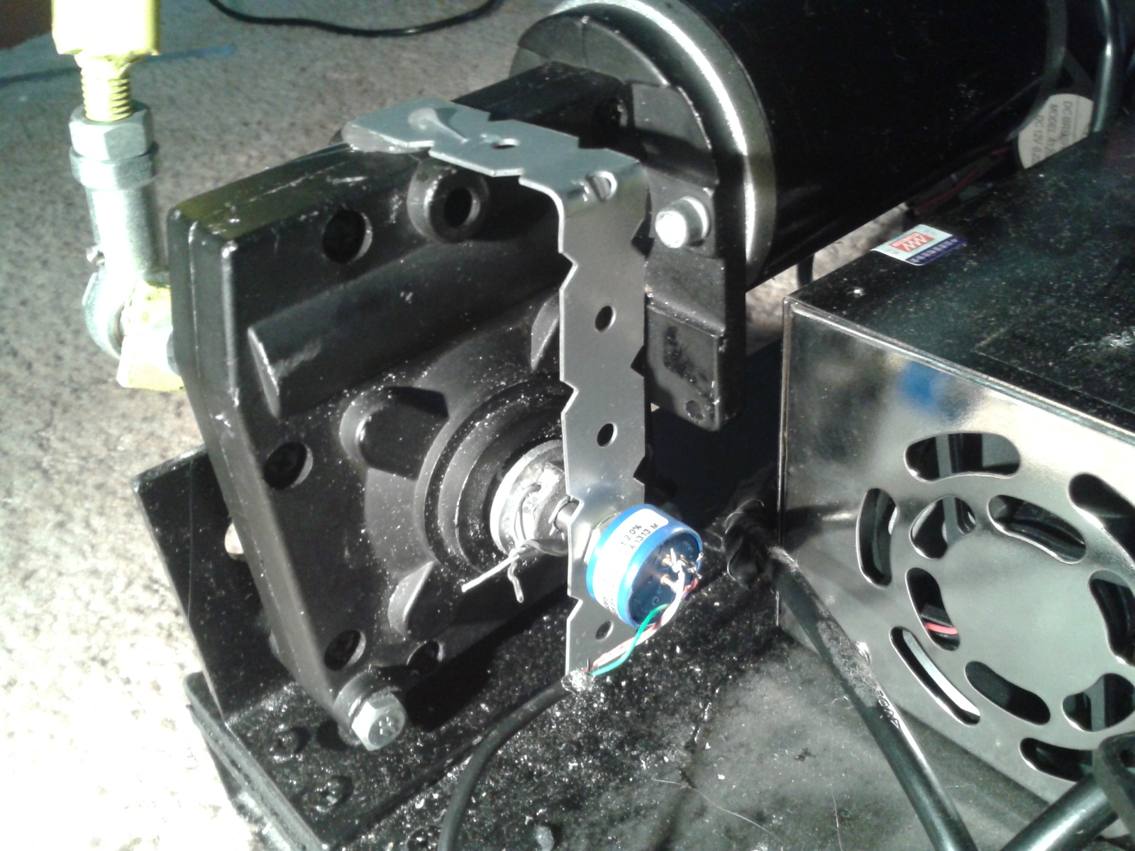

  14. bsft
    Yes, those power supplies are good. I have 2 similar, so does a friend of mine and I think several others. They work well. One power supply per motor for sure.
    As for pots, heres what I use http://au.rs-online.com/web/p/potentiometers/1642661/ , continuous turn and cannot break. Or look for something similar, but be prepared to spend a bit of money.
    For mounting, the popular choice is directly into the back of the motor shaft bolt.
    Drill a hole in the centre to allow the pot shaft to fit in, then a smaller hole, say 2mm through the pot shaft and the bolt, a bit of wire through all that to hold the pot. Mount the pot on a flexible bracket and mount the bracket on the motor housing so it moves with the motor.
    Ask as you need to.
    Cheers, David.
