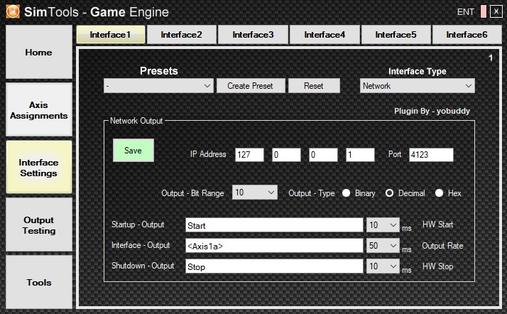

    Simtools version 2.4 Pro license.
    I've tried to setup an interface of type network.
    My axis assignment: (Just to test the interface)
    My interface settings:
    The computer with "Game engine" has IP address: 192.168.1.15
    When using ouput testing>
    I'm not getting any data out on the ethernet on the computer.
    Checking by using Wireshark (running on same computer as "Game engine"):
    What can be the cause?
    BR,
    Bjarte Myklebust

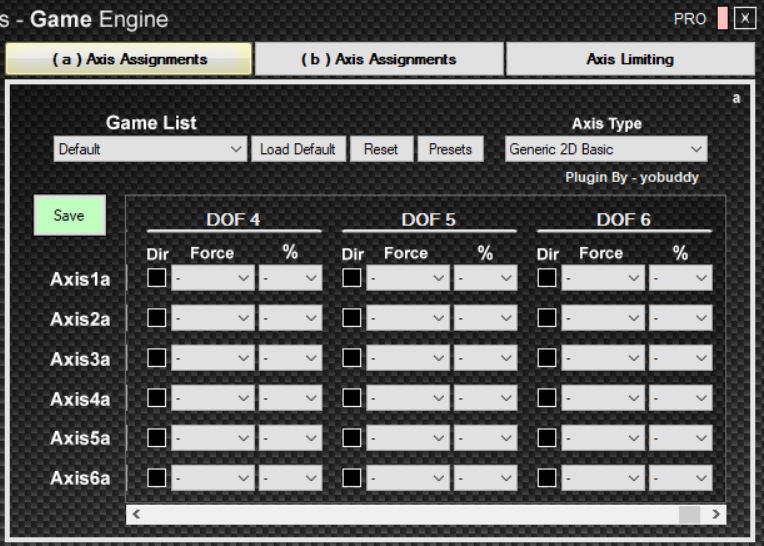

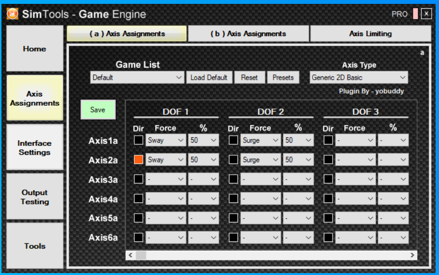

  6. Bjarte Myklebust
    Bjarte Myklebust New Member
    Jul 18, 2019
    25
    48Coins
    +7 / 0 / -0
    Hi yobuddy,
    Here are the picture of my current default axis assignment profile:
    BR,
    Bjarte Myklebust
  7. yobuddy
    5,378
    50,334Coins
    +5,150 / 18 / -0
    Start output testing and move the sway or surge slider.
    Let me know how it goes,

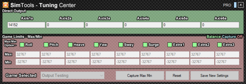

  8. Bjarte Myklebust
    Jul 18, 2019
    25
    48Coins
    +7 / 0 / -0
    Hi yobuddy,
    The values for sway and surge do change (by monitoring tuning center) but not any output on ethernet. The "axis assingment" button and "Interface settings" button turns blue. (As expected).
    When stopping test output, the taxt "centering" is flashing, before it returns to normal operation.
