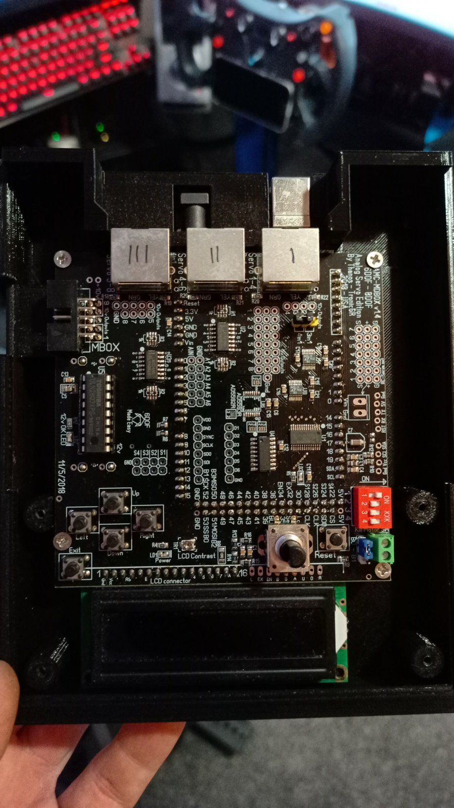

Bug Need to keep restarting Simtools for it to connect and enable motion

    Can you check if the RESET_EN trace is cut?
    Apart from that, can you try on another computer? Or do a clean reinstall of the windows? And select US language for locale language settings...

    Just tried with second interface I have. It detects it differently.
    But the same problem occurs.

    Yes, the bottom board is the same... check the RESET_EN on it... just pull it apart carefully.

    If I might ask what will that do? Can you explain?

    It's already cut. I checked with multimeter.
