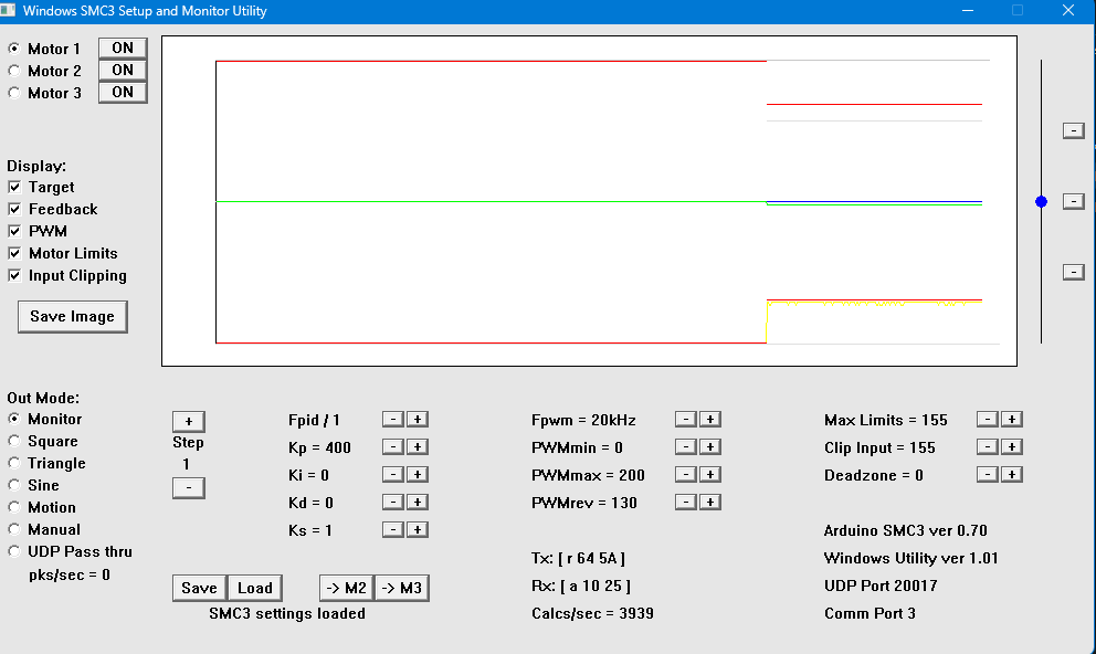

    During the initial setup, I center my sensor exactly in SMC3 Utils and then start the system. The green center line moves toward the upper and lower red lines, and when it touches those upper or lower lines, the motor shuts itself off.
    What is the up-and-down adjustable area on the right side of the monitoring screen in SMC3 Utils?

    These are the values I entered, but when I try it in SimTolls LFS, the motor doesn't move. What could be the reason?

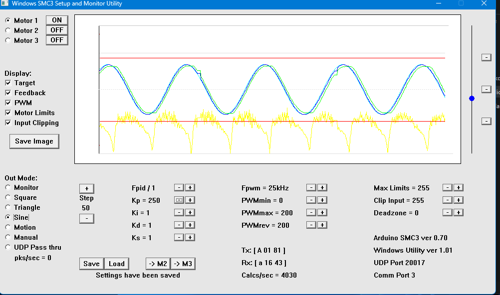

    These are the results I get when I feed in sine wave.
  10. Joe Cortexian
    Sep 8, 2021
    256
    1,537Coins
    +67 / 1 / -0
    That’s exactly the way it should look. I can’t imagine how the motor isn’t running right. Maybe something with the sensor? Could it somehow be the sensor is in a mode lit number of bits of something? I guessed something fixed running in one direction? How did you fix that?
