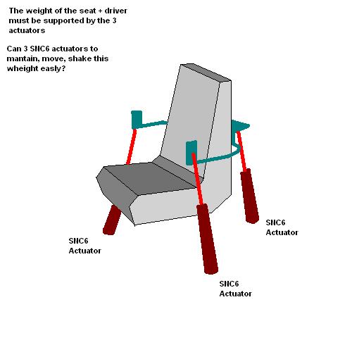

    I am seriously looking for the SX3000 starting pack.
    But there are some things that don't aim perfectly with my objective:the power and the maximum number of handled actuators.
    The SX3000 handle up to 3 SNC5 actuators (12kgf). Sure is good but i am looking for a biggest power.
    So, in the end of september there will be the SX4000. This is a big forward step because it can handle up to 4 SNC6 actuators (44kgf)
    My questions:
    1) I think the 44kfg is the maximum wheight supportable by the actuator, so, 44 kg right?
    one Actuators 44kg*3 = 132 kg. Can this be ok if i think to build a 3actuators platform ?(as the image show to you)
    2) The SX3000 (i think the SX4000 too) can handle ModBus RS485 standard actuators too.
    Ok, So Firgelli actuators follow this standard? And if these Firgelli actuators are compatible with SX3/4000 device, are these actuators fastest as (so and so) the SNC6 actuators (example, the Firgelli 18 Stroke 200 lbs Force Linear Actuator [FA-240-S-12-18] )
    In other words, can i find something like SX3/4000 (a very friendly starting kit) working with more powerful (and i hope fast) acutators?
    What is the best way i have to follow if i would to build a platform as the one showed on the picture?

    If there would be such a starting kit, I'm pretty sure you would know about it.
    I don't see any problems why you couldn't use other RS485 devices with the SX3000/SX4000, but IMO it wouldn't be very practical. You would need a stronger power supply for stronger actuators, possibly 2. You could use the USB-Serial converter that is in it, but everything else would need to be changed. Further more, other actuators might need a completely different plugin to operate, which is not available for you.
    In other words, don't strip apart the Starter Kit, you won't be using much from it in the end.
    You can put one larger spring under the whole seat, or smaller ones for each actuator to eliminate the force of gravity. If the springs are the right weight, the actuators only have to work when they move the platform. Even then you might run into trouble.

    I didn't say the SCN6s will work with a spring. It will greatly depend on the weight and how aggressive the motion profile is.
    No tutorials I know of. Building motion platforms is a very new hobby.

    AldoZ mate i found linear actuators pricy here in australia so i followed the line of the wiper motor then converted it to a 900kg Winch and Im 80kg and i can stand directlty on the moving arm plus simulators weight and it doesnt slow or produce heat, by spec the motor can lift 200kg vertically and pull 900kg horizonally will drawing 20amps, inturn used the Jrk12v12 Motor Controller to drive the winch in x-sim.

    I think Firgelli actuators are too slow, if I remember corectly they move at 1/2 per sec.
    SCN5 can go as fast as 400mm/sec (~15/sec)

    Not only are the Firgelli too slow, I've had conversations with engineers there. The consensus is that they are not designed for this duty cycle and after a short while, would sieze to internal heat build-up.
