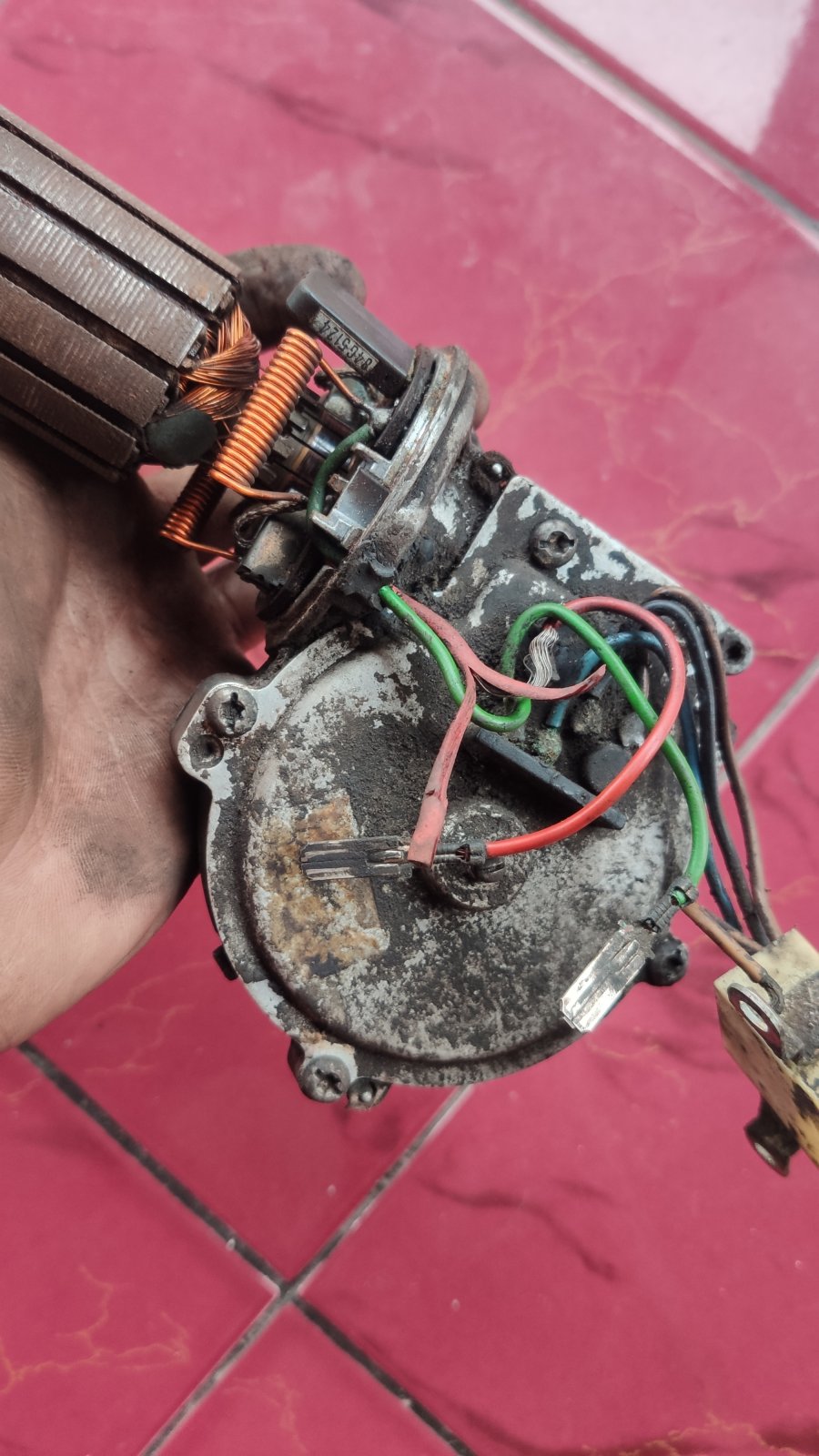

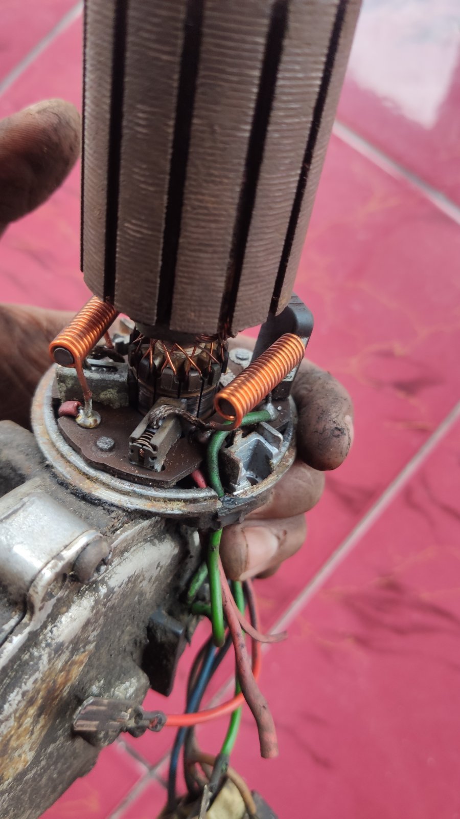

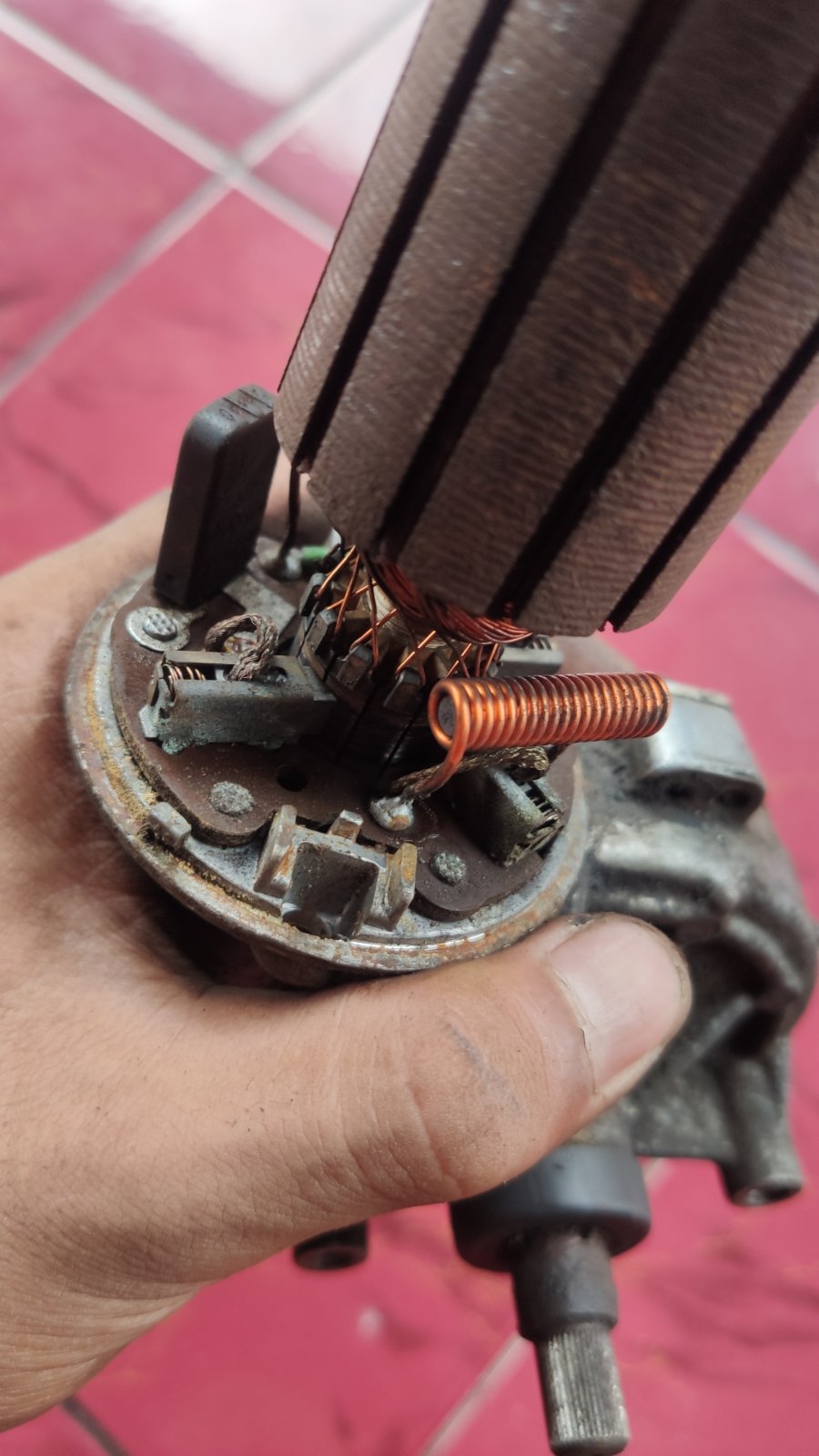

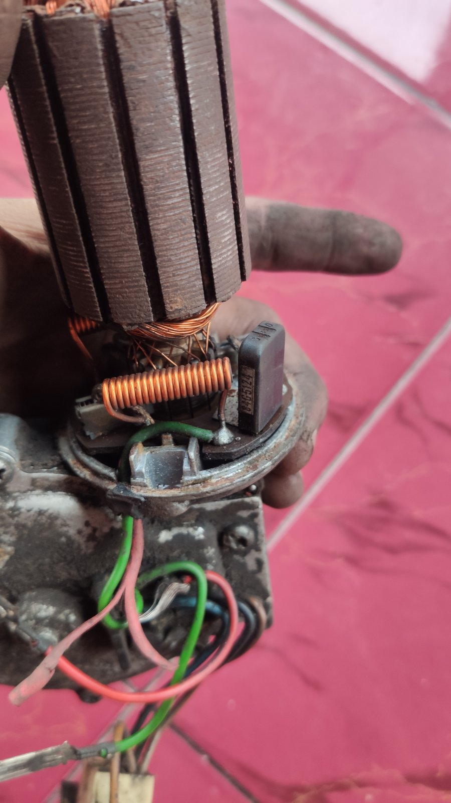

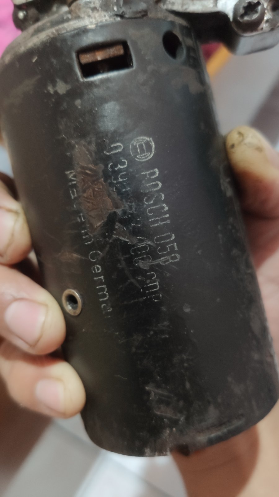

  9. Arta Yasa
    Arta Yasa Member
    Jan 27, 2021
    171
    860Coins
    +14 / 0 / -0
    Hi sir i have wiper motor ex bus, but cannot runing, i check the spul are oke, and carbon brush are oke, but this motor with 3 carbon brush, how to run it sir??
